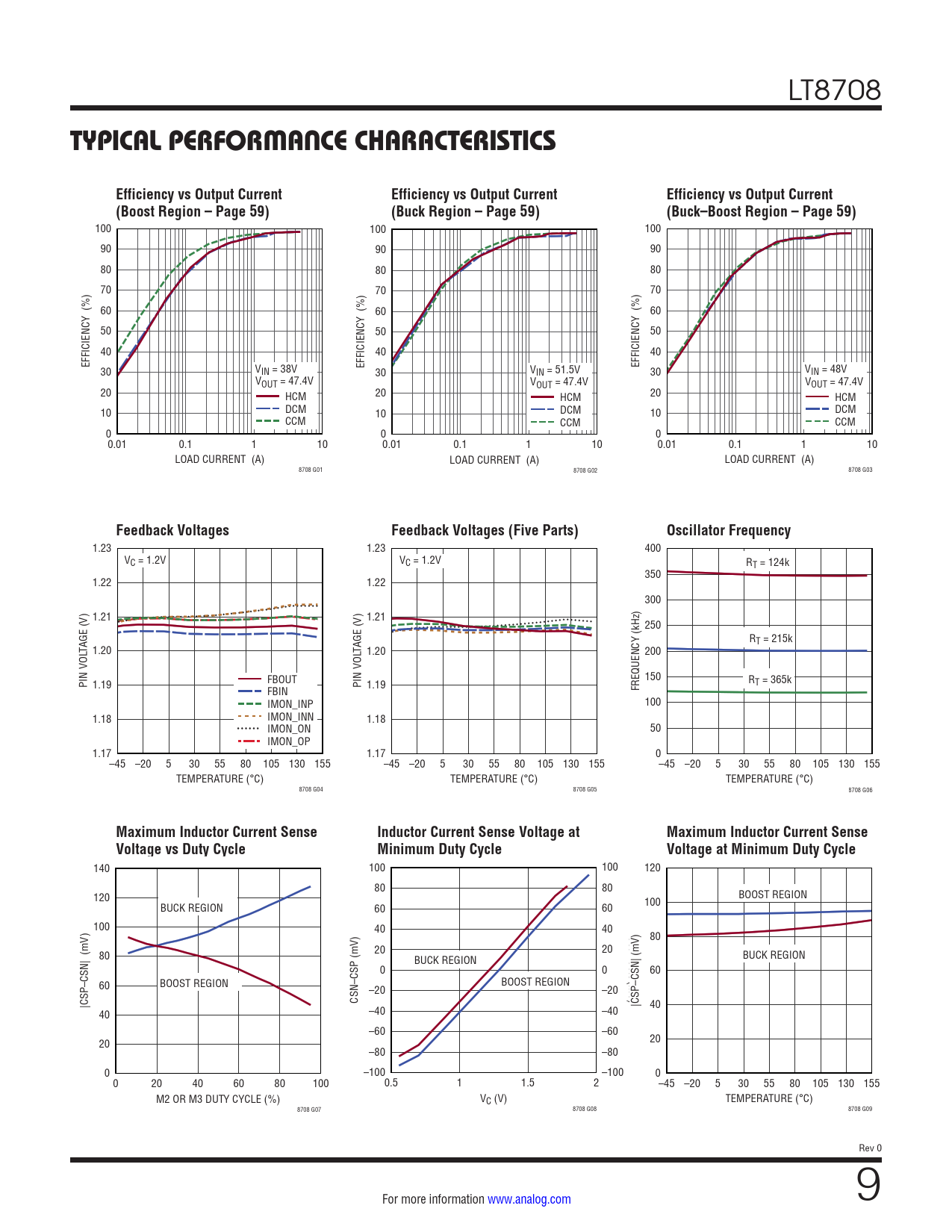

TYPICAL PERFORMANCE CHARACTERISTICS. Efficiency vs Output Current. (Boost Region – Page 59. (Buck Region – Page 59)
link to page 59 link to page 59 link to page 59 LT8708
TYPICAL PERFORMANCE CHARACTERISTICS Efficiency vs Output Current Efficiency vs Output Current Efficiency vs Output Current (Boost Region – Page 59 ) (Buck Region – Page 59) (Buck–Boost Region – Page 59)
100 100 100 90 90 90 80 80 80 70 70 70 60 60 60 50 50 50 40 40 40 EFFICIENCY (%) EFFICIENCY (%) EFFICIENCY (%) 30 VIN = 38V 30 VIN = 51.5V 30 VIN = 48V VOUT = 47.4V VOUT = 47.4V VOUT = 47.4V 20 HCM 20 HCM 20 HCM 10 DCM 10 DCM 10 DCM CCM CCM CCM 0 0 0 0.01 0.1 1 10 0.01 0.1 1 10 0.01 0.1 1 10 LOAD CURRENT (A) LOAD CURRENT (A) LOAD CURRENT (A) 8708 G01 8708 G02 8708 G03
Feedback Voltages Feedback V Feedback Voltages (Five Parts) Oscillator Frequency
1.23 1.23 400 VC = 1.2V VC = 1.2V RT = 124k 350 1.22 1.22 300 1.21 1.21 250 RT = 215k TAGE (V) 1.20 TAGE (V) 1.20 200 FBOUT 150 PIN VOL 1.19 PIN VOL 1.19 RT = 365k FBIN FREQUENCY (kHz) IMON_INP 100 1.18 IMON_INN 1.18 IMON_ON 50 IMON_OP 1.17 1.17 0 –45 –20 5 30 55 80 105 130 155 –45 –20 5 30 55 80 105 130 155 –45 –20 5 30 55 80 105 130 155 TEMPERATURE (°C) TEMPERATURE (°C) TEMPERATURE (°C) 8708 G04 8708 G05 8708 G06
Maximum Inductor Current Sense Inductor Current Sense Voltage at Maximum Inductor Current Sense Voltage vs Duty Cycle Minimum Duty Cycle Voltage at Minimum Duty Cycle V
