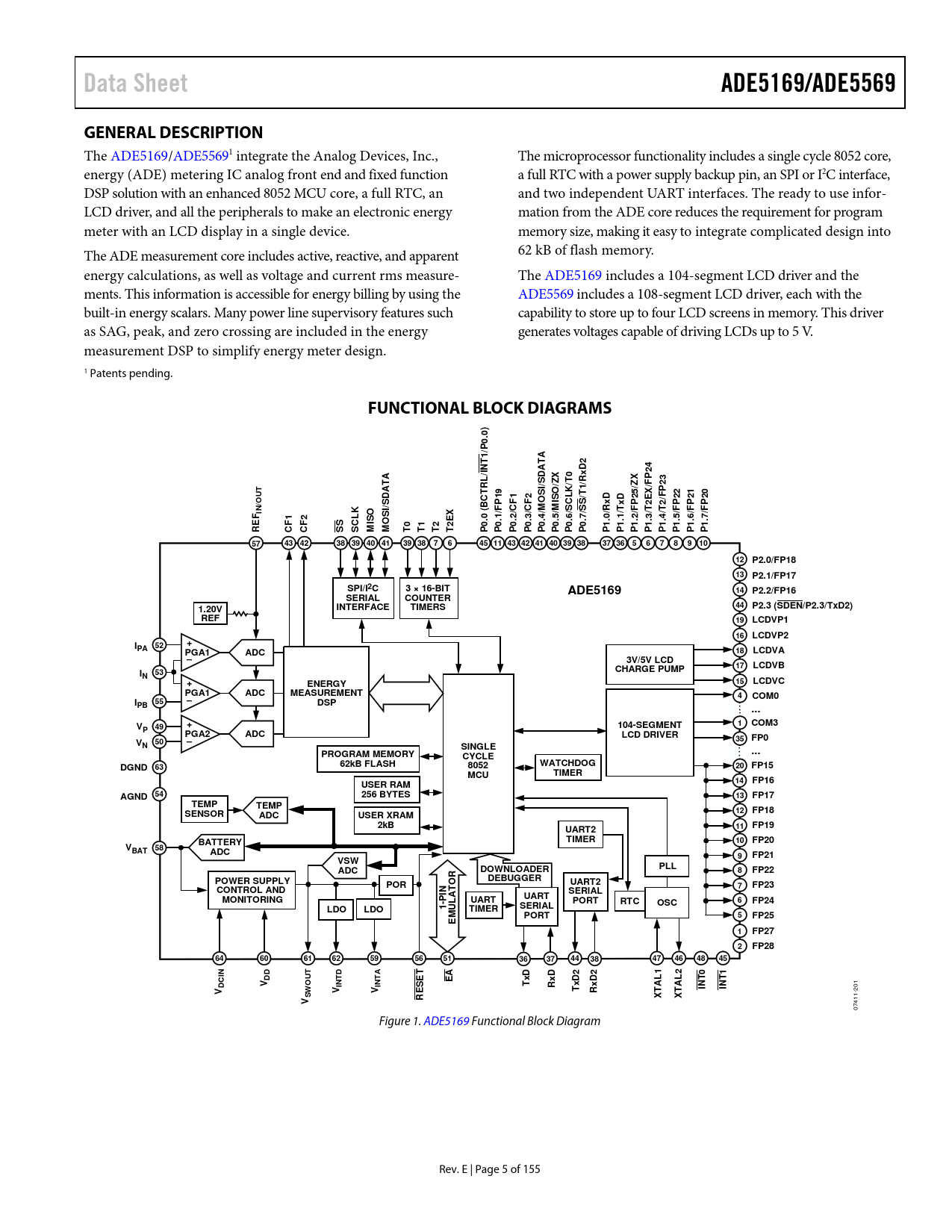

Data Sheet. ADE5169/ADE5569. GENERAL DESCRIPTION. FUNCTIONAL BLOCK DIAGRAMS. ) .0 0 /P 1. IN/. 43 42. 38 39 40 41. 39 38
Data Sheet ADE5169/ADE5569 GENERAL DESCRIPTION FUNCTIONAL BLOCK DIAGRAMS ) .0 0 /P 1 IN/ 43 42 38 39 40 41 39 38
The ADE5169/ADE55691 integrate the Analog Devices, Inc., The microprocessor functionality includes a single cycle 8052 core, energy (ADE) metering IC analog front end and fixed function a full RTC with a power supply backup pin, an SPI or I2C interface, DSP solution with an enhanced 8052 MCU core, a full RTC, an and two independent UART interfaces. The ready to use infor- LCD driver, and all the peripherals to make an electronic energy mation from the ADE core reduces the requirement for program meter with an LCD display in a single device. memory size, making it easy to integrate complicated design into The ADE measurement core includes active, reactive, and apparent 62 kB of flash memory. energy calculations, as well as voltage and current rms measure- The ADE5169 includes a 104-segment LCD driver and the ments. This information is accessible for energy billing by using the ADE5569 includes a 108-segment LCD driver, each with the built-in energy scalars. Many power line supervisory features such capability to store up to four LCD screens in memory. This driver as SAG, peak, and zero crossing are included in the energy generates voltages capable of driving LCDs up to 5 V. measurement DSP to simplify energy meter design. 1 Patents pending.
FUNCTIONAL BLOCK DIAGRAMS ) .0 0 /P 1 A T T 2 A D 4 IN/ 2 D X 0 x A X P 3 T L /S /Z /T /R R /Z /F 2 T A I 1 9 K 5 X P 2 1 0 U T S O D 1 1 2 L /T C D D 2 E /F 2 2 2 /O F F O IS /S P C S x x P 2 2 P P P IN K I (B /F /C /C /M /M /S /S /R /T /F /T /T /F /F /F F X 1 2 L O S .0 .1 .2 .3 .4 .5 .6 .7 .0 .1 .2 .3 .4 .5 .6 .7 E F F E S C IS O 0 1 2 2 0 0 0 0 0 0 0 0 1 1 1 1 1 1 1 1 R C C S S M M T T T T P P P P P P P P P P P P P P P P 57 43 42 38 39 40 41 39 38 7 6 45 11 43 42 41 40 39 38 37 36 5 6 7 8 9 10 12 P2.0/FP18 13 P2.1/FP17 SPI/I2C 3 × 16-BIT ADE5169 14 P2.2/FP16 SERIAL COUNTER 1.20V 44 INTERFACE TIMERS P2.3 (SDEN/P2.3/TxD2) REF 19 LCDVP1 16 LCDVP2 I + PA 52 18 LCDVA PGA1 ADC 3V/5V LCD 17 LCDVB I CHARGE PUMP 53 N + ENERGY 15 LCDVC PGA1 ADC MEASUREMENT 4 COM0 I DSP PB 55 ... ... V + 1 COM3 104-SEGMENT P 49 PGA2 ADC LCD DRIVER 35 FP0 V 50 N SINGLE . PROGRAM MEMORY .. ... CYCLE 62kB FLASH WATCHDOG 63 8052 DGND 20 FP15 MCU TIMER 14 FP16 USER RAM AGND 54 256 BYTES 13 FP17 TEMP TEMP 12 FP18 SENSOR ADC USER XRAM 2kB 11 FP19 UART2 TIMER 10 FP20 BATTERY VBAT 58 ADC 9 FP21 VSW ADC PLL DOWNLOADER 8 FP22 R POWER SUPPLY DEBUGGER O UART2 POR 7 FP23 CONTROL AND IN T SERIAL A MONITORING UART P L UART PORT RTC OSC 6 FP24 LDO 1- SERIAL LDO TIMER PORT 5 FP25 EMU 1 FP27 2 FP28 64 60 61 62 59 56 51 36 37 44 38 47 46 48 45 IN D T D A T D 2 2 1 2 D 0 1 C D U T T E EA x x D D L L T T
