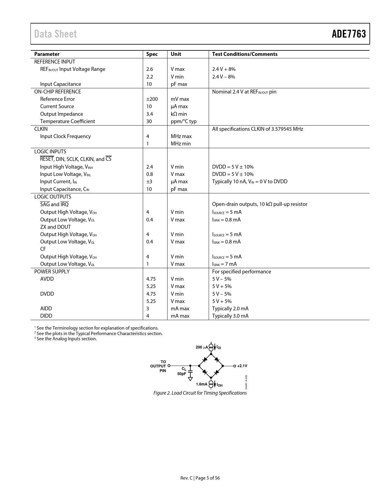

Data Sheet. ADE7763. Parameter. Spec. Unit. Test Conditions/Comments. 200. IOl. OUTPUT. +2.1V. PIN. 50pF. 1.6mA. IOH
Data Sheet ADE7763 Parameter Spec Unit Test Conditions/Comments 200 IOl OUTPUT +2.1V PIN 50pF 1.6mA IOH
link to page 8 link to page 11 link to page 14
REFERENCE INPUT REFIN/OUT Input Voltage Range 2.6 V max 2.4 V + 8% 2.2 V min 2.4 V – 8% Input Capacitance 10 pF max ON-CHIP REFERENCE Nominal 2.4 V at REFIN/OUT pin Reference Error ±200 mV max Current Source 10 µA max Output Impedance 3.4 kΩ min Temperature Coefficient 30 ppm/°C typ CLKIN All specifications CLKIN of 3.579545 MHz Input Clock Frequency 4 MHz max 1 MHz min LOGIC INPUTS RESET, DIN, SCLK, CLKIN, and CS Input High Voltage, VINH 2.4 V min DVDD = 5 V ± 10% Input Low Voltage, VINL 0.8 V max DVDD = 5 V ± 10% Input Current, IIN ±3 µA max Typically 10 nA, VIN = 0 V to DVDD Input Capacitance, CIN 10 pF max LOGIC OUTPUTS SAG and IRQ Open-drain outputs, 10 kΩ pull-up resistor Output High Voltage, VOH 4 V min ISOURCE = 5 mA Output Low Voltage, VOL 0.4 V max ISINK = 0.8 mA ZX and DOUT Output High Voltage, VOH 4 V min ISOURCE = 5 mA Output Low Voltage, VOL 0.4 V max ISINK = 0.8 mA CF Output High Voltage, VOH 4 V min ISOURCE = 5 mA Output Low Voltage, VOL 1 V max ISINK = 7 mA POWER SUPPLY For specified performance AVDD 4.75 V min 5 V – 5% 5.25 V max 5 V + 5% DVDD 4.75 V min 5 V – 5% 5.25 V max 5 V + 5% AIDD 3 mA max Typically 2.0 mA DIDD 4 mA max Typically 3.0 mA 1 See the Terminology section for explanation of specifications. 2 See the plots in the Typical Performance Characteristics section. 3 See the Analog Inputs section.
200
µ
A IOl TO OUTPUT +2.1V CL PIN 50pF 1.6mA IOH
