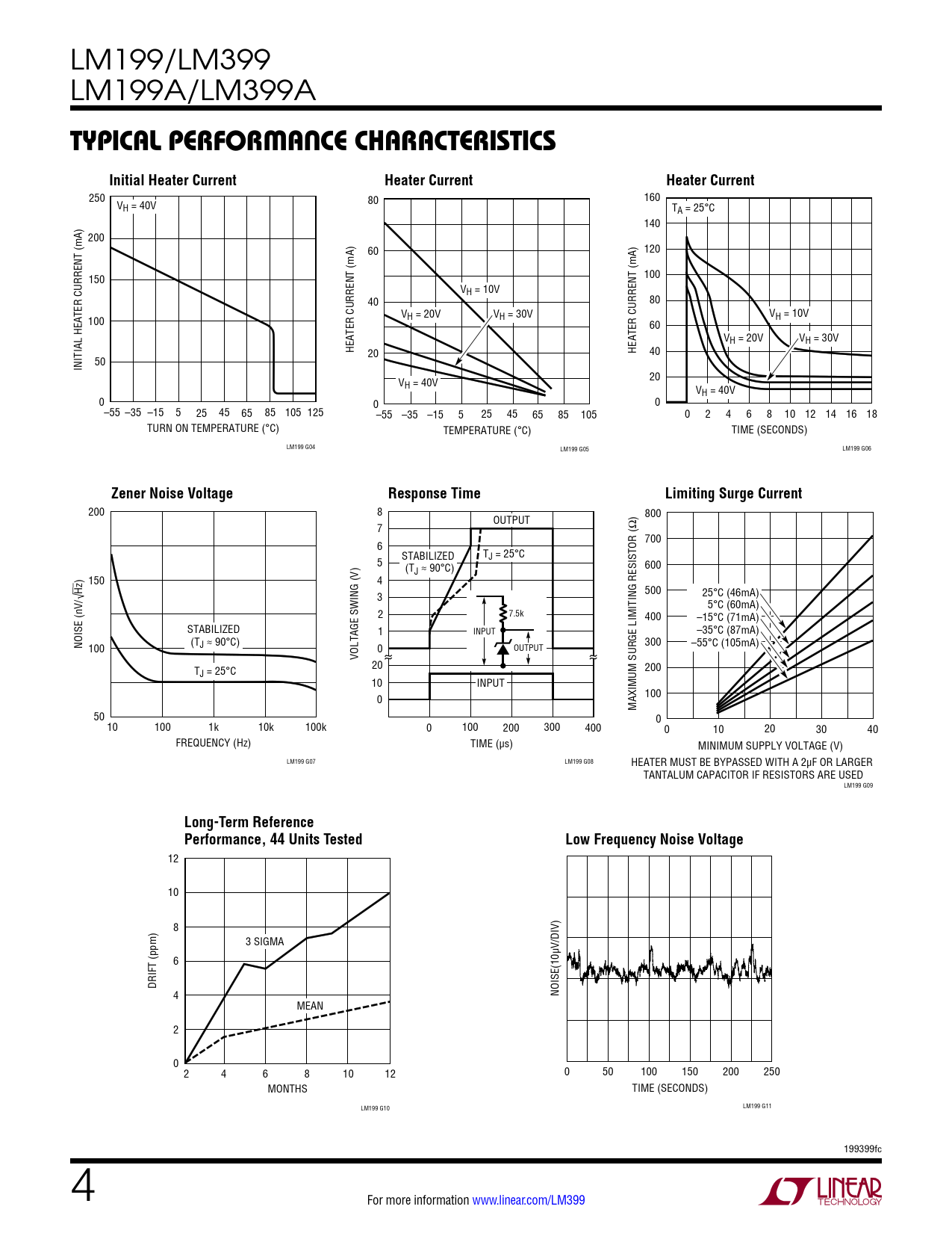

Typical perForMance characTerisTics. Initial Heater Current. Heater Current. Zener Noise Voltage. Response Time
LM199/LM399 LM199A/LM399A
Typical perForMance characTerisTics Initial Heater Current Heater Current Heater Current
250 160 V 80 H = 40V TA = 25°C 140 200 60 120 150 100 VH = 10V 40 80 V V V 100 H = 20V H = 30V H = 10V 60 VH = 20V VH = 30V HEATER CURRENT (mA) 20 HEATER CURRENT (mA) 40 INITIAL HEATER CURRENT (mA) 50 V 20 H = 40V VH = 40V 0 0 0 –55 –35 –15 5 25 45 65 85 105 125 –55 –35 –15 5 25 45 65 85 105 0 2 4 6 8 10 12 14 16 18 TURN ON TEMPERATURE (°C) TEMPERATURE (°C) TIME (SECONDS) LM199 G04 LM199 G05 LM199 G06
Zener Noise Voltage Response Time Limiting Surge Current
200 8 OUTPUT 800 7 700 6 STABILIZED T 5 J = 25°C (T 600 J ≈ 90°C) 150 4 Hz 3 500 25°C (46mA) 5°C (60mA) 2 7.5k 400 –15°C (71mA) STABILIZED 1 INPUT –35°C (87mA) NOISE (nV/√ (T 300 100 J ≈ 90°C) 0 –55°C (105mA) OUTPUT VOLTAGE SWING (V) T 20 200 J = 25°C 10 INPUT 0 100 MAXIMUM SURGE LIMITING RESISTOR (Ω) 50 0 10 100 1k 10k 100k 0 100 200 300 400 0 10 20 30 40 FREQUENCY (Hz) TIME (µs) MINIMUM SUPPLY VOLTAGE (V) LM199 G07 LM199 G08 HEATER MUST BE BYPASSED WITH A 2µF OR LARGER TANTALUM CAPACITOR IF RESISTORS ARE USED LM199 G09
Long-Term Reference Performance, 44 Units Tested Low Frequency Noise Voltage
