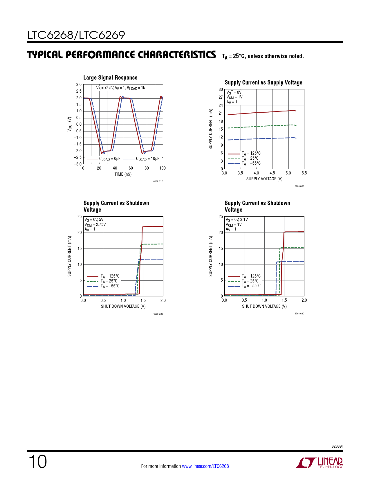

TYPICAL PERFORMANCE CHARACTERISTICS TA = 25°C, unless otherwise noted. Large Signal Response
TYPICAL PERFORMANCE CHARACTERISTICS TA = 25°C, unless otherwise noted Large Signal Response
LTC6268/LTC6269
TYPICAL PERFORMANCE CHARACTERISTICS TA = 25°C, unless otherwise noted. Large Signal Response Supply Current vs Supply Voltage
3.0 VS = ±2.5V, AV = 1, RLOAD = 1k 30 2.5 V – S = 0V 2.0 27 VCM = 1V A 1.5 24 V = 1 1.0 21 0.5 (V) 18 0.0 V OUT 15 –0.5 –1.0 Y CURRENT (mA) 12 –1.5 9 SUPPL –2.0 6 TA = 125°C –2.5 C T LOAD = 0pF CLOAD = 10pF 3 A = 25°C –3.0 TA = –55°C 0 20 40 60 80 100 0 TIME (nS) 3.0 3.5 4.0 4.5 5.0 5.5 SUPPLY VOLTAGE (V) 6268 G27 6268 G28
Supply Current vs Shutdown Supply Current vs Shutdown Voltage Voltage
25 25 VS = 0V, 5V VS = 0V, 3.1V VCM = 2.75V VCM = 1V A A 20 V = 1 20 V = 1 15 15 Y CURRENT (mA) 10 Y CURRENT (mA) 10 SUPPL TA = 125°C SUPPL TA = 125°C 5 TA = 25°C 5 TA = 25°C TA = –55°C TA = –55°C 0 0 0.0 0.5 1.0 1.5 2.0 0.0 0.5 1.0 1.5 2.0 SHUT DOWN VOLTAGE (V) SHUT DOWN VOLTAGE (V) 6268 G29 6268 G30 62689f 10 For more information www.linear.com/LTC6268
