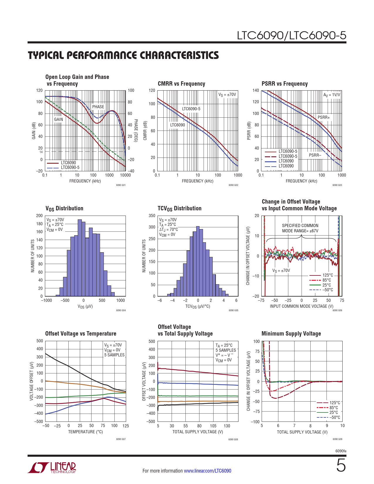

Pages / Page26 / 5 — TYPICAL PERFORMANCE CHARACTERISTICS. Open Loop Gain and Phase. vs …
TYPICAL PERFORMANCE CHARACTERISTICS. Open Loop Gain and Phase. vs Frequency. CMRR vs Frequency. PSRR vs Frequency
TYPICAL PERFORMANCE CHARACTERISTICS Open Loop Gain and Phase vs Frequency CMRR vs Frequency PSRR vs Frequency
LTC6090/LTC6090-5
120 100 120 140 VS = ±70V AV = 1V/V 100 80 100 120 PHASE LTC6090-5 80 60 100 PHASE (DEG) 80 PSRR+ GAIN 60 40 LTC6090 80 60 GAIN (dB) 40 20 CMRR (dB) PSRR (dB) 60 40 20 0 40 14 LTC6090-5 20 LTC6090-5 PSRR– 0 –20 20 LTC6090 LTC6090 LTC6090 LTC6090-5 –20 –40 0 0 0.1 1 10 100 1000 10000 0.1 1 10 100 1000 0.1 1 10 100 1000 FREQUENCY (kHz) FREQUENCY (kHz) FREQUENCY (kHz) 6090 G01 6090 G02 6090 G03
Change in Offset Voltage VOS Distribution TCVOS Distribution vs Input Common Mode Voltage
200 350 20 VS = ±70V VS = ±70V 180 TA = 25°C T 300 A = 25°C SPECIFIED COMMON VCM = 0V ∆TJ = 70°C V) 160 MODE RANGE= ±67V VCM = 0V 10 250 140 TAGE (µ 120 200 100 0 150 80 NUMBER OF UNITS 60 NUMBER OF UNITS V 100 S = ±70V –10 125°C 40 85°C 50 CHANGE IN OFFSET VOL 25°C 20 –50°C 0 0 –20 –1000 –500 0 500 1000 –6 –4 –2 0 2 4 6 –75 –50 –25 0 25 50 75 VOS (µV) TCVOS (µV/°C) INPUT COMMON MODE VOLTAGE (V) 6090 G04 6090 G05 6090 G06
Offset Voltage Offset Voltage vs Temperature vs Total Supply Voltage Minimum Supply Voltage
500 500 100 V T 400 S = ±70V A = 25°C VCM = 0V 400 5 SAMPLES 75 300 5 SAMPLES 300 V+ = – V – VCM = 0V 50 200 200 100 100 25 0 0 0 –100 –100 –25 VOLTAGE OFFSET (µV) –200 OFFSET VOLTAGE (µV) –200 –50 –300 125°C –300 CHANGE IN OFFSET VOLTAGE (µV) 85°C –400 –400 –75 25°C –50°C –500 –500 –100 –50 –25 0 25 50 75 100 125 5 30 55 80 105 130 5 6 7 8 9 10 TEMPERATURE (°C) TOTAL SUPPLY VOLTAGE (V) TOTAL SUPPLY VOLTAGE (V) 6090 G07 6090 G08 6090 G09 6090fe For more information www.linear.com/LTC6090 5 Document Outline Features Applications Typical Application Description Absolute Maximum Ratings Pin Configuration Order Information Electrical Characteristics Typical Performance Characteristics Pin Functions Block Diagram Applications Information Typical Applications Package Description Revision History Typical Application Related Parts
