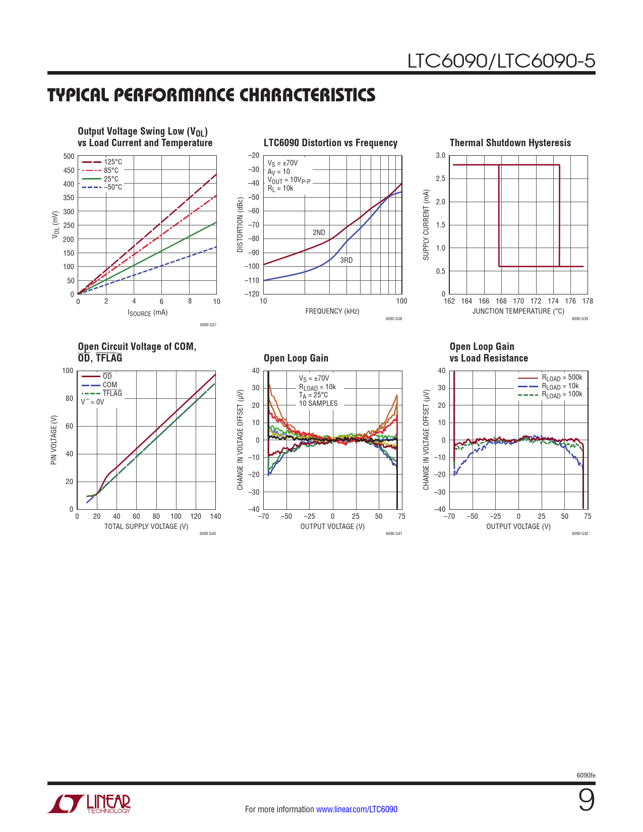

TYPICAL PERFORMANCE CHARACTERISTICS. Output Voltage Swing Low (VOL). vs Load Current and Temperature
LTC6090/LTC6090-5
TYPICAL PERFORMANCE CHARACTERISTICS Output Voltage Swing Low (VOL) vs Load Current and Temperature LTC6090 Distortion vs Frequency Thermal Shutdown Hysteresis
500 –20 3.0 125°C VS = ±70V 450 85°C –30 AV = 10 25°C 2.5 400 VOUT = 10VP-P –50°C –40 RL = 10k 350 –50 2.0 300 –60 (mV) 250 TION (dBc) –70 1.5 V OL 2ND 200 –80 Y CURRENT (mA) 1.0 150 DISTOR –90 3RD SUPPL 100 –100 0.5 50 –110 0 –120 0 0 2 4 6 8 10 10 100 162 164 166 168 170 172 174 176 178 ISOURCE (mA) FREQUENCY (kHz) JUNCTION TEMPERATURE (°C) 6090 G38 6090 G39 6090 G37
Open Circuit Voltage of COM, Open Loop Gain OD, TFLAG Open Loop Gain vs Load Resistance
100 40 40 OD VS = ±70V RLOAD = 500k COM 30 RLOAD = 10k 30 RLOAD = 10k TFLAG V) V) 80 TA = 25°C RLOAD = 100k V– = 0V 20 10 SAMPLES 20 60 10 10 TAGE (V) TAGE OFFSET (µ 0 TAGE OFFSET (µ 0 40 –10 –10 PIN VOL –20 –20 20 CHANGE IN VOL –30 CHANGE IN VOL –30 0 –40 –40 0 20 40 60 80 100 120 140 –70 –50 –25 0 25 50 75 –70 –50 –25 0 25 50 75 TOTAL SUPPLY VOLTAGE (V) OUTPUT VOLTAGE (V) OUTPUT VOLTAGE (V) 6090 G40 6090 G41 6090 G42 6090fe For more information www.linear.com/LTC6090 9 Document Outline Features Applications Typical Application Description Absolute Maximum Ratings Pin Configuration Order Information Electrical Characteristics Typical Performance Characteristics Pin Functions Block Diagram Applications Information Typical Applications Package Description Revision History Typical Application Related Parts
