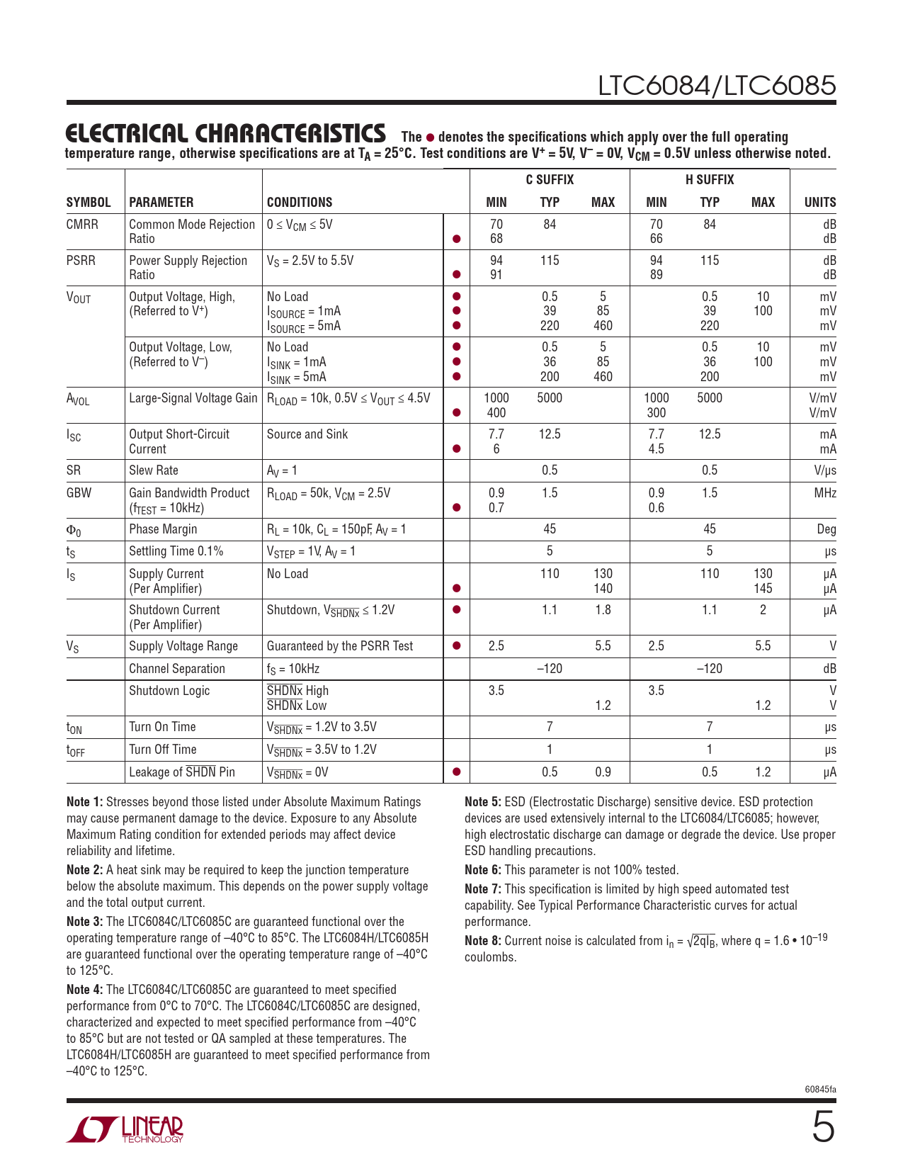

The. ELECTRICAL CHARACTERISTICS. denotes the specifi cations which apply over the full operating
The ELECTRICAL CHARACTERISTICS denotes the specifi cations which apply over the full operating
LTC6084/LTC6085
l
denotes the specifi cations which apply over the full operating temperature range, otherwise specifi cations are at TA = 25°C. Test conditions are V+ = 5V, V– = 0V, VCM = 0.5V unless otherwise noted. C SUFFIX H SUFFIX SYMBOL PARAMETER CONDITIONS MIN TYP MAX MIN TYP MAX UNITS
CMRR Common Mode Rejection 0 ≤ VCM ≤ 5V 70 84 70 84 dB Ratio l 68 66 dB PSRR Power Supply Rejection VS = 2.5V to 5.5V 94 115 94 115 dB Ratio l 91 89 dB VOUT Output Voltage, High, No Load l 0.5 5 0.5 10 mV (Referred to V+) ISOURCE = 1mA l 39 85 39 100 mV ISOURCE = 5mA l 220 460 220 mV Output Voltage, Low, No Load l 0.5 5 0.5 10 mV (Referred to V–) ISINK = 1mA l 36 85 36 100 mV ISINK = 5mA l 200 460 200 mV AVOL Large-Signal Voltage Gain RLOAD = 10k, 0.5V ≤ VOUT ≤ 4.5V 1000 5000 1000 5000 V/mV l 400 300 V/mV ISC Output Short-Circuit Source and Sink 7.7 12.5 7.7 12.5 mA Current l 6 4.5 mA SR Slew Rate AV = 1 0.5 0.5 V/μs GBW Gain Bandwidth Product RLOAD = 50k, VCM = 2.5V 0.9 1.5 0.9 1.5 MHz (fTEST = 10kHz) l 0.7 0.6 Φ0 Phase Margin RL = 10k, CL = 150pF, AV = 1 45 45 Deg tS Settling Time 0.1% VSTEP = 1V, AV = 1 5 5 μs IS Supply Current No Load 110 130 110 130 μA (Per Amplifi er) l 140 145 μA Shutdown Current Shutdown, VSHDNx ≤ 1.2V l 1.1 1.8 1.1 2 μA (Per Amplifi er) VS Supply Voltage Range Guaranteed by the PSRR Test l 2.5 5.5 2.5 5.5 V Channel Separation fS = 10kHz –120 –120 dB Shutdown Logic SHDNx High 3.5 3.5 V SHDNx Low 1.2 1.2 V tON Turn On Time VSHDNx = 1.2V to 3.5V 7 7 μs tOFF Turn Off Time VSHDNx = 3.5V to 1.2V 1 1 μs Leakage of SHDN Pin VSHDNx = 0V l 0.5 0.9 0.5 1.2 μA
Note 1:
Note 5:
ESD (Electrostatic Discharge) sensitive device. ESD protection may cause permanent damage to the device. Exposure to any Absolute devices are used extensively internal to the LTC6084/LTC6085; however, Maximum Rating condition for extended periods may affect device high electrostatic discharge can damage or degrade the device. Use proper reliability and lifetime. ESD handling precautions.
Note 2:
A heat sink may be required to keep the junction temperature
Note 6:
This parameter is not 100% tested. below the absolute maximum. This depends on the power supply voltage
Note 7:
This specifi cation is limited by high speed automated test and the total output current. capability. See Typical Performance Characteristic curves for actual
Note 3:
The LTC6084C/LTC6085C are guaranteed functional over the performance. operating temperature range of –40°C to 85°C. The LTC6084H/LTC6085H
Note 8:
Current noise is calculated from in = √2qIB, where q = 1.6 • 10–19 are guaranteed functional over the operating temperature range of –40°C coulombs. to 125°C.
Note 4:
The LTC6084C/LTC6085C are guaranteed to meet specifi ed performance from 0°C to 70°C. The LTC6084C/LTC6085C are designed, characterized and expected to meet specifi ed performance from –40°C to 85°C but are not tested or QA sampled at these temperatures. The LTC6084H/LTC6085H are guaranteed to meet specifi ed performance from –40°C to 125°C. 60845fa 5
