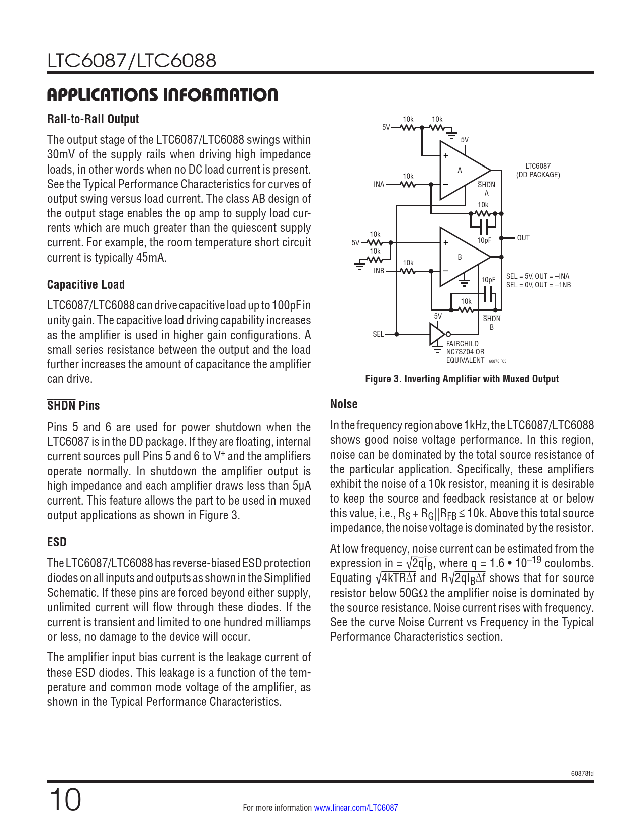

10k 10k 5V The output stage of the LTC6087/LTC6088 swings within 5V 30mV of the supply rails when driving high impedance + loads, in other words when no DC load current is present. LTC6087 A (DD PACKAGE) See the Typical Performance Characteristics for curves of 10k INA – SHDN output swing versus load current. The class AB design of A 10k the output stage enables the op amp to supply load cur- rents which are much greater than the quiescent supply 10k current. For example, the room temperature short circuit 10pF OUT 5V + current is typically 45mA. 10k B 10k INB –
Capacitive Load
10pF SEL = 5V, OUT = –INA SEL = 0V, OUT = –1NB LTC6087/LTC6088 can drive capacitive load up to 100pF in 10k unity gain. The capacitive load driving capability increases 5V SHDN as the amplifier is used in higher gain configurations. A B SEL small series resistance between the output and the load FAIRCHILD NC7SZ04 OR further increases the amount of capacitance the amplifier EQUIVALENT 60878 F03 can drive.
Figure 3. Inverting Amplifier with Muxed Output SHDN Pins Noise
Pins 5 and 6 are used for power shutdown when the In the frequency region above 1kHz, the LTC6087/LTC6088 LTC6087 is in the DD package. If they are floating, internal shows good noise voltage performance. In this region, current sources pull Pins 5 and 6 to V+ and the amplifiers noise can be dominated by the total source resistance of operate normally. In shutdown the amplifier output is the particular application. Specifically, these amplifiers high impedance and each amplifier draws less than 5µA exhibit the noise of a 10k resistor, meaning it is desirable current. This feature allows the part to be used in muxed to keep the source and feedback resistance at or below output applications as shown in Figure 3. this value, i.e., RS + RG||RFB ≤ 10k. Above this total source impedance, the noise voltage is dominated by the resistor.
