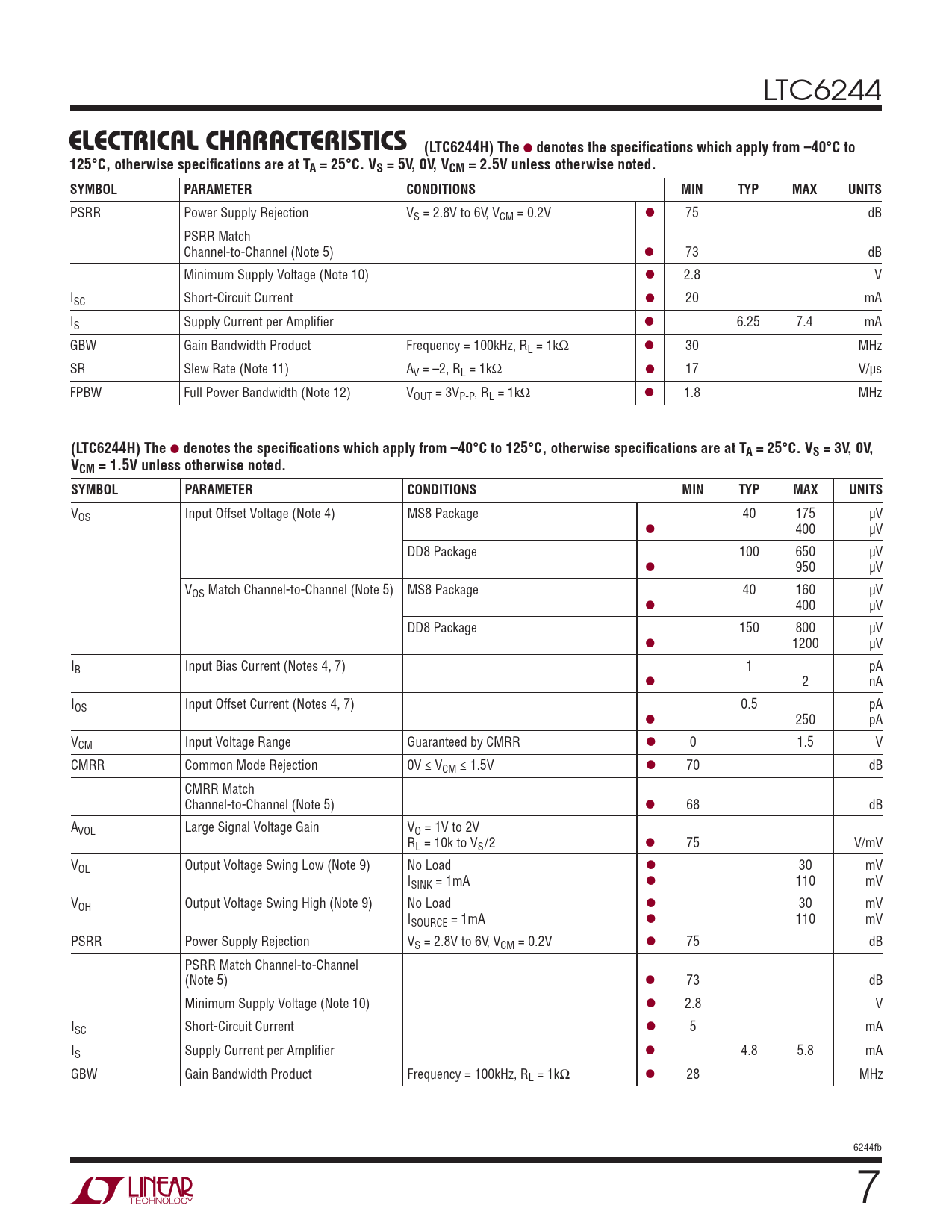

ELECTRICAL CHARACTERISTICS. TC6244H). The. denotes the specifi cations which apply from –40°C to
ELECTRICAL CHARACTERISTICS TC6244H) The denotes the specifi cations which apply from –40°C to
LTC6244
(L ELECTRICAL CHARACTERISTICS TC6244H) The
l
denotes the specifi cations which apply from –40°C to 125°C, otherwise specifi cations are at TA = 25°C. VS = 5V, 0V, VCM = 2.5V unless otherwise noted. SYMBOL PARAMETER CONDITIONS MIN TYP MAX UNITS
PSRR Power Supply Rejection VS = 2.8V to 6V, VCM = 0.2V l 75 dB PSRR Match Channel-to-Channel (Note 5) l 73 dB Minimum Supply Voltage (Note 10) l 2.8 V ISC Short-Circuit Current l 20 mA IS Supply Current per Amplifi er l 6.25 7.4 mA GBW Gain Bandwidth Product Frequency = 100kHz, RL = 1kΩ l 30 MHz SR Slew Rate (Note 11) AV = –2, RL = 1kΩ l 17 V/μs FPBW Full Power Bandwidth (Note 12) VOUT = 3VP-P, RL = 1kΩ l 1.8 MHz
(LTC6244H) The
l
denotes the specifi cations which apply from –40°C to 125°C, otherwise specifi cations are at TA = 25°C. VS = 3V, 0V, VCM = 1.5V unless otherwise noted. SYMBOL PARAMETER CONDITIONS MIN TYP MAX UNITS
VOS Input Offset Voltage (Note 4) MS8 Package 40 175 μV l 400 μV DD8 Package 100 650 μV l 950 μV VOS Match Channel-to-Channel (Note 5) MS8 Package 40 160 μV l 400 μV DD8 Package 150 800 μV l 1200 μV IB Input Bias Current (Notes 4, 7) 1 pA l 2 nA IOS Input Offset Current (Notes 4, 7) 0.5 pA l 250 pA VCM Input Voltage Range Guaranteed by CMRR l 0 1.5 V CMRR Common Mode Rejection 0V ≤ VCM ≤ 1.5V l 70 dB CMRR Match Channel-to-Channel (Note 5) l 68 dB AVOL Large Signal Voltage Gain VO = 1V to 2V RL = 10k to VS/2 l 75 V/mV VOL Output Voltage Swing Low (Note 9) No Load l 30 mV ISINK = 1mA l 110 mV VOH Output Voltage Swing High (Note 9) No Load l 30 mV ISOURCE = 1mA l 110 mV PSRR Power Supply Rejection VS = 2.8V to 6V, VCM = 0.2V l 75 dB PSRR Match Channel-to-Channel (Note 5) l 73 dB Minimum Supply Voltage (Note 10) l 2.8 V ISC Short-Circuit Current l 5 mA IS Supply Current per Amplifi er l 4.8 5.8 mA GBW Gain Bandwidth Product Frequency = 100kHz, RL = 1kΩ l 28 MHz 6244fb 7
