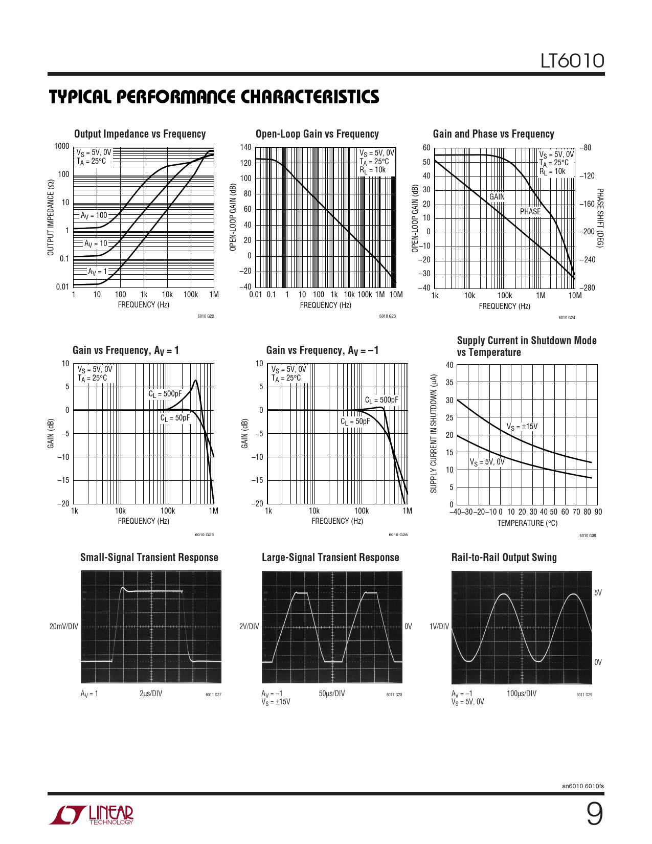

TYPICAL PERFOR A CE CHARACTERISTICS. Output Impedance vs Frequency. Open-Loop Gain vs Frequency. Gain and Phase vs Frequency
LT6010
W U TYPICAL PERFOR A CE CHARACTERISTICS Output Impedance vs Frequency Open-Loop Gain vs Frequency Gain and Phase vs Frequency
1000 140 60 –80 VS = 5V, 0V VS = 5V, 0V VS = 5V, 0V TA = 25°C 120 TA = 25°C 50 TA = 25°C R 100 L = 10k RL = 10k ) 100 40 –120 Ω PHASE SHIFT (DEG) 30 80 GAIN 10 20 –160 60 PHASE AV = 100 10 40 1 0 –200 A 20 V = 10 OPEN-LOOP GAIN (dB) –10 OUTPUT IMPEDANCE ( OPEN-LOOP GAIN (dB) 0.1 0 – 20 – 240 AV = 1 –20 –30 0.01 –40 – 40 –280 1 10 100 1k 10k 100k 1M 0.01 0.1 1 10 100 1k 10k 100k 1M 10M 1k 10k 100k 1M 10M FREQUENCY (Hz) FREQUENCY (Hz) FREQUENCY (Hz) 6010 G22 6010 G23 6010 G24
Supply Current in Shutdown Mode Gain vs Frequency, AV = 1 Gain vs Frequency, AV = –1 vs Temperature
10 10 40 VS = 5V, 0V VS = 5V, 0V TA = 25°C TA = 25°C µA) 35 5 5 CL = 500pF CL = 500pF 30 0 0 CL = 50pF 25 CL = 50pF VS = ±15V –5 –5 20 GAIN (dB) GAIN (dB) 15 –10 –10 VS = 5V, 0V 10 –15 –15 SUPPLY CURRENT IN SHUTDOWN ( 5 –20 –20 0 1k 10k 100k 1M 1k 10k 100k 1M –40–30 –20–10 0 10 20 30 40 50 60 70 80 90 FREQUENCY (Hz) FREQUENCY (Hz) TEMPERATURE (°C) 6010 G25 6010 G26 6010 G30
Small-Signal Transient Response Large-Signal Transient Response Rail-to-Rail Output Swing
5V 20mV/DIV 2V/DIV 0V 1V/DIV 0V AV = 1 2µs/DIV 6011 G27 AV = –1 50µs/DIV 6011 G28 AV = –1 100µs/DIV 6011 G29 VS = ±15V VS = 5V, 0V sn6010 6010fs 9
