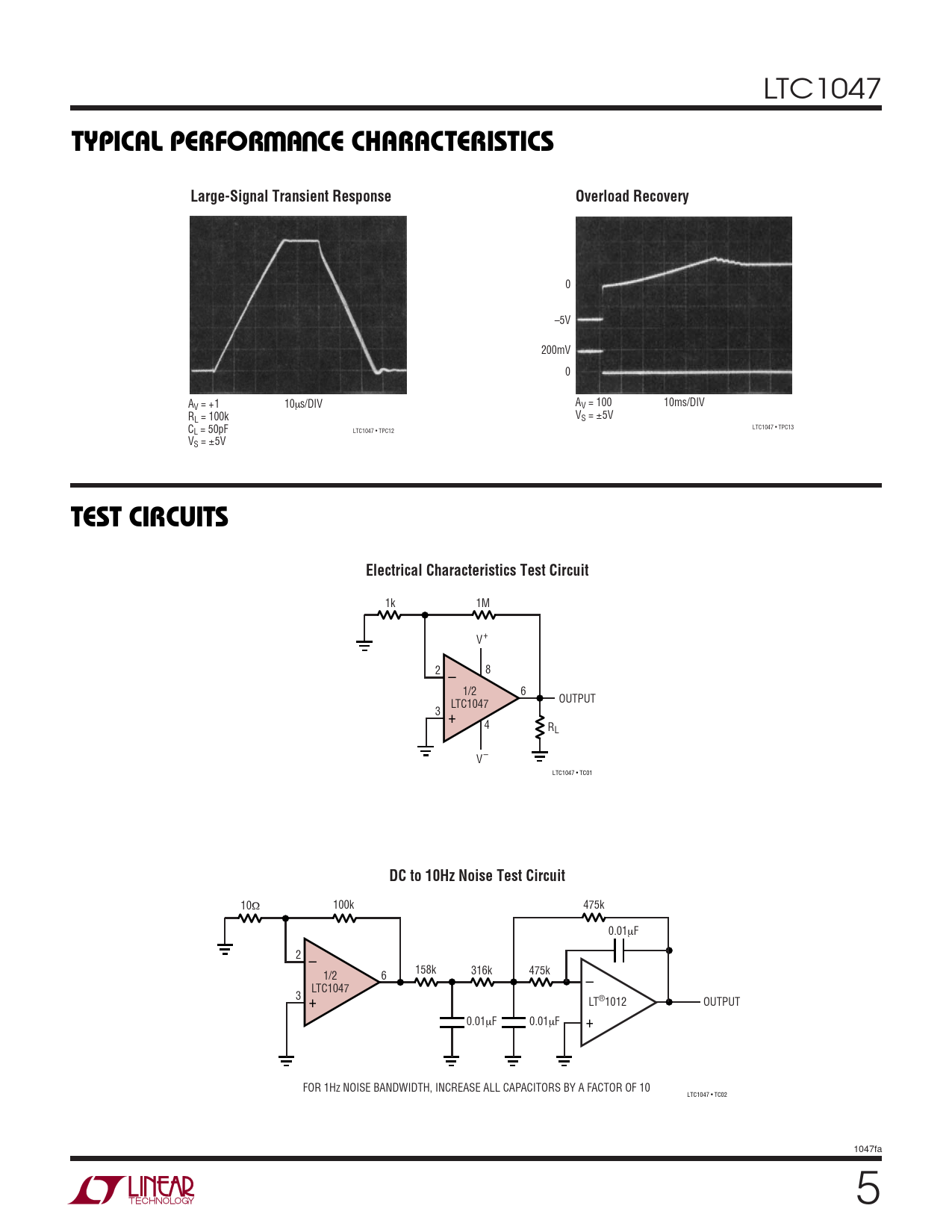

TYPICAL PERFOR A CE CHARACTERISTICS. Large-Signal Transient Response. Overload Recovery. Photo. TEST CIRCUITS
TYPICAL PERFOR A CE CHARACTERISTICS Large-Signal Transient Response Overload Recovery Photo TEST CIRCUITS
LTC1047
W U TYPICAL PERFOR A CE CHARACTERISTICS Large-Signal Transient Response Overload Recovery
0
–5V 200mV 0 A 10 A V = +1 µs/DIV 10ms/DIV V = 100 R V L = 100k S = ±5V LTC1047 • TPC13 C LTC1047 • TPC12 L = 50pF VS = ±5V
TEST CIRCUITS Electrical Characteristics Test Circuit
1k 1M V+ 2 8 – 1/2 6 OUTPUT LTC1047 3 + 4 RL V – LTC1047 • TC01
DC to 10Hz Noise Test Circuit
10Ω 100k 475k 0.01µF 2 – 158k 316k 475k 1/2 6 – LTC1047 3 + LT®1012 OUTPUT 0.01µF 0.01µF + FOR 1Hz NOISE BANDWIDTH, INCREASE ALL CAPACITORS BY A FACTOR OF 10 LTC1047 • TC02 1047fa 5
