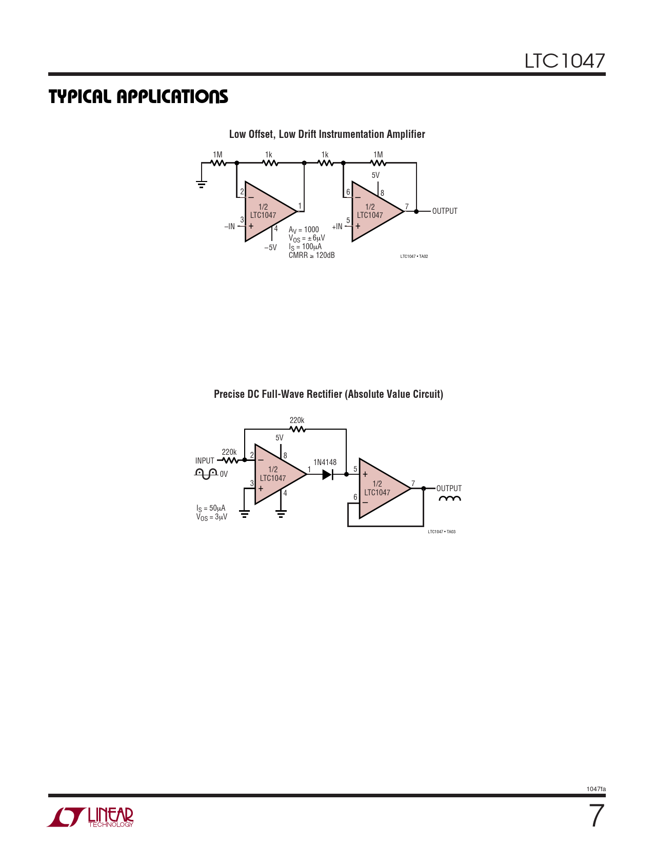

TYPICAL APPLICATIO S. Low Offset, Low Drift Instrumentation Amplifier
LTC1047
U TYPICAL APPLICATIO S Low Offset, Low Drift Instrumentation Amplifier
1M 1k 1k 1M 5V 2 6 8 – – 1/2 1 1/2 7 OUTPUT LTC1047 LTC1047 3 5 –IN + + A +IN 4 V = 1000 VOS = ± 6µV –5V IS = 100µA CMRR ≥ 120dB LTC1047 • TA02
Precise DC Full-Wave Rectifier (Absolute Value Circuit)
220k 5V 220k 2 8 INPUT – 1N4148 1/2 1 5 0V + LTC1047 3 1/2 7 + OUTPUT 4 LTC1047 6 – IS = 50µA VOS = 3µV LTC1047 • TA03 1047fa 7
