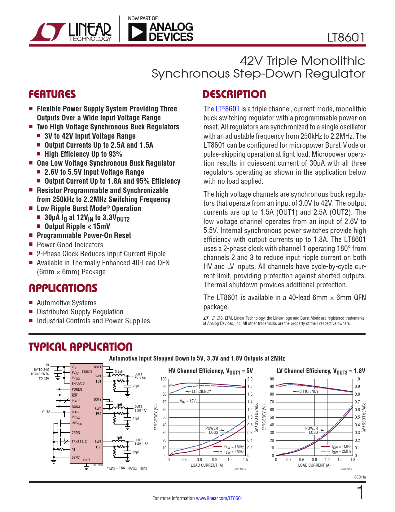

Typical applicaTion Automotive Input Stepped Down to 5V, 3.3V and 1.8V Outputs at 2MHz
IN VIN BST1 6V TO 24V, PV LT8601 3.3μH IN1
HV Channel Efficiency, V
TRANSIENTS OUT1
OUT1 = 5V LV Channel Efficiency, VOUT3 = 1.8V
SW1 TO 42V PVIN2 5V, 1.5A 100 2.0 100 1.0 EN/UVLO FB1 22μF 90 1.8 90 0.9 POREN EFFICIENCY EFFICIENCY RST 80 1.6 80 0.8 3 BST2 PG1-3 70 VIN = 12V 1.4 POWER LOSS (W) 70 0.7 POWER LOSS (W) RUN3 1μH OUT2 SW2 3.3V, 1A* OUT2 60 1.2 60 0.6 BIAS FB2 PVIN3 47μF 50 1.0 50 0.5 INTVCC 40 0.8 40 0.4 EFFICIENCY (%) POWER EFFICIENCY (%) POWER CPOR 30 LOSS 0.6 30 LOSS 0.3 2 1μH OUT3 TRKSS1, 2 SW3 20 0.4 20 0.2 1.8V, 1.8A FB3 f f RT 10 SW = 1MHz 0.2 10 SW = 1MHz 0.1 22μF fSW = 2MHz fSW = 2MHz SYNC 0 0 0 0 GND 0 0.3 0.6 0.9 1.2 1.5 0 0.3 0.6 0.9 1.2 1.5 1.8 8601 TA01a LOAD CURRENT (A) LOAD CURRENT (A) *IMAX = 2.5A – IPVIN3 – IBIAS 8601 TA01b 8601 TA01c 8601fa For more information www.linear.com/LT8601 1 Document Outline Features Applications Typical Application Description Absolute Maximum Ratings Order Information Pin Configuration Electrical Characteristics Typical Performance Characteristics Pin Functions Block Diagram Operation Applications Information Typical Applications Package Description Revision History Typical Application Related Parts
