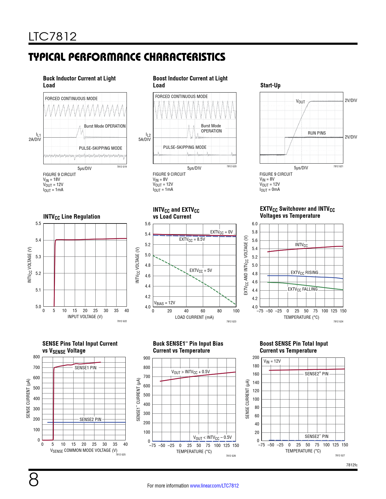

TYPICAL PERFORMANCE CHARACTERISTICS. Buck Inductor Current at Light. Boost Inductor Current at Light. Load. Start-Up
TYPICAL PERFORMANCE CHARACTERISTICS Buck Inductor Current at Light Boost Inductor Current at Light Load Start-Up
LTC7812
TYPICAL PERFORMANCE CHARACTERISTICS Buck Inductor Current at Light Boost Inductor Current at Light Load Load Start-Up
FORCED CONTINUOUS MODE FORCED CONTINUOUS MODE V 2V/DIV OUT Burst Mode OPERATION Burst Mode OPERATION I RUN PINS L1 IL2 2A/DIV 5A/DIV 2V/DIV PULSE-SKIPPING MODE PULSE-SKIPPING MODE 5µs/DIV 7812 G19 5µs/DIV 7812 G20 5µs/DIV 7812 G21 FIGURE 9 CIRCUIT FIGURE 9 CIRCUIT FIGURE 9 CIRCUIT VIN = 18V VIN = 8V VIN = 8V VOUT = 12V VOUT = 12V VOUT = 12V IOUT = 1mA IOUT = 1mA IOUT = 0mA
INTVCC and EXTVCC EXTVCC Switchover and INTVCC INTVCC Line Regulation vs Load Current Voltages vs Temperature
5.5 5.6 6.0 5.4 EXTVCC = 0V 5.8 5.4 EXTVCC = 8.5V 5.6 5.2 INTVCC TAGE (V) 5.4 5.3 5.0 VOL 5.2 TAGE (V) TAGE (V) 4.8 V CC 5.0 VOL VOL EXTVCC = 5V EXTV V CC 5.2 V CC 4.6 4.8 CC RISING INT INT AND INT 4.6 4.4 V CC 5.1 4.4 EXTVCC FALLING EXT 4.2 4.2 V 5.0 BIAS = 12V 4.0 4.0 0 5 10 15 20 25 30 35 40 0 20 40 60 80 100 –75 –50 –25 0 25 50 75 100 125 150 INPUT VOLTAGE (V) LOAD CURRENT (mA) TEMPERATURE (°C) 7812 G22 7812 G23 7812 G24
SENSE Pins Total Input Current Buck SENSE1– Pin Input Bias Boost SENSE Pin Total Input vs VSENSE Voltage Current vs Temperature Current vs Temperature
