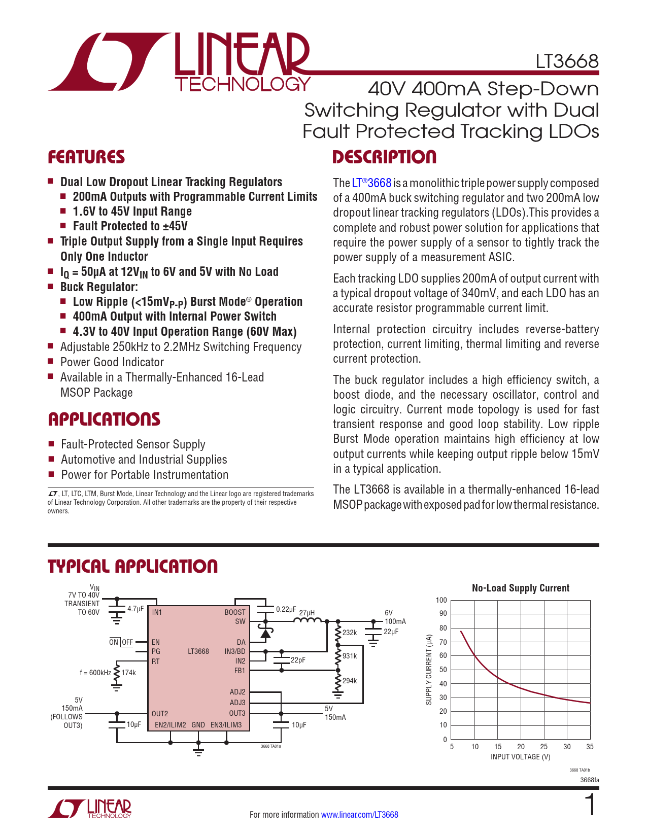

LT3668 40V 400mA Step-Down Switching Regulator with Dual Fault Protected Tracking LDOs
FEATURES DESCRIPTION
n
Dual Low Dropout Linear Tracking Regulators
The LT®3668 is a monolithic triple power supply composed n
200mA Outputs with Programmable Current Limits
of a 400mA buck switching regulator and two 200mA low n
1.6V to 45V Input Range
dropout linear tracking regulators (LDOs).This provides a n
Fault Protected to ±45V
complete and robust power solution for applications that n
Triple Output Supply from a Single Input Requires
require the power supply of a sensor to tightly track the
Only One Inductor
power supply of a measurement ASIC. n
IQ = 50μA at 12VIN to 6V and 5V with No Load
Each tracking LDO supplies 200mA of output current with n
Buck Regulator:
a typical dropout voltage of 340mV, and each LDO has an n
Low Ripple (<15mVP-P) Burst Mode
Operation
accurate resistor programmable current limit. n
400mA Output with Internal Power Switch
n
4.3V to 40V Input Operation Range (60V Max)
Internal protection circuitry includes reverse-battery n Adjustable 250kHz to 2.2MHz Switching Frequency protection, current limiting, thermal limiting and reverse n current protection. Power Good Indicator n Available in a Thermally-Enhanced 16-Lead The buck regulator includes a high efficiency switch, a MSOP Package boost diode, and the necessary oscillator, control and logic circuitry. Current mode topology is used for fast

VIN
No-Load Supply Current
