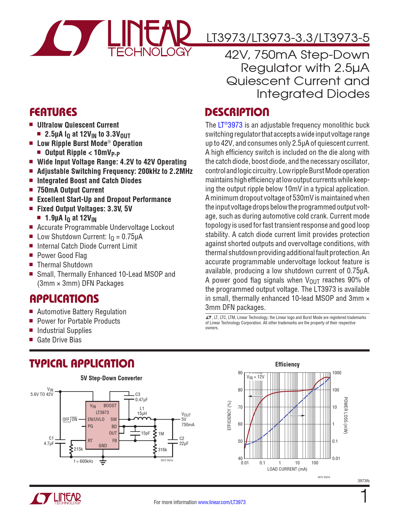

LT3973/LT3973-3.3/LT3973-5 42V, 750mA Step-Down Regulator with 2.5µA Quiescent Current and Integrated Diodes
FEATURES DESCRIPTION
n
Ultralow Quiescent Current
The LT®3973 is an adjustable frequency monolithic buck n
2.5µA IQ at 12VIN to 3.3VOUT
switching regulator that accepts a wide input voltage range n
Low Ripple Burst Mode
Operation
up to 42V, and consumes only 2.5µA of quiescent current. n
Output Ripple < 10mVP-P
A high efficiency switch is included on the die along with n
Wide Input Voltage Range: 4.2V to 42V Operating
the catch diode, boost diode, and the necessary oscillator, n
Adjustable Switching Frequency: 200kHz to 2.2MHz
control and logic circuitry. Low ripple Burst Mode operation n
Integrated Boost and Catch Diodes
maintains high efficiency at low output currents while keep- n
750mA Output Current
ing the output ripple below 10mV in a typical application. n
Excellent Start-Up and Dropout Performance
A minimum dropout voltage of 530mV is maintained when n
Fixed Output Voltages: 3.3V, 5V
the input voltage drops below the programmed output volt- n
1.9µA I
age, such as during automotive cold crank. Current mode
Q at 12VIN
n topology is used for fast transient response and good loop Accurate Programmable Undervoltage Lockout n stability. A catch diode current limit provides protection Low Shutdown Current: IQ = 0.75µA n against shorted outputs and overvoltage conditions, with Internal Catch Diode Current Limit n thermal shutdown providing additional fault protection. An Power Good Flag n accurate programmable undervoltage lockout feature is Thermal Shutdown n available, producing a low shutdown current of 0.75µA. Small, Thermally Enhanced 10-Lead MSOP and A power good flag signals when VOUT reaches 90% of (3mm × 3mm) DFN Packages the programmed output voltage. The LT3973 is available
APPLICATIONS
in small, thermally enhanced 10-lead MSOP and 3mm × 3mm DFN packages. n Automotive Battery Regulation L, LT, LTC, LTM, Linear Technology, the Linear logo and Burst Mode are registered trademarks n Power for Portable Products of Linear Technology Corporation. All other trademarks are the property of their respective owners. n Industrial Supplies n Gate Drive Bias
TYPICAL APPLICATION Efficiency
