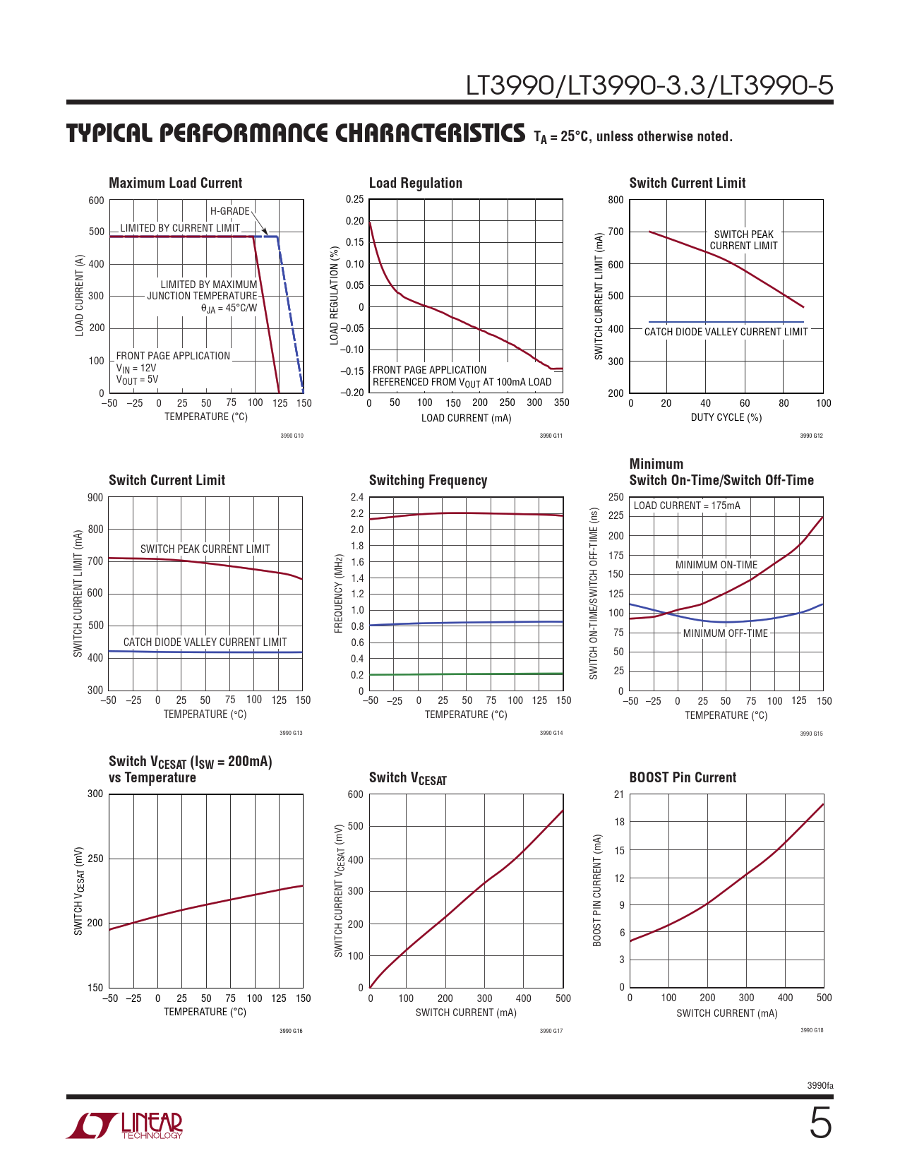

TYPICAL PERFORMANCE CHARACTERISTICS TA = 25°C, unless otherwise noted. Maximum Load Current. Load Regulation
TYPICAL PERFORMANCE CHARACTERISTICS TA = 25°C, unless otherwise noted Maximum Load Current Load Regulation
LT3990/LT3990-3.3/LT3990-5
TYPICAL PERFORMANCE CHARACTERISTICS TA = 25°C, unless otherwise noted. Maximum Load Current Load Regulation Switch Current Limit
600 0.25 800 H-GRADE 0.20 500 LIMITED BY CURRENT LIMIT 700 SWITCH PEAK 0.15 CURRENT LIMIT 400 0.10 600 LIMITED BY MAXIMUM 0.05 300 JUNCTION TEMPERATURE 500 θJA = 45°C/W 0 LOAD CURRENT (A) 200 –0.05 400 CATCH DIODE VALLEY CURRENT LIMIT LOAD REGULATION (%) –0.10 100 FRONT PAGE APPLICATION SWITCH CURRENT LIMIT (mA) 300 VIN = 12V –0.15 FRONT PAGE APPLICATION VOUT = 5V REFERENCED FROM VOUT AT 100mA LOAD 0 –0.20 200 –50 –25 0 25 50 75 100 125 150 0 50 100 150 200 250 300 350 0 20 40 60 80 100 TEMPERATURE (°C) LOAD CURRENT (mA) DUTY CYCLE (%) 3990 G10 3990 G11 3990 G12
Minimum Switch Current Limit Switching Frequency Switch On-Time/Switch Off-Time
900 2.4 250 LOAD CURRENT = 175mA 2.2 225 800 2.0 200 SWITCH PEAK CURRENT LIMIT 1.8 700 175 1.6 MINIMUM ON-TIME 1.4 150 600 1.2 125 1.0 100 500 FREQUENCY (MHz) 0.8 75 MINIMUM OFF-TIME CATCH DIODE VALLEY CURRENT LIMIT 0.6 SWITCH CURRENT LIMIT (mA) 400 50 0.4 0.2 SWITCH ON-TIME/SWITCH OFF-TIME (ns) 25 300 0 0 –50 –25 0 25 50 75 100 125 150 –50 –25 0 25 50 75 100 125 150 –50 –25 0 25 50 75 100 125 150 TEMPERATURE (°C) TEMPERATURE (°C) TEMPERATURE (°C) 3990 G13 3990 G14 3990 G15
Switch VCESAT (ISW = 200mA) vs Temperature Switch VCESAT BOOST Pin Current
