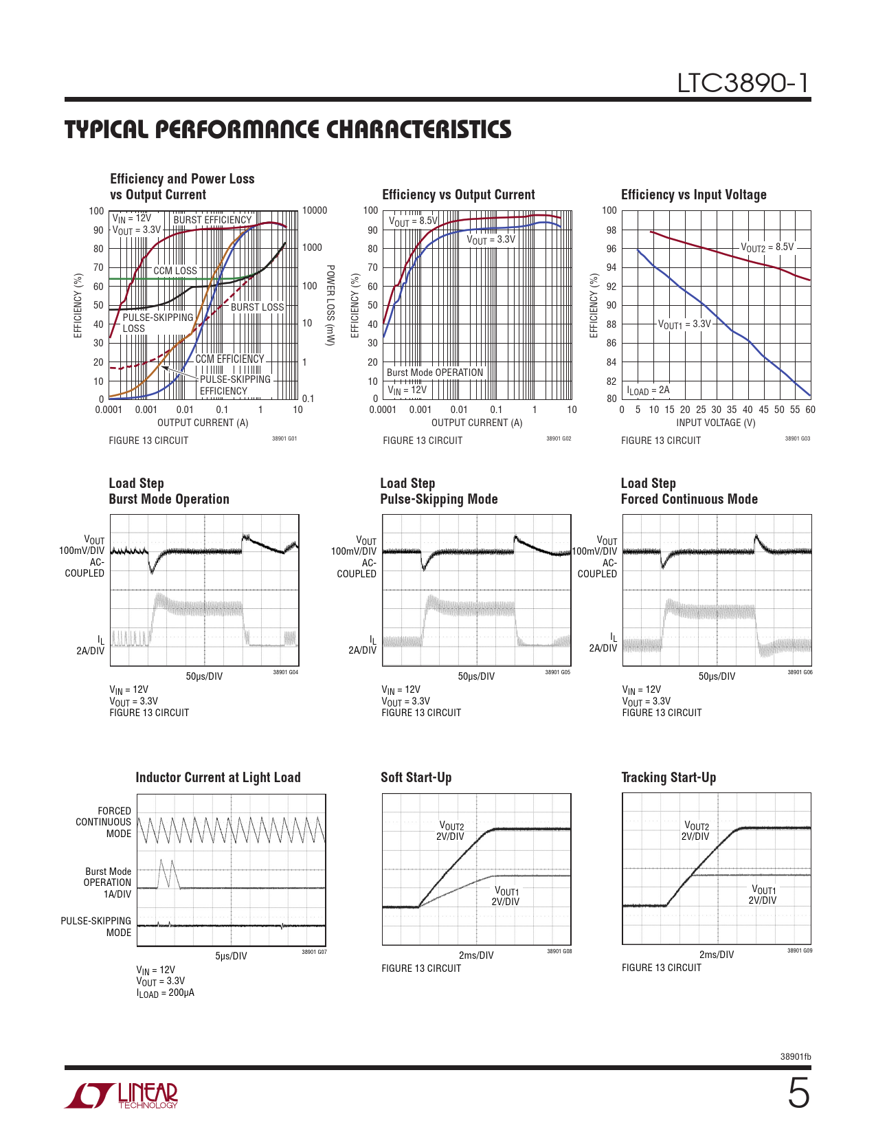

TYPICAL PERFORMANCE CHARACTERISTICS. Efficiency and Power Loss. vs Output Current. Efficiency vs Output Current
TYPICAL PERFORMANCE CHARACTERISTICS Efficiency and Power Loss vs Output Current Efficiency vs Output Current
LTC3890-1
TYPICAL PERFORMANCE CHARACTERISTICS Efficiency and Power Loss vs Output Current Efficiency vs Output Current Efficiency vs Input Voltage
100 10000 100 100 VIN = 12V BURST EFFICIENCY VOUT = 8.5V 90 VOUT = 3.3V 90 98 VOUT = 3.3V 80 1000 80 96 VOUT2 = 8.5V POWER LOSS (mW) 70 70 94 CCM LOSS 60 100 60 92 50 BURST LOSS 50 90 PULSE-SKIPPING 40 10 40 88 VOUT1 = 3.3V EFFICIENCY (%) LOSS EFFICIENCY (%) EFFICIENCY (%) 30 30 86 20 CCM EFFICIENCY 1 20 84 Burst Mode OPERATION 10 PULSE-SKIPPING 10 82 EFFICIENCY VIN = 12V ILOAD = 2A 0 0.1 0 80 0.0001 0.001 0.01 0.1 1 10 0.0001 0.001 0.01 0.1 1 10 0 5 10 15 20 25 30 35 40 45 50 55 60 OUTPUT CURRENT (A) OUTPUT CURRENT (A) INPUT VOLTAGE (V) 38901 G01 38901 G02 FIGURE 13 CIRCUIT FIGURE 13 CIRCUIT 38901 G03 FIGURE 13 CIRCUIT
Load Step Load Step Load Step Burst Mode Operation Pulse-Skipping Mode Forced Continuous Mode
VOUT VOUT VOUT 100mV/DIV 100mV/DIV 100mV/DIV AC- AC- AC- COUPLED COUPLED COUPLED I I L IL L 2A/DIV 2A/DIV 2A/DIV 50µs/DIV 38901 G04 50µs/DIV 38901 G05 50µs/DIV 38901 G06 VIN = 12V VIN = 12V VIN = 12V VOUT = 3.3V VOUT = 3.3V VOUT = 3.3V FIGURE 13 CIRCUIT FIGURE 13 CIRCUIT FIGURE 13 CIRCUIT
Inductor Current at Light Load Soft Start-Up Tracking Start-Up
FORCED CONTINUOUS VOUT2 V MODE OUT2 2V/DIV 2V/DIV Burst Mode OPERATION 1A/DIV VOUT1 VOUT1 2V/DIV 2V/DIV PULSE-SKIPPING MODE 5µs/DIV 38901 G07 2ms/DIV 38901 G08 2ms/DIV 38901 G09 VIN = 12V FIGURE 13 CIRCUIT FIGURE 13 CIRCUIT VOUT = 3.3V ILOAD = 200µA 38901fb 5 Document Outline Features Description Applications Typical Application Absolute Maximum Ratings Pin Configuration Order Information Electrical Characteristics Typical Performance Characteristics Pin Functions Functional Diagram Operation Applications Information Typical Applications Package Description Revision History Typical Application Related Parts
