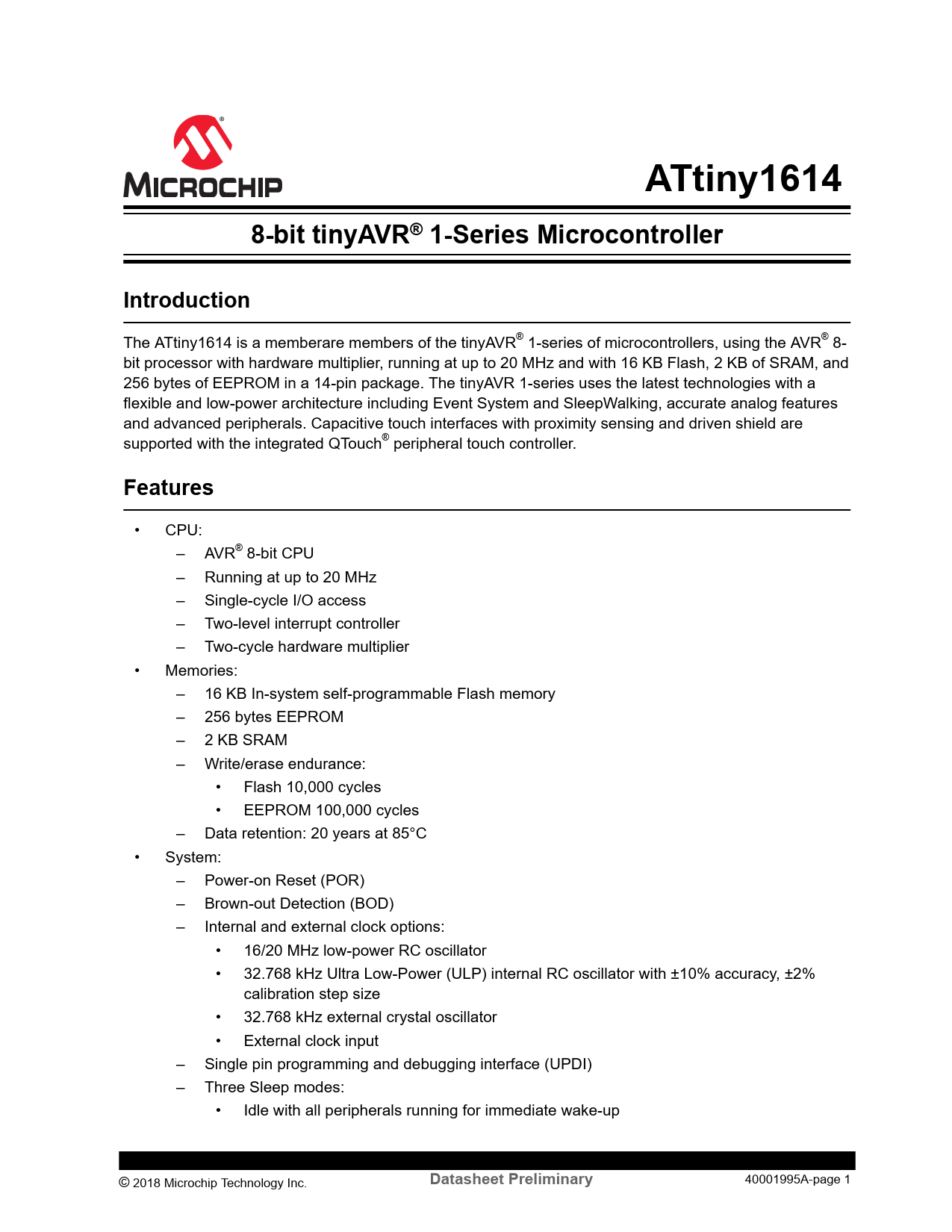

ATtiny1614. 8-bit tinyAVR® 1-Series Microcontroller. Introduction. Features. Datasheet Preliminary
Datasheet ATtiny1614 Microchip
ATtiny1614 8-bit tinyAVR® 1-Series Microcontroller Introduction
The ATtiny1614 is a memberare members of the tinyAVR® 1-series of microcontrollers, using the AVR® 8- bit processor with hardware multiplier, running at up to 20 MHz and with 16 KB Flash, 2 KB of SRAM, and 256 bytes of EEPROM in a 14-pin package. The tinyAVR 1-series uses the latest technologies with a flexible and low-power architecture including Event System and SleepWalking, accurate analog features and advanced peripherals. Capacitive touch interfaces with proximity sensing and driven shield are supported with the integrated QTouch® peripheral touch controller.
Features
• CPU: – AVR® 8-bit CPU – Running at up to 20 MHz – Single-cycle I/O access – Two-level interrupt controller – Two-cycle hardware multiplier • Memories: – 16 KB In-system self-programmable Flash memory – 256 bytes EEPROM – 2 KB SRAM – Write/erase endurance: • Flash 10,000 cycles • EEPROM 100,000 cycles – Data retention: 20 years at 85°C • System: – Power-on Reset (POR) – Brown-out Detection (BOD) – Internal and external clock options: • 16/20 MHz low-power RC oscillator • 32.768 kHz Ultra Low-Power (ULP) internal RC oscillator with ±10% accuracy, ±2% calibration step size • 32.768 kHz external crystal oscillator • External clock input – Single pin programming and debugging interface (UPDI) – Three Sleep modes: • Idle with all peripherals running for immediate wake-up © 2018 Microchip Technology Inc.
