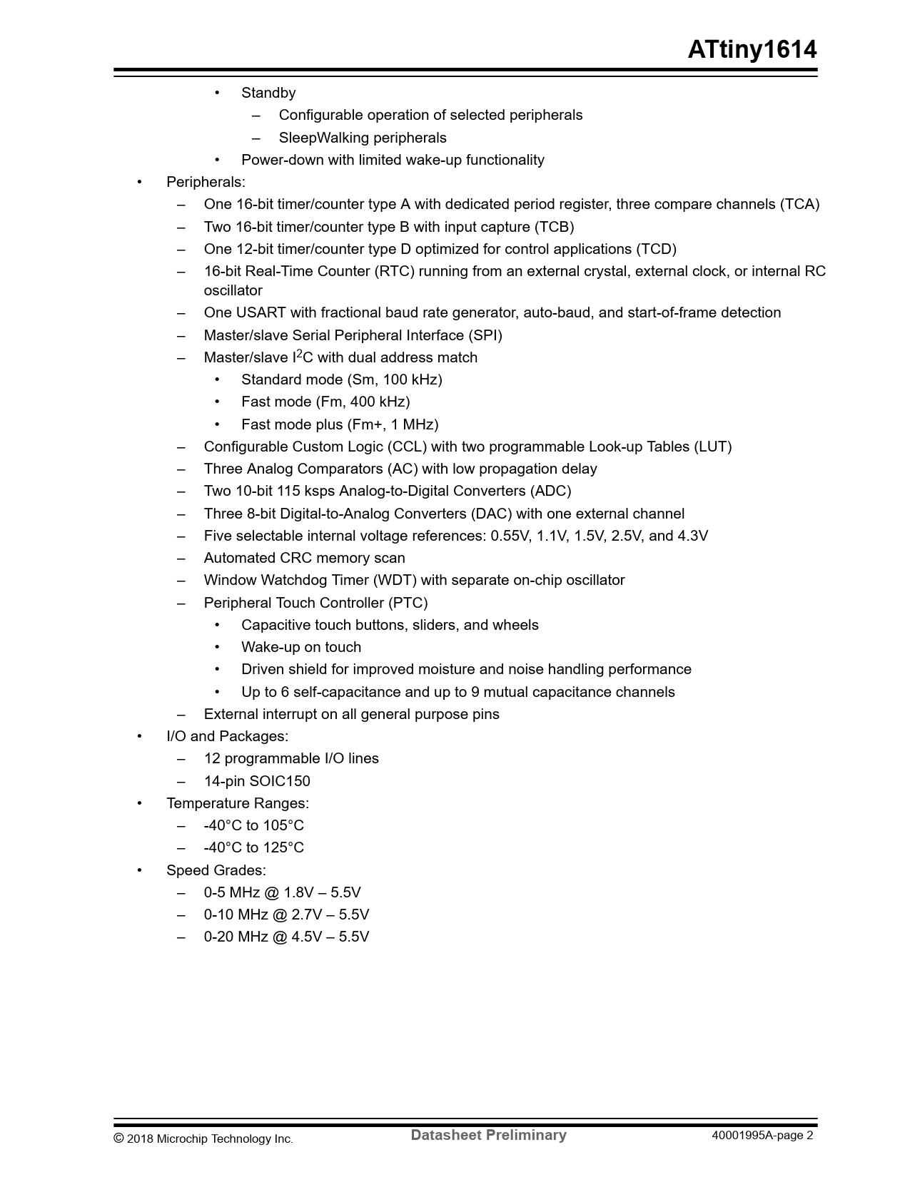

ATtiny1614
• Standby – Configurable operation of selected peripherals – SleepWalking peripherals • Power-down with limited wake-up functionality • Peripherals: – One 16-bit timer/counter type A with dedicated period register, three compare channels (TCA) – Two 16-bit timer/counter type B with input capture (TCB) – One 12-bit timer/counter type D optimized for control applications (TCD) – 16-bit Real-Time Counter (RTC) running from an external crystal, external clock, or internal RC oscillator – One USART with fractional baud rate generator, auto-baud, and start-of-frame detection – Master/slave Serial Peripheral Interface (SPI) – Master/slave I2C with dual address match • Standard mode (Sm, 100 kHz) • Fast mode (Fm, 400 kHz) • Fast mode plus (Fm+, 1 MHz) – Configurable Custom Logic (CCL) with two programmable Look-up Tables (LUT) – Three Analog Comparators (AC) with low propagation delay – Two 10-bit 115 ksps Analog-to-Digital Converters (ADC) – Three 8-bit Digital-to-Analog Converters (DAC) with one external channel – Five selectable internal voltage references: 0.55V, 1.1V, 1.5V, 2.5V, and 4.3V – Automated CRC memory scan – Window Watchdog Timer (WDT) with separate on-chip oscillator – Peripheral Touch Controller (PTC) • Capacitive touch buttons, sliders, and wheels • Wake-up on touch • Driven shield for improved moisture and noise handling performance • Up to 6 self-capacitance and up to 9 mutual capacitance channels – External interrupt on all general purpose pins • I/O and Packages: – 12 programmable I/O lines – 14-pin SOIC150 • Temperature Ranges: – -40°C to 105°C – -40°C to 125°C • Speed Grades: – 0-5 MHz @ 1.8V – 5.5V – 0-10 MHz @ 2.7V – 5.5V – 0-20 MHz @ 4.5V – 5.5V © 2018 Microchip Technology Inc.
