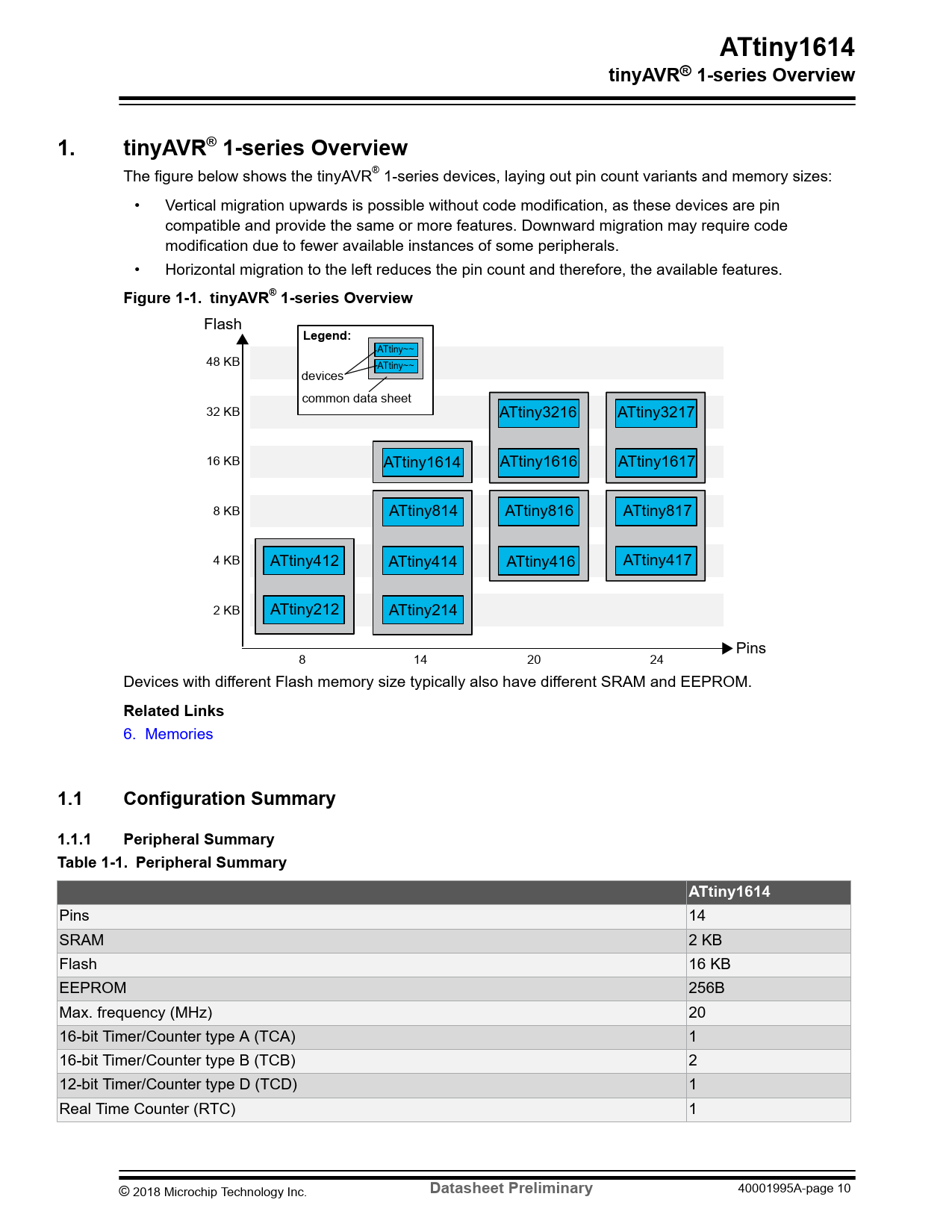

ATtiny1614 tinyAVR® 1-series Overview 1. tinyAVR® 1-series Overview
The figure below shows the tinyAVR® 1-series devices, laying out pin count variants and memory sizes: • Vertical migration upwards is possible without code modification, as these devices are pin compatible and provide the same or more features. Downward migration may require code modification due to fewer available instances of some peripherals. • Horizontal migration to the left reduces the pin count and therefore, the available features.
Figure 1-1. tinyAVR® 1-series Overview
Flash
Legend:
ATtiny~~ 48 KB ATtiny~~ devices common data sheet 32 KB ATtiny3216 ATtiny3217 16 KB ATtiny1614 ATtiny1616 ATtiny1617 8 KB ATtiny814 ATtiny816 ATtiny817 4 KB ATtiny412 ATtiny414 ATtiny416 ATtiny417 2 KB ATtiny212 ATtiny214 Pins 8 14 20 24 Devices with different Flash memory size typically also have different SRAM and EEPROM.
Related Links
6. Memories
1.1 Configuration Summary 1.1.1 Peripheral Summary Table 1-1. Peripheral Summary ATtiny1614
Pins 14 SRAM 2 KB Flash 16 KB EEPROM 256B Max. frequency (MHz) 20 16-bit Timer/Counter type A (TCA) 1 16-bit Timer/Counter type B (TCB) 2 12-bit Timer/Counter type D (TCD) 1 Real Time Counter (RTC) 1 © 2018 Microchip Technology Inc.
