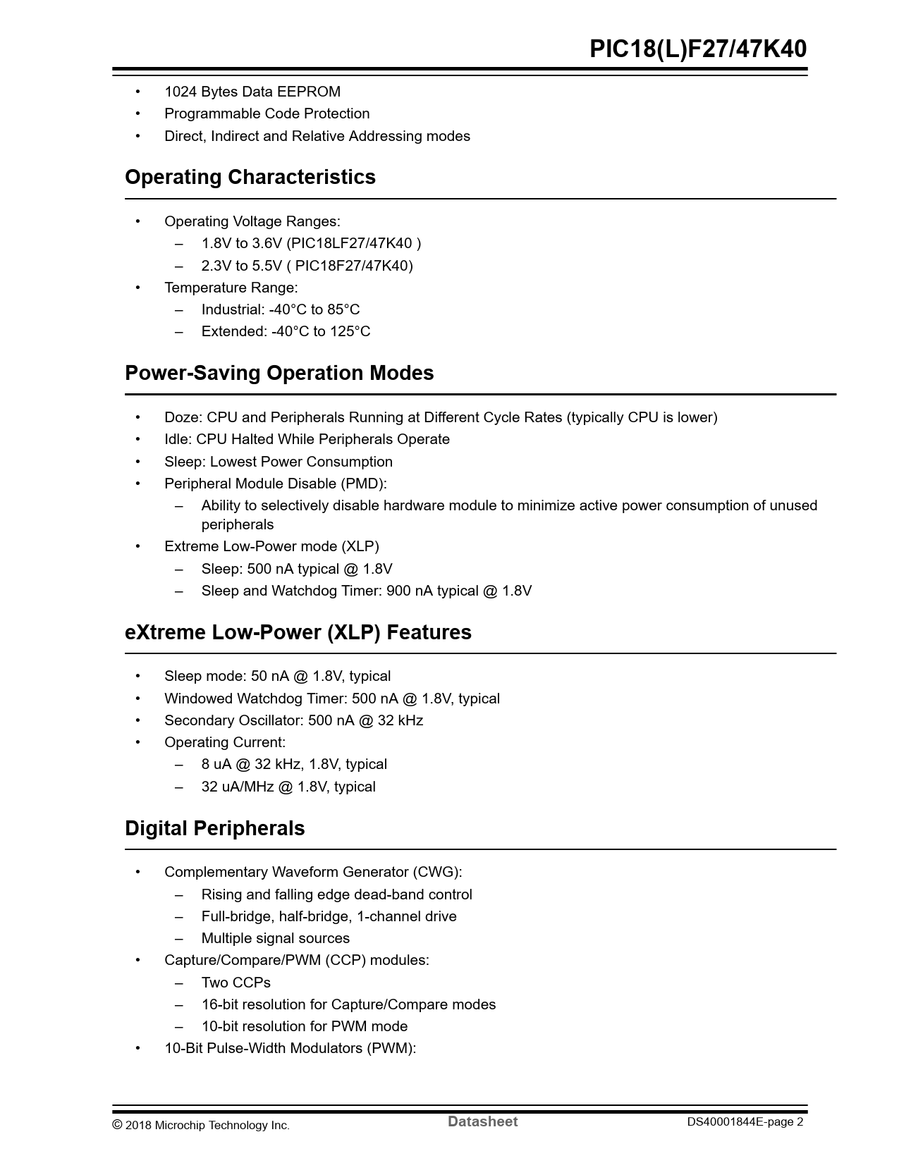

PIC18(L)F27/47K40
• 1024 Bytes Data EEPROM • Programmable Code Protection • Direct, Indirect and Relative Addressing modes
Operating Characteristics
• Operating Voltage Ranges: – 1.8V to 3.6V (PIC18LF27/47K40 ) – 2.3V to 5.5V ( PIC18F27/47K40) • Temperature Range: – Industrial: -40°C to 85°C – Extended: -40°C to 125°C
Power-Saving Operation Modes
• Doze: CPU and Peripherals Running at Different Cycle Rates (typically CPU is lower) • Idle: CPU Halted While Peripherals Operate • Sleep: Lowest Power Consumption • Peripheral Module Disable (PMD): – Ability to selectively disable hardware module to minimize active power consumption of unused peripherals • Extreme Low-Power mode (XLP) – Sleep: 500 nA typical @ 1.8V – Sleep and Watchdog Timer: 900 nA typical @ 1.8V
eXtreme Low-Power (XLP) Features
• Sleep mode: 50 nA @ 1.8V, typical • Windowed Watchdog Timer: 500 nA @ 1.8V, typical • Secondary Oscillator: 500 nA @ 32 kHz • Operating Current: – 8 uA @ 32 kHz, 1.8V, typical – 32 uA/MHz @ 1.8V, typical
Digital Peripherals
• Complementary Waveform Generator (CWG): – Rising and falling edge dead-band control – Full-bridge, half-bridge, 1-channel drive – Multiple signal sources • Capture/Compare/PWM (CCP) modules: – Two CCPs – 16-bit resolution for Capture/Compare modes – 10-bit resolution for PWM mode • 10-Bit Pulse-Width Modulators (PWM): © 2018 Microchip Technology Inc.
