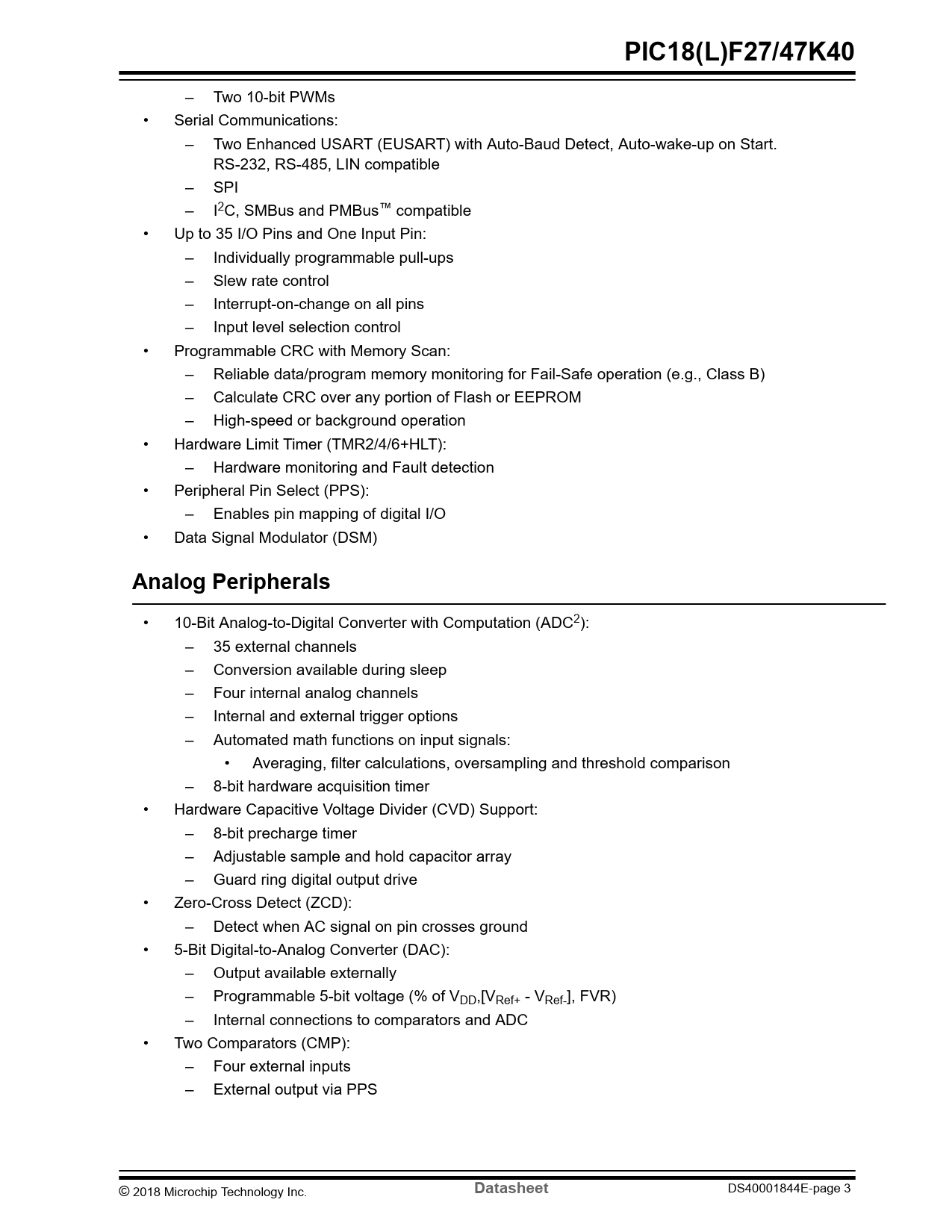

PIC18(L)F27/47K40
– Two 10-bit PWMs • Serial Communications: – Two Enhanced USART (EUSART) with Auto-Baud Detect, Auto-wake-up on Start. RS-232, RS-485, LIN compatible – SPI – I2C, SMBus and PMBus™ compatible • Up to 35 I/O Pins and One Input Pin: – Individually programmable pull-ups – Slew rate control – Interrupt-on-change on all pins – Input level selection control • Programmable CRC with Memory Scan: – Reliable data/program memory monitoring for Fail-Safe operation (e.g., Class B) – Calculate CRC over any portion of Flash or EEPROM – High-speed or background operation • Hardware Limit Timer (TMR2/4/6+HLT): – Hardware monitoring and Fault detection • Peripheral Pin Select (PPS): – Enables pin mapping of digital I/O • Data Signal Modulator (DSM)
Analog Peripherals
• 10-Bit Analog-to-Digital Converter with Computation (ADC2): – 35 external channels – Conversion available during sleep – Four internal analog channels – Internal and external trigger options – Automated math functions on input signals: • Averaging, filter calculations, oversampling and threshold comparison – 8-bit hardware acquisition timer • Hardware Capacitive Voltage Divider (CVD) Support: – 8-bit precharge timer – Adjustable sample and hold capacitor array – Guard ring digital output drive • Zero-Cross Detect (ZCD): – Detect when AC signal on pin crosses ground • 5-Bit Digital-to-Analog Converter (DAC): – Output available externally – Programmable 5-bit voltage (% of VDD,[VRef+ - VRef-], FVR) – Internal connections to comparators and ADC • Two Comparators (CMP): – Four external inputs – External output via PPS © 2018 Microchip Technology Inc.
