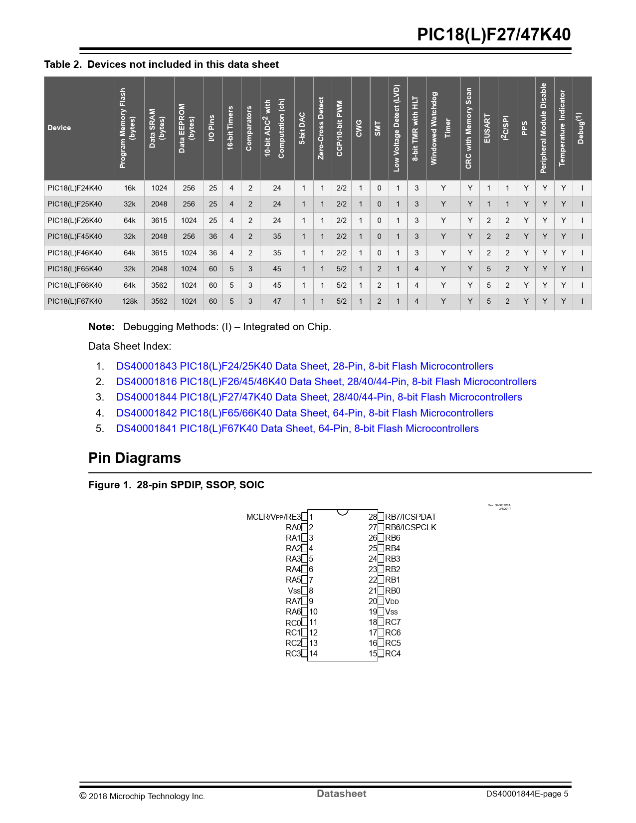

PIC18(L)F27/47K40. Table 2. Devices not included in this data sheet. VD). 2 with. atchdog. imers. (1). Device. imer. (bytes). CWG. SMT
PIC18(L)F27/47K40 Table 2. Devices not included in this data sheet VD) 2 with atchdog imers (1) Device imer (bytes) CWG SMT
PIC18(L)F27/47K40 Table 2. Devices not included in this data sheet VD) T 2 with atchdog imers (1) Device imer (bytes) (bytes) (bytes) CWG SMT I/O Pins T 2 C/SPI PPS EUSART I Data SRAM 5-bit DAC Debug Data EEPROM 16-bit T Comparators oltage Detect (L 10-bit ADC Computation (ch) Zero-Cross Detect CCP/10-bit PWM 8-bit TMR with HL indowed W Program Memory Flash W Temperature Indicator Low V CRC with Memory Scan Peripheral Module Disable
PIC18(L)F24K40 16k 1024 256 25 4 2 24 1 1 2/2 1 0 1 3 Y Y 1 1 Y Y Y I PIC18(L)F25K40 32k 2048 256 25 4 2 24 1 1 2/2 1 0 1 3 Y Y 1 1 Y Y Y I PIC18(L)F26K40 64k 3615 1024 25 4 2 24 1 1 2/2 1 0 1 3 Y Y 2 2 Y Y Y I PIC18(L)F45K40 32k 2048 256 36 4 2 35 1 1 2/2 1 0 1 3 Y Y 2 2 Y Y Y I PIC18(L)F46K40 64k 3615 1024 36 4 2 35 1 1 2/2 1 0 1 3 Y Y 2 2 Y Y Y I PIC18(L)F65K40 32k 2048 1024 60 5 3 45 1 1 5/2 1 2 1 4 Y Y 5 2 Y Y Y I PIC18(L)F66K40 64k 3562 1024 60 5 3 45 1 1 5/2 1 2 1 4 Y Y 5 2 Y Y Y I PIC18(L)F67K40 128k 3562 1024 60 5 3 47 1 1 5/2 1 2 1 4 Y Y 5 2 Y Y Y I
Note: 
Debugging Methods: (I) – Integrated on Chip. Data Sheet Index: 1. DS40001843 PIC18(L)F24/25K40 Data Sheet, 28-Pin, 8-bit Flash Microcontrollers 2. DS40001816 PIC18(L)F26/45/46K40 Data Sheet, 28/40/44-Pin, 8-bit Flash Microcontrollers 3. DS40001844 PIC18(L)F27/47K40 Data Sheet, 28/40/44-Pin, 8-bit Flash Microcontrollers 4. DS40001842 PIC18(L)F65/66K40 Data Sheet, 64-Pin, 8-bit Flash Microcontrollers 5. Filena DS40001841 PIC18(L)F67K40 Data Sheet, 64-Pin, 8-bit Flash Microcontrollers me: 00-000028A.vsd Title: 28-pin DIP Last Edit: 3/6/2017
Pin Diagrams
First Used: N/A Notes: Generic 28-pin dual in-line diagram
Figure 1. 28-pin SPDIP, SSOP, SOIC
Rev. 00-000 028A 3/6/201 7 MCLR/VPP/RE3 1 28 RB7/ICSPDAT RA0 2 27 RB6/ICSPCLK RA1 3 26 RB6 RA2 4 25 RB4 RA3 5 24 RB3 RA4 6 23 RB2 RA5 7 22 RB1 VSS 8 21 RB0 RA7 9 20 VDD RA6 10 19 VSS RC0 11 18 RC7 RC1 12 17 RC6 RC2 13 16 RC5 RC3 14 15 RC4 © 2018 Microchip Technology Inc.
