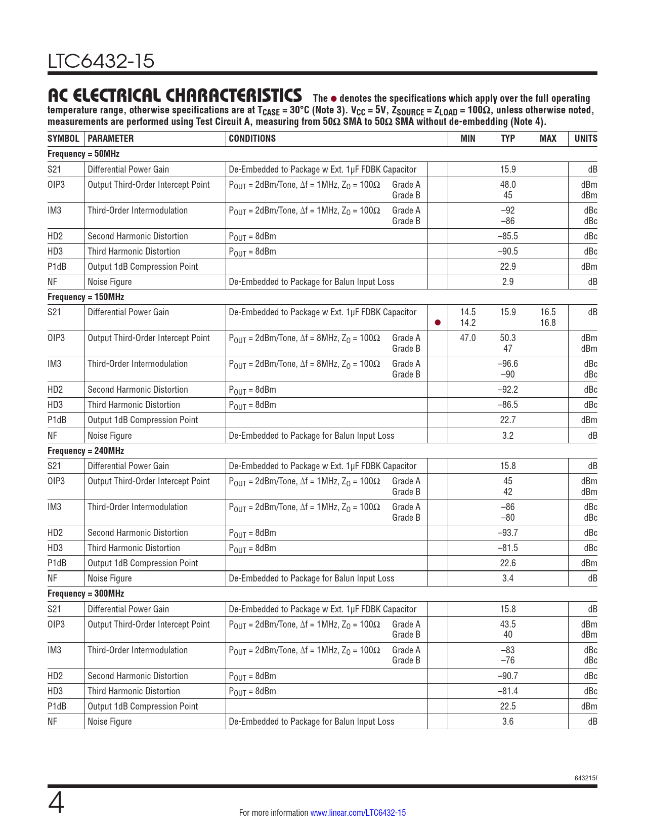

AC ELECTRICAL CHARACTERISTICS. The. denotes the specifications which apply over the full operating
AC ELECTRICAL CHARACTERISTICS The denotes the specifications which apply over the full operating
LTC6432-15
l
denotes the specifications which apply over the full operating temperature range, otherwise specifications are at TCASE = 30°C (Note 3). VCC = 5V, ZSOURCE = ZLOAD = 100Ω, unless otherwise noted, measurements are performed using Test Circuit A, measuring from 50Ω SMA to 50Ω SMA without de-embedding (Note 4). SYMBOL PARAMETER CONDITIONS MIN TYP MAX UNITS Frequency = 50MHz
S21 Differential Power Gain De-Embedded to Package w Ext. 1µF FDBK Capacitor 15.9 dB OIP3 Output Third-Order Intercept Point POUT = 2dBm/Tone, ∆f = 1MHz, ZO = 100Ω Grade A 48.0 dBm Grade B 45 dBm IM3 Third-Order Intermodulation POUT = 2dBm/Tone, ∆f = 1MHz, ZO = 100Ω Grade A –92 dBc Grade B –86 dBc HD2 Second Harmonic Distortion POUT = 8dBm –85.5 dBc HD3 Third Harmonic Distortion POUT = 8dBm –90.5 dBc P1dB Output 1dB Compression Point 22.9 dBm NF Noise Figure De-Embedded to Package for Balun Input Loss 2.9 dB
Frequency = 150MHz
S21 Differential Power Gain De-Embedded to Package w Ext. 1µF FDBK Capacitor 14.5 15.9 16.5 dB l 14.2 16.8 OIP3 Output Third-Order Intercept Point POUT = 2dBm/Tone, ∆f = 8MHz, ZO = 100Ω Grade A 47.0 50.3 dBm Grade B 47 dBm IM3 Third-Order Intermodulation POUT = 2dBm/Tone, ∆f = 8MHz, ZO = 100Ω Grade A –96.6 dBc Grade B –90 dBc HD2 Second Harmonic Distortion POUT = 8dBm –92.2 dBc HD3 Third Harmonic Distortion POUT = 8dBm –86.5 dBc P1dB Output 1dB Compression Point 22.7 dBm NF Noise Figure De-Embedded to Package for Balun Input Loss 3.2 dB
Frequency = 240MHz
S21 Differential Power Gain De-Embedded to Package w Ext. 1µF FDBK Capacitor 15.8 dB OIP3 Output Third-Order Intercept Point POUT = 2dBm/Tone, ∆f = 1MHz, ZO = 100Ω Grade A 45 dBm Grade B 42 dBm IM3 Third-Order Intermodulation POUT = 2dBm/Tone, ∆f = 1MHz, ZO = 100Ω Grade A –86 dBc Grade B –80 dBc HD2 Second Harmonic Distortion POUT = 8dBm –93.7 dBc HD3 Third Harmonic Distortion POUT = 8dBm –81.5 dBc P1dB Output 1dB Compression Point 22.6 dBm NF Noise Figure De-Embedded to Package for Balun Input Loss 3.4 dB
Frequency = 300MHz
S21 Differential Power Gain De-Embedded to Package w Ext. 1µF FDBK Capacitor 15.8 dB OIP3 Output Third-Order Intercept Point POUT = 2dBm/Tone, ∆f = 1MHz, ZO = 100Ω Grade A 43.5 dBm Grade B 40 dBm IM3 Third-Order Intermodulation POUT = 2dBm/Tone, ∆f = 1MHz, ZO = 100Ω Grade A –83 dBc Grade B –76 dBc HD2 Second Harmonic Distortion POUT = 8dBm –90.7 dBc HD3 Third Harmonic Distortion POUT = 8dBm –81.4 dBc P1dB Output 1dB Compression Point 22.5 dBm NF Noise Figure De-Embedded to Package for Balun Input Loss 3.6 dB 643215f 4 For more information www.linear.com/LTC6432-15 Document Outline Features Applications Description Typical Application Absolute Maximum Ratings Pin Configuration Order Information DC Electrical Characteristics AC Electrical Characteristics Typical Performance Characteristics Pin Functions Block Diagram Test Circuit A Operation Applications Information Differential S Parameters Package Description Typical Application Related Parts
