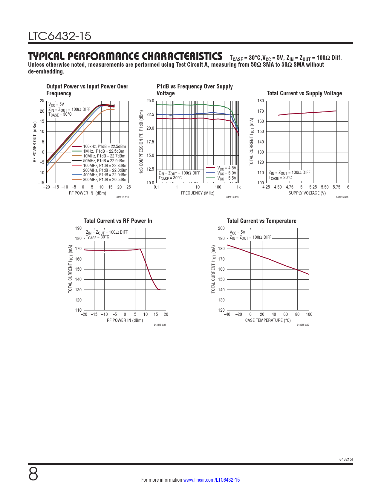

Pages / Page20 / 8 — TYPICAL PERFORMANCE CHARACTERISTICS. TCASE = 30°C,VCC = 5V, ZIN = ZOUT = …
TYPICAL PERFORMANCE CHARACTERISTICS. TCASE = 30°C,VCC = 5V, ZIN = ZOUT = 100Ω Diff
TYPICAL PERFORMANCE CHARACTERISTICS TCASE = 30°C,VCC = 5V, ZIN = ZOUT = 100Ω Diff
LTC6432-15
TYPICAL PERFORMANCE CHARACTERISTICS TCASE = 30°C,VCC = 5V, ZIN = ZOUT = 100Ω Diff. Unless otherwise noted, measurements are performed using Test Circuit A, measuring from 50Ω SMA to 50Ω SMA without de-embedding. Output Power vs Input Power Over P1dB vs Frequency Over Supply Frequency Voltage Total Current vs Supply Voltage
25 25.0 180 VCC = 5V Z 20 IN = ZOUT = 100Ω DIFF 170 TCASE = 30°C 22.5 15 160 (mA) 20.0 10 TOT 150 T. P1dB (dBm) 5 17.5 140 100kHz, P1dB = 22.5dBm 0 1MHz, P1dB = 22.5dBm 130 10MHz, P1dB = 22.7dBm 15.0 AL CURRENT I RF POWER OUT (dBm) 50MHz, P1dB = 22.9dBm –5 120 100MHz, P1dB = 22.8dBm TOT 200MHz, P1dB = 22.0dBm V 12.5 CC = 4.5V –10 400MHz, P1dB = 22.0dBm 1dB COMPRESSION P Z V 110 Z IN = ZOUT = 100Ω DIFF CC = 5.0V IN = ZOUT = 100Ω DIFF 800MHz, P1dB = 20.5dBm T V T CASE = 30°C CC = 5.5V CASE = 30°C –15 10.0 100 –20 –15 –10 –5 0 5 10 15 20 25 0.1 1 10 100 1k 4.25 4.50 4.75 5 5.25 5.50 5.75 6 RF POWER IN (dBm) FREQUENCY (MHz) SUPPLY VOLTAGE (V) 643215 G18 643215 G19 643215 G20
Total Current vs RF Power In Total Current vs Temperature
190 200 ZIN = ZOUT = 100Ω DIFF VCC = 5V 180 TCASE = 30°C Z 190 IN = ZOUT = 100Ω DIFF 170 180 (mA) (mA) TOT 160 TOT 170 150 160 140 150 AL CURRENT I AL CURRENT I 130 TOT 140 TOT 120 130 110 120 –20 –15 –10 –5 0 5 10 15 20 –40 –20 0 20 40 60 80 100 RF POWER IN (dBm) CASE TEMPERATURE (°C) 643215 G21 643215 G22 643215f 8 For more information www.linear.com/LTC6432-15 Document Outline Features Applications Description Typical Application Absolute Maximum Ratings Pin Configuration Order Information DC Electrical Characteristics AC Electrical Characteristics Typical Performance Characteristics Pin Functions Block Diagram Test Circuit A Operation Applications Information Differential S Parameters Package Description Typical Application Related Parts
