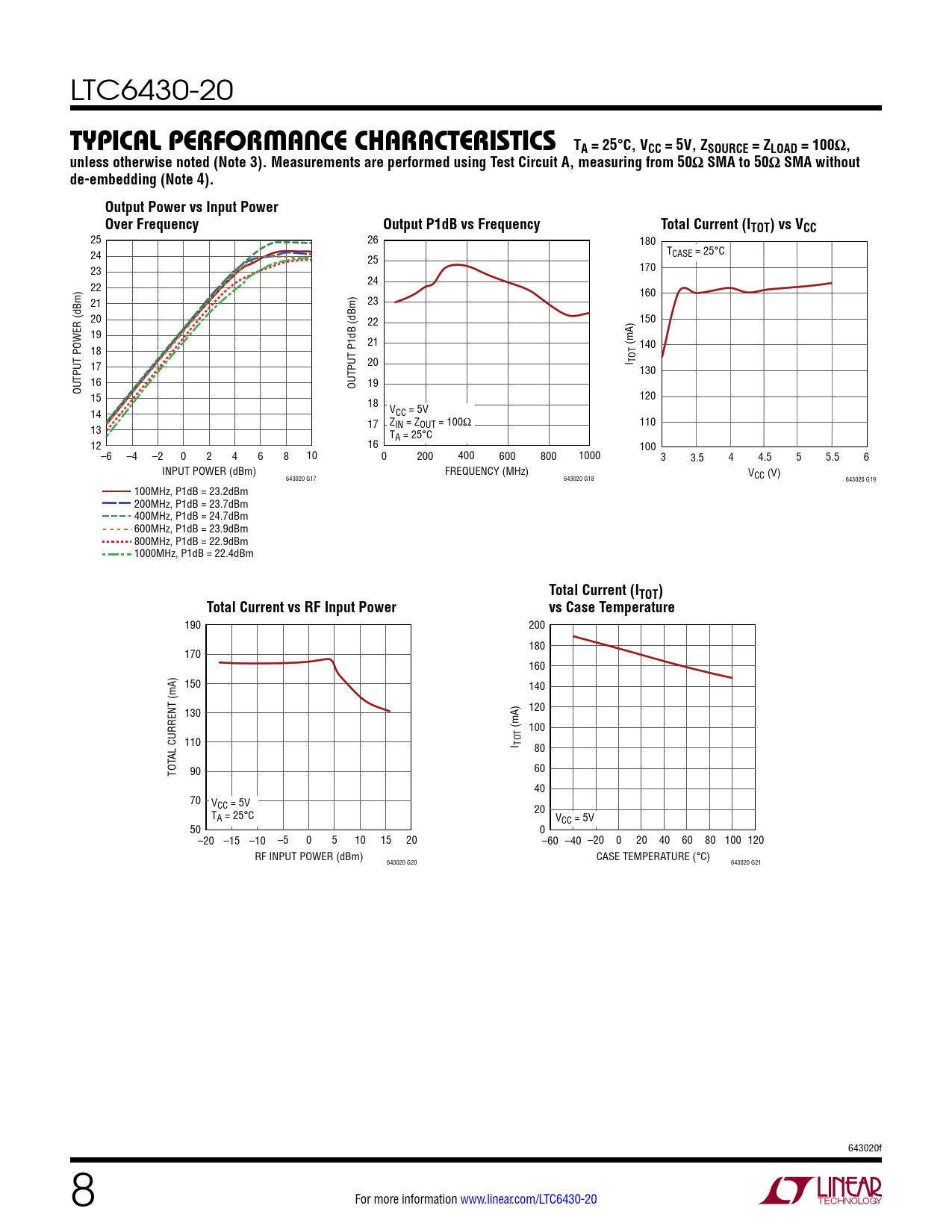

TYPICAL PERFORMANCE CHARACTERISTICS TA = 25°C, VCC = 5V, ZSOURCE = ZLOAD = 100Ω,
![TYPICAL PERFORMANCE CHARACTERISTICS TA = 25°C, VCC = 5V, ZSOURCE = ZLOAD = 100Ω,](https://www.rlocman.ru/datasheet/img.php?di=150857&p=7)
LTC6430-20
TYPICAL PERFORMANCE CHARACTERISTICS TA = 25°C, VCC = 5V, ZSOURCE = ZLOAD = 100Ω, unless otherwise noted (Note 3). Measurements are performed using Test Circuit A, measuring from 50Ω SMA to 50Ω SMA without de-embedding (Note 4). Output Power vs Input Power Over Frequency Output P1dB vs Frequency Total Current (ITOT) vs VCC
25 26 180 T 24 25 CASE = 25°C 170 23 24 22 160 21 23 20 22 150 19 21 (mA) 140 18 20 I TOT 17 130 16 OUTPUT P1dB (dBm) 19 OUTPUT POWER (dBm) 15 120 18 VCC = 5V 14 17 ZIN = ZOUT = 100Ω 110 13 TA = 25°C 12 16 100 –6 –4 –2 0 2 4 6 8 10 0 200 400 600 800 1000 3 3.5 4 4.5 5 5.5 6 INPUT POWER (dBm) FREQUENCY (MHz) V 643020 G17 643020 G18 CC (V) 643020 G19 100MHz, P1dB = 23.2dBm 200MHz, P1dB = 23.7dBm 400MHz, P1dB = 24.7dBm 600MHz, P1dB = 23.9dBm 800MHz, P1dB = 22.9dBm 1000MHz, P1dB = 22.4dBm
Total Current (ITOT) Total Current vs RF Input Power vs Case Temperature
190 200 180 170 160 150 140 130 120 (mA) 100 110 I TOT 80 AL CURRENT (mA) TOT 90 60 40 70 VCC = 5V T 20 A = 25°C VCC = 5V 50 0 –20 –15 –10 –5 0 5 10 15 20 –60 –40 –20 0 20 40 60 80 100 120 RF INPUT POWER (dBm) CASE TEMPERATURE (°C) 643020 G20 643020 G21 643020f 8 For more information www.linear.com/LTC6430-20 Document Outline Features Applications Description Typical Application Absolute Maximum Ratings Pin Configuration Order Information DC Electrical Characteristics AC Electrical Characteristics Typical Performance Characteristics Pin Functions Block Diagram Test Circuit A Operation Applications Information Differential S Parameters Typical Applications Package Description Typical Application Related Parts
