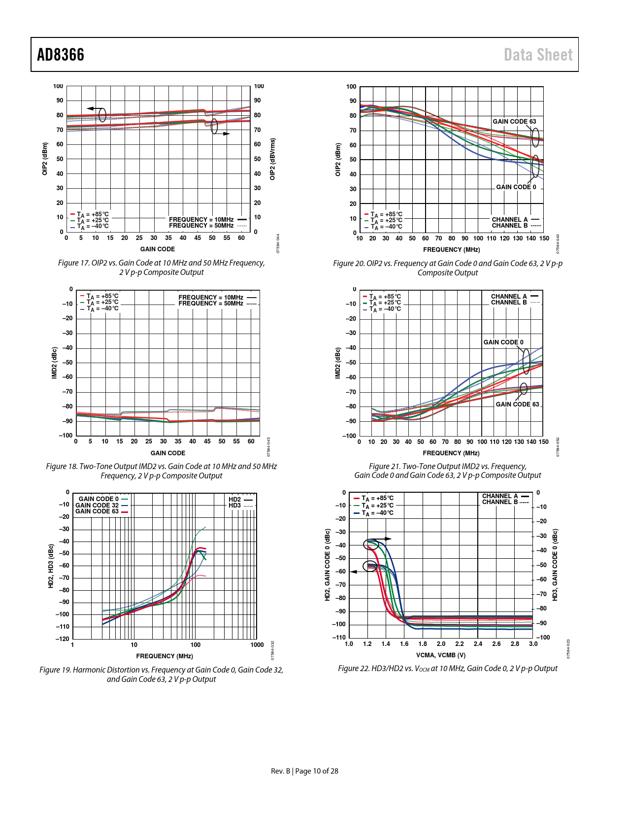

AD8366. Data Sheet. 100. GAIN CODE 63. rms). Bm). 2 (. OIP. GAIN CODE 0. A = +85°C. FREQUENCY = 10MHz. A = +25°C. CHANNEL A. FREQUENCY = 50MHz
AD8366 Data Sheet 100 100 100 90 90 90 80 80 80 GAIN CODE 63 70 70 70 60 60 60 rms) Bm) V Bm) d 50 50 d dB 50 2 ( ( 2 ( IP 2 IP O 40 40 O 40 OIP 30 30 30 GAIN CODE 0 20 20 20 T T 10 A = +85°C 10 A = +85°C T FREQUENCY = 10MHz 10 A = +25°C T CHANNEL A A = +25°C T FREQUENCY = 50MHz A = –40°C T CHANNEL B A = –40°C 0 0 0 0 5 10 15 20 25 30 35 40 45 50 55 60

07584- 07584- Figure 17. OIP2 vs. Gain Code at 10 MHz and 50 MHz Frequency, Figure 20. OIP2 vs. Frequency at Gain Code 0 and Gain Code 63, 2 V p-p 2 V p-p Composite Output Composite Output
0 0 TA = +85°C FREQUENCY = 10MHz TA = +85°C CHANNEL A –10 TA = +25°C FREQUENCY = 50MHz –10 TA = +25°C CHANNEL B TA = –40°C TA = –40°C –20 –20 –30 –30 GAIN CODE 0 –40 –40 Bc) Bc) d d –50 –50 D2 ( D2 ( IM –60 IM –60 –70 –70 –80 –80 GAIN CODE 63 –90 –90 –100 –100 0 5 10 15 20 25 30 35 40 45 50 55 60

07584- 07584- Figure 18. Two-Tone Output IMD2 vs. Gain Code at 10 MHz and 50 MHz Figure 21. Two-Tone Output IMD2 vs. Frequency, Frequency, 2 V p-p Composite Output Gain Code 0 and Gain Code 63, 2 V p-p Composite Output
0 0 0 CHANNEL A GAIN CODE 0 HD2 TA = +85°C –10 CHANNEL B GAIN CODE 32 HD3 –10 TA = +25°C –10 GAIN CODE 63 T –20 A = –40°C –20 –20 –30 –30 Bc) –30 Bc) –40 d d –40 0 ( 0 ( Bc) –40 –50 d DE –50 DE –60 –50 HD3 ( N CO –60 N CO –70 AI –60 AI G G HD2, –70 –80 –70 –80 HD2, HD3, –90 –80 –90 –100 –90 –110 –100 –120 –110 –100 1 10 100 1000 1.0 1.2 1.4 1.6 1.8 2.0 2.2 2.4 2.6 2.8 3.0

07584- 07584- Figure 19. Harmonic Distortion vs. Frequency at Gain Code 0, Gain Code 32, Figure 22. HD3/HD2 vs. VOCM at 10 MHz, Gain Code 0, 2 V p-p Output and Gain Code 63, 2 V p-p Output Rev. B | Page 10 of 28 Document Outline FEATURES APPLICATIONS FUNCTIONAL BLOCK DIAGRAM GENERAL DESCRIPTION TABLE OF CONTENTS REVISION HISTORY SPECIFICATIONS PARALLEL AND SERIAL INTERFACE TIMING ABSOLUTE MAXIMUM RATINGS ESD CAUTION PIN CONFIGURATION AND FUNCTION DESCRIPTIONS TYPICAL PERFORMANCE CHARACTERISTICS CIRCUIT DESCRIPTION INPUTS OUTPUTS OUTPUT DIFFERENTIAL OFFSET CORRECTION OUTPUT COMMON-MODE CONTROL GAIN CONTROL INTERFACE APPLICATIONS INFORMATION BASIC CONNECTIONS DIRECT CONVERSION RECEIVER DESIGN QUADRATURE ERRORS AND IMAGE REJECTION LOW FREQUENCY IMD3 PERFORMANCE BASEBAND INTERFACE CHARACTERIZATION SETUPS EVALUATION BOARD OUTLINE DIMENSIONS ORDERING GUIDE
