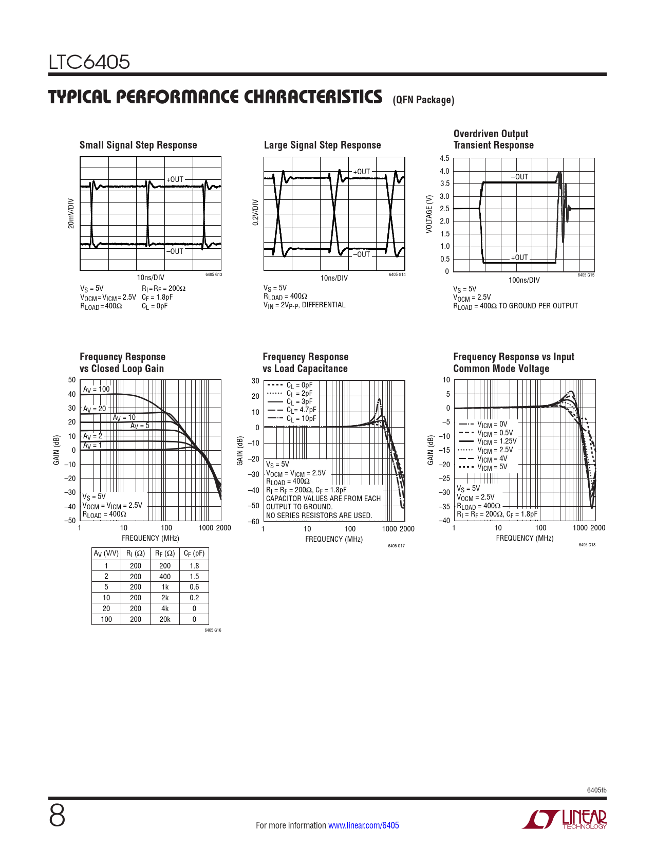

typical perForMance characteristics (QFN Package). Overdriven Output. Small Signal Step Response. Large Signal Step Response
typical perForMance characteristics (QFN Package) Overdriven Output Small Signal Step Response Large Signal Step Response
LTC6405
typical perForMance characteristics (QFN Package) Overdriven Output Small Signal Step Response Large Signal Step Response Transient Response
4.5 +OUT 4.0 +OUT –OUT 3.5 V) 3.0 /DIV /DIV 2.5 TAGE ( 2.0 20mV 0.2V VOL 1.5 1.0 –OUT –OUT 0.5 +OUT 0 6405 G13 10ns/DIV 6405 G14 10ns/DIV 6405 G15 100ns/DIV VS = 5V RI = RF = 200Ω VS = 5V VS = 5V VOCM = VICM = 2.5V CF = 1.8pF RLOAD = 400Ω VOCM = 2.5V RLOAD = 400Ω CL = 0pF VIN = 2VP-P, DIFFERENTIAL RLOAD = 400Ω TO GROUND PER OUTPUT
Frequency Response Frequency Response Frequency Response vs Input vs Closed Loop Gain vs Load Capacitance Common Mode Voltage
50 30 10 A CL = 0pF V = 100 40 20 CL = 2pF 5 CL = 3pF 30 AV = 20 10 CL= 4.7pF 0 AV = 10 20 CL = 10pF A –5 V = 5 0 VICM = 0V 10 A V V = 2 –10 ICM = 0.5V A V V = 1 –10 ICM = 1.25V 0 –15 VICM = 2.5V GAIN (dB) –20 V –10 GAIN (dB) V ICM = 4V S = 5V GAIN (dB) –20 V V ICM = 5V –20 –30 OCM = VICM = 2.5V R –25 LOAD = 400Ω –30 –40 RI = RF = 200Ω, CF = 1.8pF VS = 5V V –30 S = 5V CAPACITOR VALUES ARE FROM EACH VOCM = 2.5V –40 VOCM = VICM = 2.5V –50 OUTPUT TO GROUND. –35 RLOAD = 400Ω RLOAD = 400Ω NO SERIES RESISTORS ARE USED. RI = RF = 200Ω, CF = 1.8pF –50 –60 –40 1 10 100 1000 2000 1 10 100 1000 2000 1 10 100 1000 2000 FREQUENCY (MHz) FREQUENCY (MHz) FREQUENCY (MHz) 6405 G17 6405 G18 AV (V/V) RI (Ω) RF (Ω) CF (pF) 1 200 200 1.8 2 200 400 1.5 5 200 1k 0.6 10 200 2k 0.2 20 200 4k 0 100 200 20k 0 6405 G16 6405fb 8 For more information www.linear.com/6405
