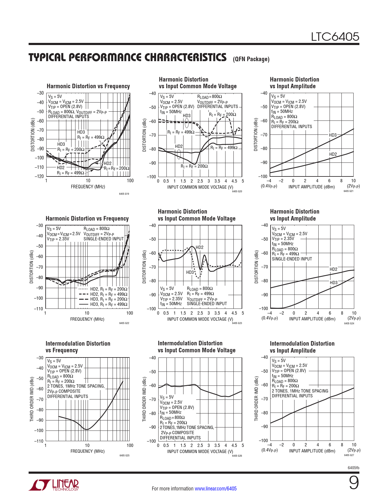

typical perForMance characteristics (QFN Package). Harmonic Distortion. Harmonic Distortion vs Frequency
LTC6405
typical perForMance characteristics (QFN Package) Harmonic Distortion Harmonic Distortion Harmonic Distortion vs Frequency vs Input Common Mode Voltage vs Input Amplitude
–30 –40 –40 VS = 5V VS = 5V RLOAD = 800Ω VS = 5V –40 VOCM = VICM = 2.5V VOCM = 2.5V VOUTDIFF = 2VP-P VOCM = VICM = 2.5V VTIP = OPEN (2.8V) –50 VTIP = OPEN (2.8V) DIFFERENTIAL INPUTS –50 VTIP = OPEN (2.8V) –50 RLOAD = 800Ω, VOUTDIFF = 2VP-P fIN = 50MHz fIN = 50MHz DIFFERENTIAL INPUTS HD3 RI = RF = 200Ω RLOAD = 800Ω –60 –60 –60 RI = RF = 200Ω DIFFERENTIAL INPUTS –70 HD3 R TION (dBc) I = RF = 499Ω TION (dBc) –70 TION (dBc) –70 HD3 –80 RI = RF = 499Ω HD3 HD2 DISTOR –90 R R I = RF = 200Ω DISTOR –80 I = RF = 499Ω DISTOR –80 HD2 –100 HD2 –90 –90 –110 HD2 R R I = RF = 200Ω I = RF = 200Ω R –120 I = RF = 499Ω –100 –100 1 10 100 0 0.5 1 1.5 2 2.5 3 3.5 4 4.5 5 –4 –2 0 2 4 6 8 10 FREQUENCY (MHz) INPUT COMMON MODE VOLTAGE (V) (0.4VP-P) INPUT AMPLITUDE (dBm) (2VP-P) 6405 G20 6405 G21 6405 G19
–30 –40 –40 VS = 5V RLOAD = 800Ω VS = 5V VOCM = VICM = 2.5V VOUTDIFF = 2VP-P –40 VOCM = VICM = 2.5V VTIP = 2.35V SINGLE-ENDED INPUT –50 –50 VTIP = 2.35V –50 f HD2 IN = 50MHz RLOAD = 800Ω –60 –60 R –60 I = RF = 499Ω SINGLE-ENDED INPUT TION (dBc) –70 TION (dBc) –70 TION (dBc) –70 HD2 HD3 –80 DISTOR DISTOR –80 DISTOR –80 HD3 –90 HD2, R V I = RF = 200Ω S = 5V RLOAD = 800Ω HD2, R V I = RF = 499Ω –90 OCM = 2.5V RI = RF = 499Ω –90 –100 HD3, R V I = RF = 200Ω TIP = 2.35V VOUTDIFF = 2VP-P HD3, R f I = RF = 499Ω IN = 50MHz SINGLE-ENDED INPUT –110 –100 –100 1 10 100 0 0.5 1 1.5 2 2.5 3 3.5 4 4.5 5 –4 –2 0 2 4 6 8 10 FREQUENCY (MHz) INPUT COMMON MODE VOLTAGE (V) (0.4VP-P) INPUT AMPLITUDE (dBm) (2VP-P) 6405 G22 6405 G23 6405 G24
Intermodulation Distortion Intermodulation Distortion Intermodulation Distortion vs Frequency vs Input Common Mode Voltage vs Input Amplitude
–30 –40 –40 V V S = 5V S = 5V V V OCM = VICM = 2.5V OCM = VICM = 2.5V –40 VTIP = OPEN (2.8V) –50 –50 VTIP = OPEN (2.8V) R f LOAD = 800Ω IN = 50MHz –50 R R I = RF = 200Ω LOAD = 800Ω 2 TONES, 1MHz TONE SPACING, –60 –60 RI = RF = 200Ω –60 2V 2 TONES, 1MHz TONE SPACING P-P COMPOSITE DIFFERENTIAL INPUTS V DIFFERENTIAL INPUTS S = 5V –70 –70 –70 VOCM = 2.5V VTIP = OPEN (2.8V) –80 –80 fIN = 50MHz –80 R THIRD ORDER IMD (dBc) –90 THIRD ORDER IMD (dBc) LOAD = 800Ω THIRD ORDER IMD (dBc) RI = RF = 200Ω –90 2 TONES, 1MHz TONE SPACING, –90 –100 2VP-P COMPOSITE DIFFERENTIAL INPUTS –110 –100 –100 1 10 100 0 0.5 1 1.5 2 2.5 3 3.5 4 4.5 5 –4 –2 0 2 4 6 8 10 INPUT COMMON MODE VOLTAGE (V) (0.4VP-P) INPUT AMPLITUDE (dBm) (2VP-P) FREQUENCY (MHz) 6405 G25 6405 G26 6405 G27 6405fb For more information www.linear.com/6405 9
