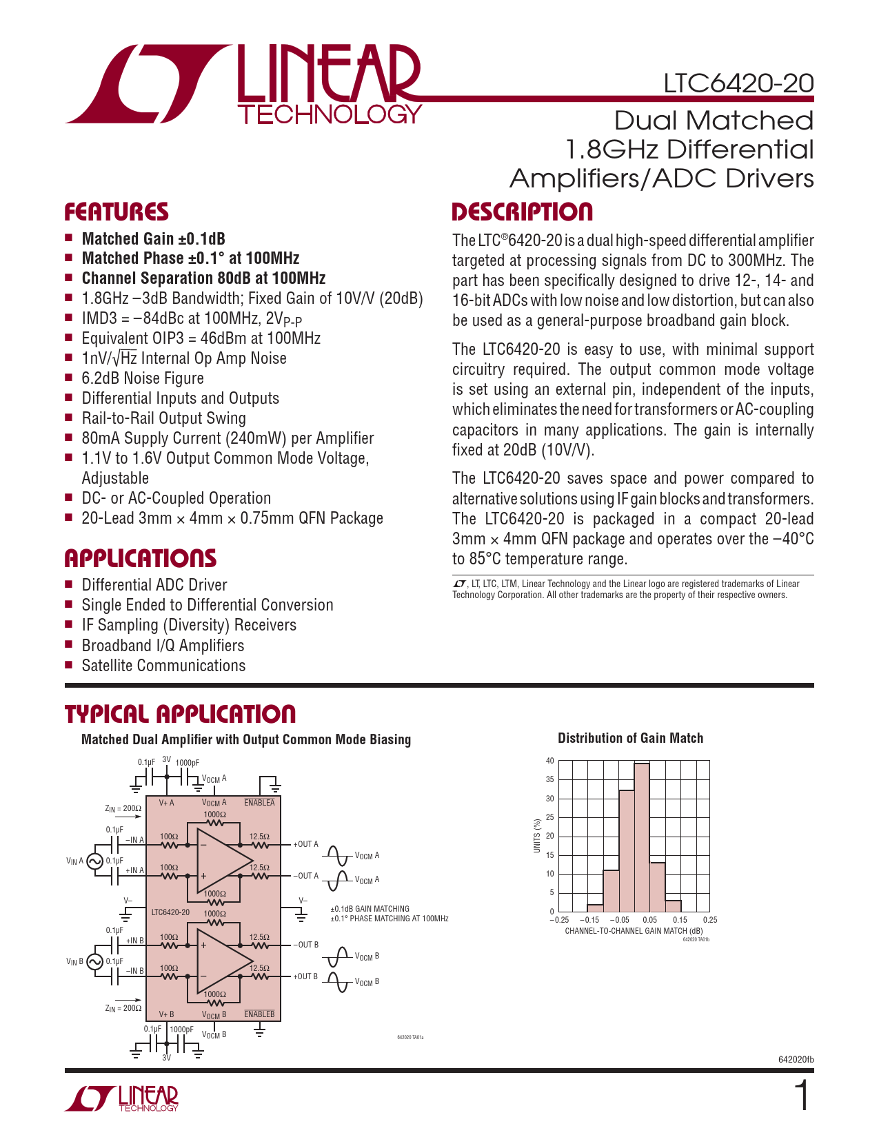

LTC6420-20 Dual Matched 1.8GHz Differential Amplifi ers/ADC Drivers
FEATURES DESCRIPTION
n
Matched Gain ±0.1dB
The LTC®6420-20 is a dual high-speed differential amplifi er n
Matched Phase ±0.1° at 100MHz
targeted at processing signals from DC to 300MHz. The n
Channel Separation 80dB at 100MHz
part has been specifi cally designed to drive 12-, 14- and n 1.8GHz –3dB Bandwidth; Fixed Gain of 10V/V (20dB) 16-bit ADCs with low noise and low distortion, but can also n IMD3 = –84dBc at 100MHz, 2VP-P be used as a general-purpose broadband gain block. n Equivalent OIP3 = 46dBm at 100MHz The LTC6420-20 is easy to use, with minimal support n 1nV/√Hz Internal Op Amp Noise circuitry required. The output common mode voltage n 6.2dB Noise Figure is set using an external pin, independent of the inputs, n Differential Inputs and Outputs which eliminates the need for transformers or AC-coupling n Rail-to-Rail Output Swing capacitors in many applications. The gain is internally n 80mA Supply Current (240mW) per Amplifi er fi xed at 20dB (10V/V). n 1.1V to 1.6V Output Common Mode Voltage, Adjustable The LTC6420-20 saves space and power compared to n DC- or AC-Coupled Operation alternative solutions using IF gain blocks and transformers. n 20-Lead 3mm × 4mm × 0.75mm QFN Package The LTC6420-20 is packaged in a compact 20-lead 3mm × 4mm QFN package and operates over the –40°C
APPLICATIONS
to 85°C temperature range. n Differential ADC Driver L, LT, LTC, LTM, Linear Technology and the Linear logo are registered trademarks of Linear Technology Corporation. All other trademarks are the property of their respective owners. n Single Ended to Differential Conversion n IF Sampling (Diversity) Receivers n Broadband I/Q Amplifi ers n Satellite Communications
TYPICAL APPLICATION Matched Dual Amplifi er with Output Common Mode Biasing Distribution of Gain Match
