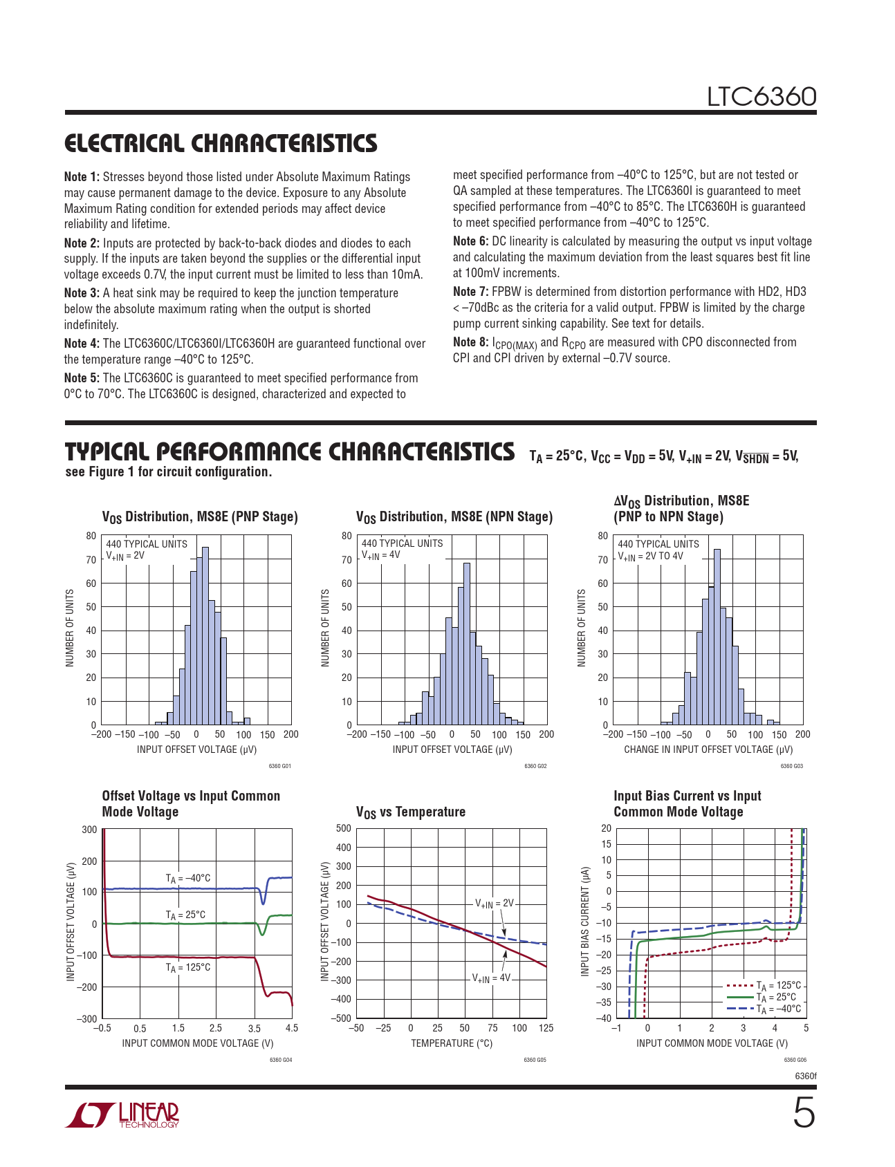

elecTrical characTerisTics Note 1:. Note 2:. Note 6:. Note 3:. Note 7:. Note 4:. Note 8:. Note 5:. Typical perForMance characTerisTics
elecTrical characTerisTics Note 1: Note 2: Note 6: Note 3: Note 7: Note 4: Note 8: Note 5: Typical perForMance characTerisTics
LTC6360
Stresses beyond those listed under Absolute Maximum Ratings meet specified performance from –40°C to 125°C, but are not tested or may cause permanent damage to the device. Exposure to any Absolute QA sampled at these temperatures. The LTC6360I is guaranteed to meet Maximum Rating condition for extended periods may affect device specified performance from –40°C to 85°C. The LTC6360H is guaranteed reliability and lifetime. to meet specified performance from –40°C to 125°C.
Note 2:
Inputs are protected by back-to-back diodes and diodes to each
Note 6:
DC linearity is calculated by measuring the output vs input voltage supply. If the inputs are taken beyond the supplies or the differential input and calculating the maximum deviation from the least squares best fit line voltage exceeds 0.7V, the input current must be limited to less than 10mA. at 100mV increments.
Note 3:
A heat sink may be required to keep the junction temperature
Note 7:
FPBW is determined from distortion performance with HD2, HD3 below the absolute maximum rating when the output is shorted < –70dBc as the criteria for a valid output. FPBW is limited by the charge indefinitely. pump current sinking capability. See text for details.
Note 4:
The LTC6360C/LTC6360I/LTC6360H are guaranteed functional over
Note 8:
ICPO(MAX) and RCPO are measured with CPO disconnected from the temperature range –40°C to 125°C. CPI and CPI driven by external –0.7V source.
Note 5:
The LTC6360C is guaranteed to meet specified performance from 0°C to 70°C. The LTC6360C is designed, characterized and expected to
Typical perForMance characTerisTics TA = 25°C, VCC = VDD = 5V, V+IN = 2V, VSHDN = 5V, see Figure 1 for circuit configuration. ∆VOS Distribution, MS8E VOS Distribution, MS8E (PNP Stage) VOS Distribution, MS8E (NPN Stage) (PNP to NPN Stage)
80 80 80 440 TYPICAL UNITS 440 TYPICAL UNITS 440 TYPICAL UNITS 70 V+IN = 2V 70 V+IN = 4V 70 V+IN = 2V TO 4V 60 60 60 50 50 50 40 40 40 30 30 30 NUMBER OF UNITS NUMBER OF UNITS NUMBER OF UNITS 20 20 20 10 10 10 0 0 0 –200 –150 –100 –50 0 50 100 150 200 –200 –150 –100 –50 0 50 100 150 200 –200 –150 –100 –50 0 50 100 150 200 INPUT OFFSET VOLTAGE (µV) INPUT OFFSET VOLTAGE (µV) CHANGE IN INPUT OFFSET VOLTAGE (µV) 6360 G01 6360 G02 6360 G03
Offset Voltage vs Input Common Input Bias Current vs Input Mode Voltage VOS vs Temperature Common Mode Voltage
300 500 20 400 15 200 10 300 TA = –40°C 5 200 100 0 100 V+IN = 2V –5 TA = 25°C 0 0 –10 –100 –15 –100 –20 T –200 A = 125°C –25 INPUT OFFSET VOLTAGE (µV) INPUT OFFSET VOLTAGE (µV) INPUT BIAS CURRENT (µA) –300 V+IN = 4V –200 –30 TA = 125°C –400 –35 TA = 25°C TA = –40°C –300 –500 –40 –0.5 0.5 1.5 2.5 3.5 4.5 –50 –25 0 25 50 75 100 125 –1 0 1 2 3 4 5 INPUT COMMON MODE VOLTAGE (V) TEMPERATURE (°C) INPUT COMMON MODE VOLTAGE (V) 6360 G04 6360 G05 6360 G06 6360f 5 Document Outline Features Description Applications Typical Application Absolute Maximum Ratings Pin Configuration Order InFormation Electrical Characteristics Typical Performance Characteristics Pin Functions Block Diagram Test Circuit Operation Applications Information Package Description Typical Application Related Parts
