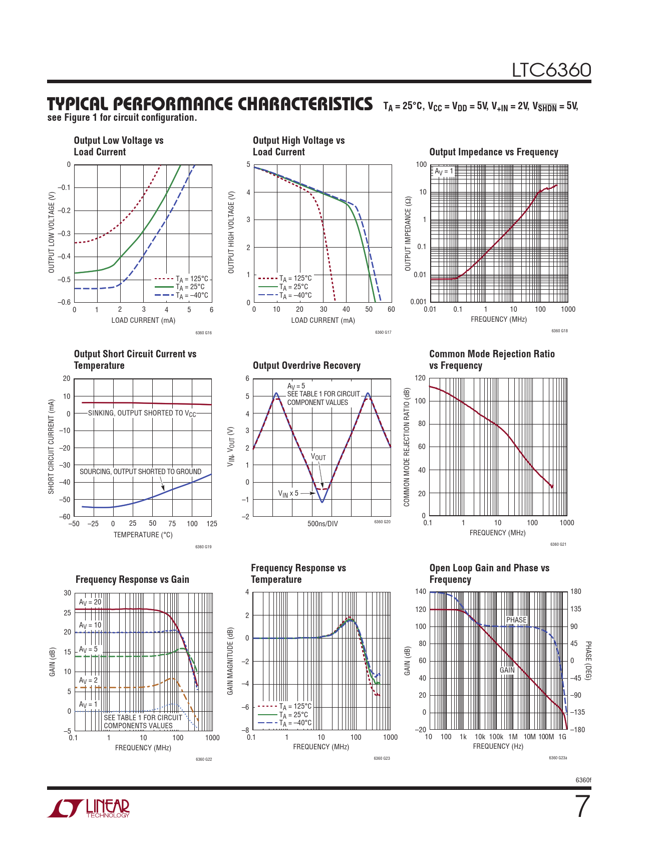

Typical perForMance characTerisTics. TA = 25°C, VCC = VDD = 5V, V+IN = 2V, VSHDN = 5V,
LTC6360
Typical perForMance characTerisTics TA = 25°C, VCC = VDD = 5V, V+IN = 2V, VSHDN = 5V, see Figure 1 for circuit configuration. Output Low Voltage vs Output High Voltage vs Load Current Load Current Output Impedance vs Frequency
0 5 100 AV = 1 –0.1 4 10 –0.2 3 1 –0.3 2 0.1 –0.4 OUTPUT LOW VOLTAGE (V) OUTPUT HIGH VOLTAGE (V) OUTPUT IMPEDANCE (Ω) 1 –0.5 TA = 125°C T 0.01 A = 125°C TA = 25°C TA = 25°C TA = –40°C TA = –40°C –0.6 0 0.001 0 1 2 3 4 5 6 0 10 20 30 40 50 60 0.01 0.1 1 10 100 1000 LOAD CURRENT (mA) LOAD CURRENT (mA) FREQUENCY (MHz) 6360 G16 6360 G17 6360 G18
Output Short Circuit Current vs Common Mode Rejection Ratio Temperature Output Overdrive Recovery vs Frequency
20 6 120 AV = 5 10 5 SEE TABLE 1 FOR CIRCUIT COMPONENT VALUES 100 0 SINKING, OUTPUT SHORTED TO VCC 4 80 –10 (V) 3 –20 OUT 2 60 , V VOUT –30 V IN 1 SOURCING, OUTPUT SHORTED TO GROUND 40 –40 0 SHORT CIRCUIT CURRENT (mA) VIN x 5 20 –50 –1 COMMON MODE REJECTION RATIO (dB) –60 –2 0 –50 –25 0 25 50 75 100 125 500ns/DIV 6360 G20 0.1 1 10 100 1000 FREQUENCY (MHz) TEMPERATURE (°C) 6360 G21 6360 G19
Frequency Response vs Open Loop Gain and Phase vs Frequency Response vs Gain Temperature Frequency
30 4 140 180 AV = 20 25 120 135 2 PHASE AV = 10 100 90 20 0 PHASE (DEG) 80 45 15 AV = 5 –2 60 0 GAIN (dB) 10 GAIN (dB) GAIN A 40 –45 V = 2 –4 5 GAIN MAGNITUDE (dB) 20 –90 AV = 1 –6 TA = 125°C 0 T 0 –135 SEE TABLE 1 FOR CIRCUIT A = 25°C T COMPONENTS VALUES A = –40°C –5 –8 –20 –180 0.1 1 10 100 1000 0.1 1 10 100 1000 10 100 1k 10k 100k 1M 10M 100M 1G FREQUENCY (MHz) FREQUENCY (MHz) FREQUENCY (Hz) 6360 G22 6360 G23 6360 G23a 6360f 7 Document Outline Features Description Applications Typical Application Absolute Maximum Ratings Pin Configuration Order InFormation Electrical Characteristics Typical Performance Characteristics Pin Functions Block Diagram Test Circuit Operation Applications Information Package Description Typical Application Related Parts
