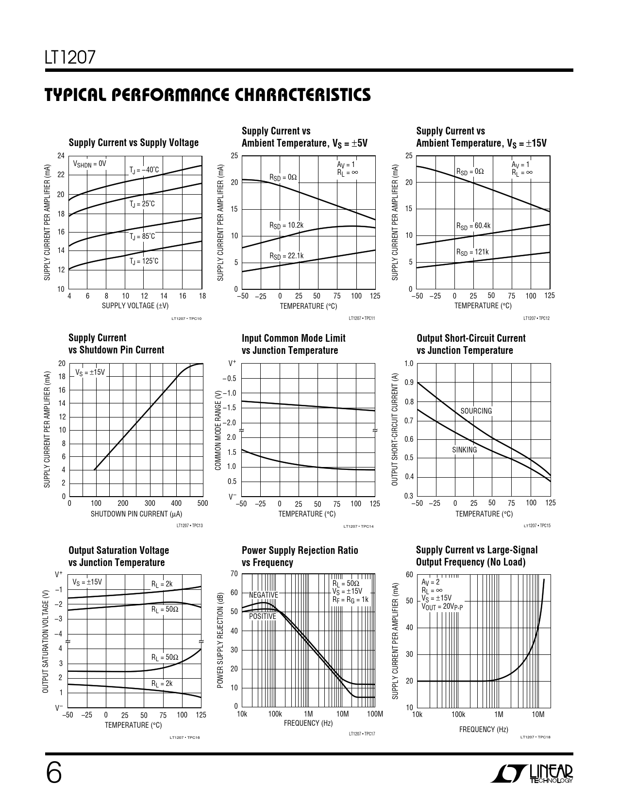

DescriptionDual 250mA/60MHz Current Feedback Amplifier

W U. TYPICAL PERFOR A CE CHARACTERISTICS. Supply Current vs. Supply Current vs Supply Voltage. Ambient Temperature, V. S =. 15V
W U TYPICAL PERFOR A CE CHARACTERISTICS Supply Current vs Supply Current vs Supply Voltage Ambient Temperature, V S = 15V
LT1207
W U TYPICAL PERFOR A CE CHARACTERISTICS Supply Current vs Supply Current vs Supply Current vs Supply Voltage Ambient Temperature, V Ambient Temperature, V S =
5V S =
15V
24 25 25 VSHDN = 0V AV = 1 AV = 1 T R 22 J = –40˚C RL = ∞ SD = 0Ω R R L = ∞ 20 SD = 0Ω 20 20 TJ = 25˚C 15 15 18 RSD = 10.2k RSD = 60.4k 16 TJ = 85˚C 10 10 14 R R SD = 121k SD = 22.1k TJ = 125˚C 5 5 12 SUPPLY CURRENT PER AMPLIFIER (mA) SUPPLY CURRENT PER AMPLIFIER (mA) SUPPLY CURRENT PER AMPLIFIER (mA) 10 0 0 4 6 8 10 12 14 16 18 –50 –25 0 25 50 75 100 125 –50 –25 0 25 50 75 100 125 SUPPLY VOLTAGE (±V) TEMPERATURE (°C) TEMPERATURE (°C) LT1207 • TPC10 LT1207 • TPC11 LT1207 • TPC12
Supply Current Input Common Mode Limit Output Short-Circuit Current vs Shutdown Pin Current vs Junction Temperature vs Junction Temperature
20 V+ 1.0 V 18 S = ±15V – 0.5 0.9 16 –1.0 14 0.8 –1.5 SOURCING 12 –2.0 0.7 10 2.0 0.6 8 1.5 SINKING 6 0.5 COMMON MODE RANGE (V) 1.0 4 0.4 0.5 SUPPLY CURRENT PER AMPLIFIER (mA) 2 OUTPUT SHORT-CIRCUIT CURRENT (A) 0 V– 0.3 0 100 200 300 400 500 –50 –25 0 25 50 75 100 125 –50 –25 0 25 50 75 100 125 SHUTDOWN PIN CURRENT (µA) TEMPERATURE (°C) TEMPERATURE (°C) LT1207 • TPC13 LT1207 • TPC14 LT1207 • TPC15
Output Saturation Voltage Power Supply Rejection Ratio Supply Current vs Large-Signal vs Junction Temperature vs Frequency Output Frequency (No Load)
V+ 70 60 VS = ±15V R A L = 2k RL = 50Ω V = 2 –1 60 V R S = ±15V NEGATIVE L = ∞ R 50 VS = ±15V –2 F = RG = 1k R V L = 50Ω OUT = 20VP-P 50 –3 POSITIVE 40 –4 40 4 30 R 30 L = 50Ω 3 20 2 R 20 L = 2k POWER SUPPLY REJECTION (dB) OUTPUT SATURATION VOLTAGE (V) 10 1 SUPPLY CURRENT PER AMPLIFIER (mA) V– 0 10 –50 –25 0 25 50 75 100 125 10k 100k 1M 10M 100M 10k 100k 1M 10M TEMPERATURE (°C) FREQUENCY (Hz) FREQUENCY (Hz) LT1207 • TPC17 LT1207 • TPC16 LT1207 • TPC18 6
