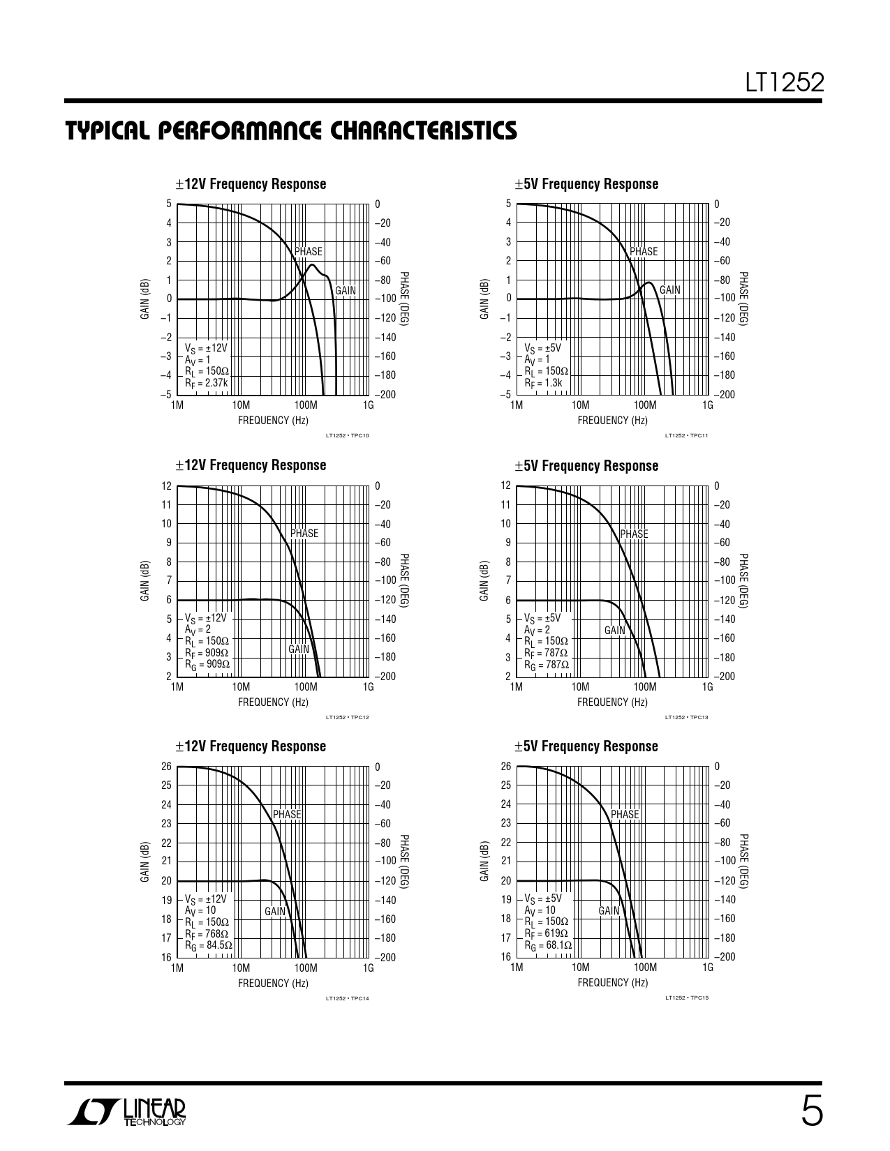

TYPICAL PERFOR A CE CHAR C. A TERISTICS. 12V Frequency Response. 5V Frequency Response
LT1252
W U TYPICAL PERFOR A CE CHAR C A TERISTICS
5 0 5 0 4 –20 4 –20 3 –40 3 –40 PHASE PHASE 2 –60 2 –60 PHASE (DEG) PHASE (DEG) 1 –80 1 –80 GAIN GAIN 0 –100 0 –100 GAIN (dB) –1 –120 GAIN (dB) –1 –120 –2 –140 –2 –140 VS = ±12V VS = ±5V –3 A –160 –3 –160 V = 1 AV = 1 –4 RL = 150Ω –180 –4 RL = 150Ω –180 RF = 2.37k RF = 1.3k –5 –200 –5 –200 1M 10M 100M 1G 1M 10M 100M 1G FREQUENCY (Hz) FREQUENCY (Hz) LT1252 • TPC10 LT1252 • TPC11 ±
12 0 12 0 11 –20 11 –20 10 –40 10 –40 PHASE PHASE 9 –60 9 –60 PHASE (DEG) PHASE (DEG) 8 –80 8 –80 7 –100 7 –100 GAIN (dB) 6 –120 GAIN (dB) 6 –120 5 VS = ±12V –140 5 VS = ±5V –140 AV = 2 AV = 2 GAIN 4 R –160 4 –160 L = 150Ω R GAIN L = 150Ω 3 RF = 909Ω –180 3 RF = 787Ω –180 RG = 909Ω RG = 787Ω 2 –200 2 –200 1M 10M 100M 1G 1M 10M 100M 1G FREQUENCY (Hz) FREQUENCY (Hz) LT1252 • TPC12 LT1252 • TPC13 ±
26 0 26 0 25 –20 25 –20 24 –40 24 –40 PHASE PHASE 23 –60 23 –60 PHASE (DEG) PHASE (DEG) 22 –80 22 –80 21 –100 21 –100 GAIN (dB) 20 –120 GAIN (dB) 20 –120 19 VS = ±12V –140 19 VS = ±5V –140 AV = 10 GAIN AV = 10 GAIN 18 R –160 18 –160 L = 150Ω RL = 150Ω R 17 RF = 768Ω –180 17 F = 619Ω –180 RG = 84.5Ω RG = 68.1Ω 16 –200 16 –200 1M 10M 100M 1G 1M 10M 100M 1G FREQUENCY (Hz) FREQUENCY (Hz) LT1252 • TPC14 LT1252 • TPC15 5
