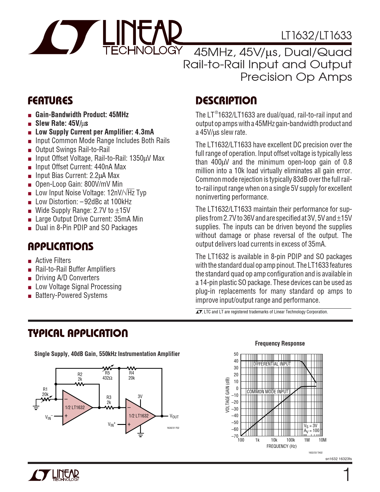

U TYPICAL APPLICATION Frequency Response Single Supply, 40dB Gain, 550kHz Instrumentation Amplifier
50 40 DIFFERENTIAL INPUT 30 R2 R5 R4 20 2k 432Ω 20k 10 0 R1 COMMON MODE INPUT 20k – –10 R3 3V 2k –20 – 1/2 LT1632 –30 VOLTAGE GAIN (dB) + – 1/2 LT1632 V –40 VIN OUT + + –50 VIN V 1630/31 F02 S = 3V –60 AV = 100 –70100 1k 10k 100k 1M 10M FREQUENCY (Hz) 1632/33 TA02 sn1632 16323fs 1
