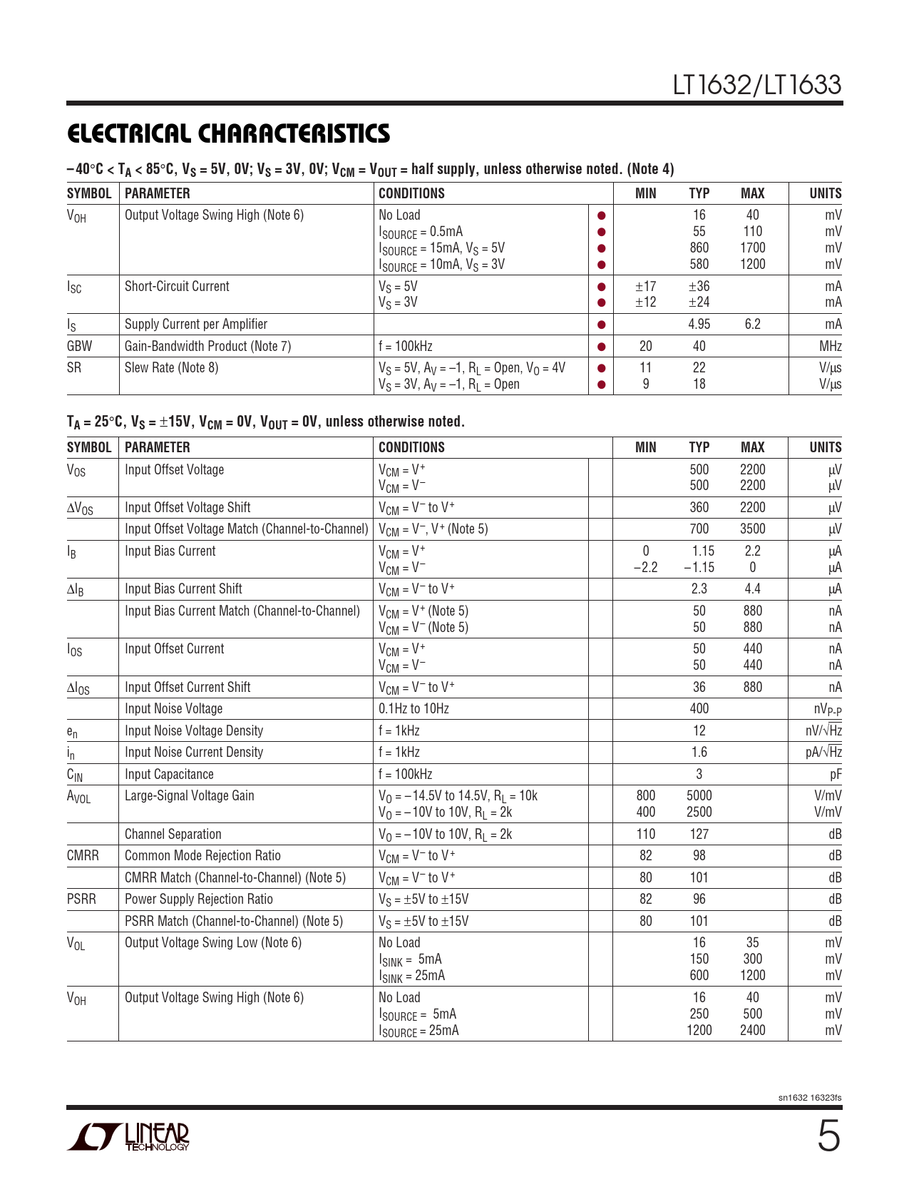

ELECTRICAL CHARACTERISTICS. – 40. C < TA < 85
LT1632/LT1633
ELECTRICAL CHARACTERISTICS – 40
C < TA < 85
C, VS = 5V, 0V; VS = 3V, 0V; VCM = VOUT = half supply, unless otherwise noted. (Note 4) SYMBOL PARAMETER CONDITIONS MIN TYP MAX UNITS
VOH Output Voltage Swing High (Note 6) No Load ● 16 40 mV ISOURCE = 0.5mA ● 55 110 mV ISOURCE = 15mA, VS = 5V ● 860 1700 mV ISOURCE = 10mA, VS = 3V ● 580 1200 mV ISC Short-Circuit Current VS = 5V ● ±17 ±36 mA VS = 3V ● ±12 ±24 mA IS Supply Current per Amplifier ● 4.95 6.2 mA GBW Gain-Bandwidth Product (Note 7) f = 100kHz ● 20 40 MHz SR Slew Rate (Note 8) VS = 5V, AV = –1, RL = Open, VO = 4V ● 11 22 V/µs VS = 3V, AV = –1, RL = Open ● 9 18 V/µs
TA = 25
C, VS =
15V, VCM = 0V, VOUT = 0V, unless otherwise noted. SYMBOL PARAMETER CONDITIONS MIN TYP MAX UNITS
VOS Input Offset Voltage VCM = V+ 500 2200 µV VCM = V– 500 2200 µV ∆VOS Input Offset Voltage Shift VCM = V– to V+ 360 2200 µV Input Offset Voltage Match (Channel-to-Channel) VCM = V–, V+ (Note 5) 700 3500 µV IB Input Bias Current VCM = V+ 0 1.15 2.2 µA VCM = V– – 2.2 – 1.15 0 µA ∆IB Input Bias Current Shift VCM = V– to V+ 2.3 4.4 µA Input Bias Current Match (Channel-to-Channel) VCM = V+ (Note 5) 50 880 nA VCM = V– (Note 5) 50 880 nA IOS Input Offset Current VCM = V+ 50 440 nA VCM = V– 50 440 nA ∆IOS Input Offset Current Shift VCM = V– to V+ 36 880 nA Input Noise Voltage 0.1Hz to 10Hz 400 nVP-P en Input Noise Voltage Density f = 1kHz 12 nV/√Hz in Input Noise Current Density f = 1kHz 1.6 pA/√Hz CIN Input Capacitance f = 100kHz 3 pF AVOL Large-Signal Voltage Gain VO = – 14.5V to 14.5V, RL = 10k 800 5000 V/mV VO = – 10V to 10V, RL = 2k 400 2500 V/mV Channel Separation VO = – 10V to 10V, RL = 2k 110 127 dB CMRR Common Mode Rejection Ratio VCM = V– to V + 82 98 dB CMRR Match (Channel-to-Channel) (Note 5) VCM = V– to V + 80 101 dB PSRR Power Supply Rejection Ratio VS = ±5V to ±15V 82 96 dB PSRR Match (Channel-to-Channel) (Note 5) VS = ±5V to ±15V 80 101 dB VOL Output Voltage Swing Low (Note 6) No Load 16 35 mV ISINK = 5mA 150 300 mV ISINK = 25mA 600 1200 mV VOH Output Voltage Swing High (Note 6) No Load 16 40 mV ISOURCE = 5mA 250 500 mV ISOURCE = 25mA 1200 2400 mV sn1632 16323fs 5
