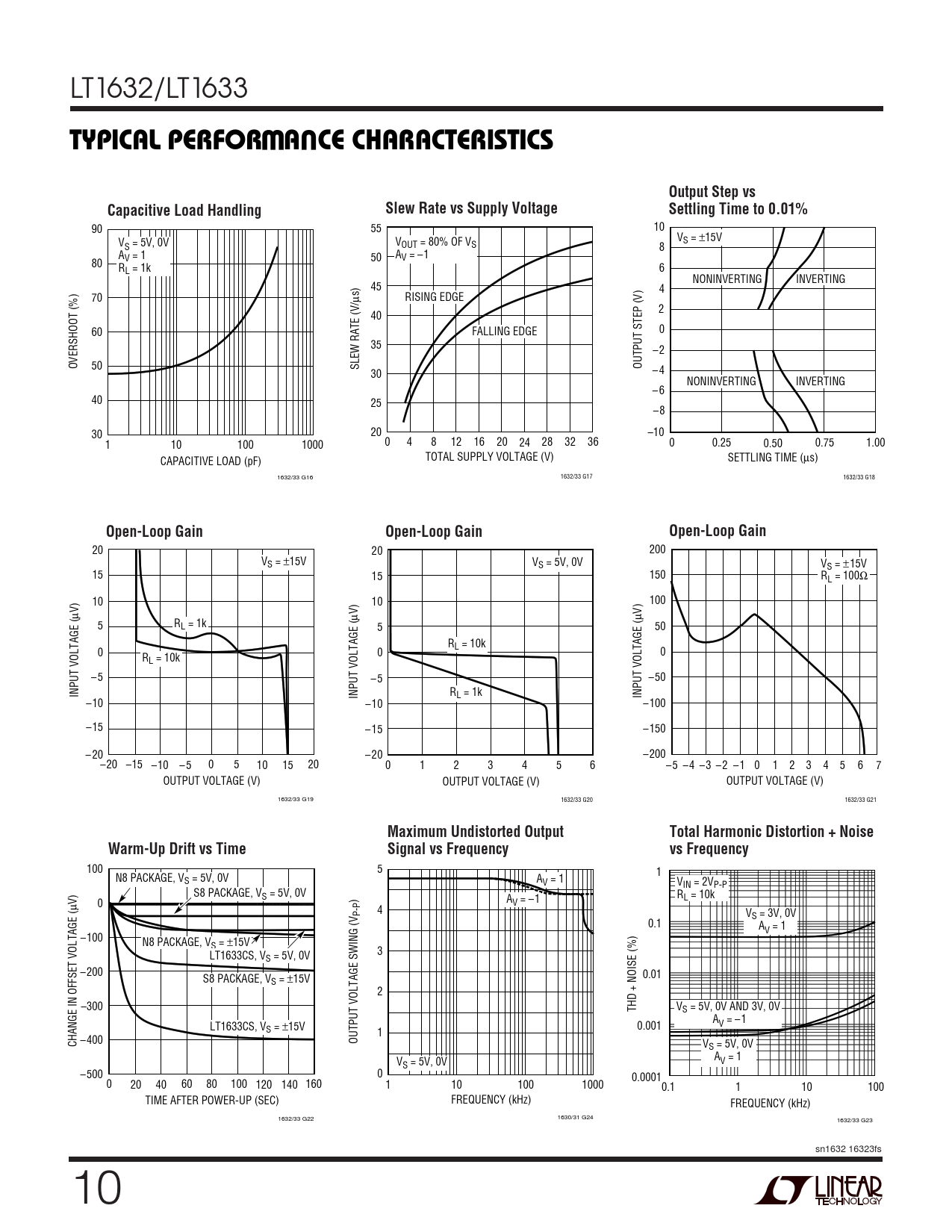

TYPICAL PERFORMANCE CHARACTERISTICS. Output Step vs. Capacitive Load Handling. Slew Rate vs Supply Voltage
LT1632/LT1633
W U TYPICAL PERFORMANCE CHARACTERISTICS Output Step vs Capacitive Load Handling Slew Rate vs Supply Voltage Settling Time to 0.01%
55 10 90 VS = ±15V V V S = 5V, 0V OUT = 80% OF VS 8 AV = 1 50 AV = –1 80 R 6 L = 1k NONINVERTING INVERTING 45 4 70 µs) RISING EDGE 2 40 0 60 FALLING EDGE 35 –2 OVERSHOOT (%) 50 SLEW RATE (V/ OUTPUT STEP (V) – 4 30 NONINVERTING INVERTING – 6 40 25 –8 20 –10 30 0 4 8 12 16 20 24 28 32 36 0 0.25 0.50 0.75 1.00 1 10 100 1000 TOTAL SUPPLY VOLTAGE (V) SETTLING TIME (µs) CAPACITIVE LOAD (pF) 1632/33 G16 1632/33 G17 1632/33 G18
Open-Loop Gain Open-Loop Gain Open-Loop Gain
20 20 200 VS = ±15V VS = 5V, 0V VS = ±15V 15 15 150 RL = 100Ω 10 10 100 µV) µV) µV) 5 RL = 1k 5 50 RL = 10k 0 0 0 RL = 10k – 5 – 5 –50 INPUT VOLTAGE ( INPUT VOLTAGE ( RL = 1k INPUT VOLTAGE ( –10 –10 –100 –15 – 15 –150 – 20 – 20 –200 –20 –15 –10 – 5 0 5 10 15 20 0 1 2 3 4 5 6 –5 –4 –3 –2 –1 0 1 2 3 4 5 6 7 OUTPUT VOLTAGE (V) OUTPUT VOLTAGE (V) OUTPUT VOLTAGE (V) 1632/33 G19 1632/33 G20 1632/33 G21
Maximum Undistorted Output Total Harmonic Distortion + Noise Warm-Up Drift vs Time Signal vs Frequency vs Frequency
100 5 1 N8 PACKAGE, VS = 5V, 0V AV = 1 VIN = 2VP-P S8 PACKAGE, VS = 5V, 0V RL = 10k ) µV) 0 AV = –1 P-P 4 VS = 3V, 0V 0.1 AV = 1 –100 N8 PACKAGE, VS = ±15V LT1633CS, V 3 S = 5V, 0V –200 S8 PACKAGE, V 0.01 S = ±15V 2 –300 THD + NOISE (%) VS = 5V, 0V AND 3V, 0V A LT1633CS, V V = –1 S = ±15V 0.001 1 CHANGE IN OFFSET VOLTAGE ( –400 OUTPUT VOLTAGE SWING (V VS = 5V, 0V A V V = 1 S = 5V, 0V –500 0 0.0001 0 20 40 60 80 100 120 140 160 1 10 100 1000 0.1 1 10 100 TIME AFTER POWER-UP (SEC) FREQUENCY (kHz) FREQUENCY (kHz) 1632/33 G22 1630/31 G24 1632/33 G23 sn1632 16323fs 10
