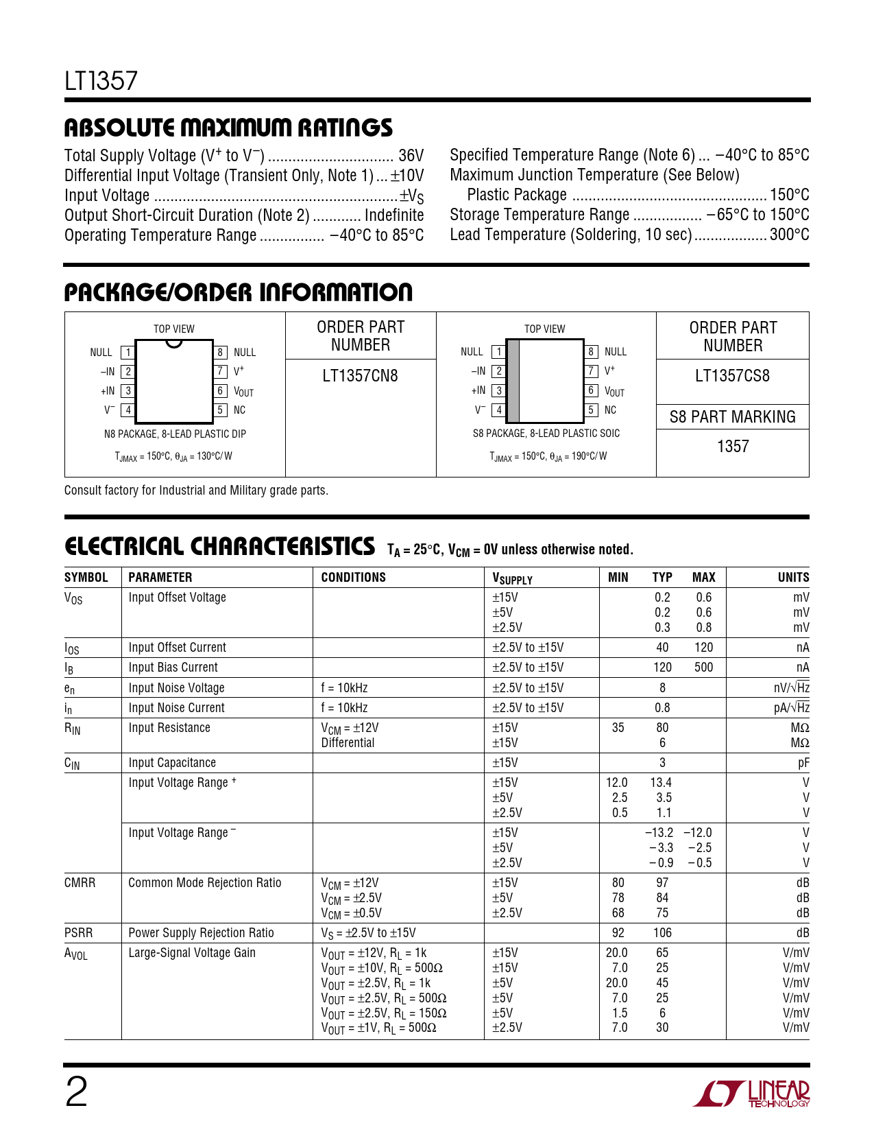

ABSOLUTE MAXIMUM RATINGS. PACKAGE/ORDER INFORMATION. ELECTRICAL CHARACTERISTICS TA = 25. C, VCM = 0V unless otherwise noted
LT1357
W W W U ABSOLUTE MAXIMUM RATINGS
Total Supply Voltage (V+ to V–) ... 36V Specified Temperature Range (Note 6) ... –40°C to 85°C Differential Input Voltage (Transient Only, Note 1) ... ±10V Maximum Junction Temperature (See Below) Input Voltage .. ±VS Plastic Package .. 150°C Output Short-Circuit Duration (Note 2) .. Indefinite Storage Temperature Range ... – 65°C to 150°C Operating Temperature Range .. –40°C to 85°C Lead Temperature (Soldering, 10 sec).. 300°C
U W U PACKAGE/ORDER INFORMATION
TOP VIEW ORDER PART TOP VIEW ORDER PART NUMBER NUMBER NULL 1 8 NULL NULL 1 8 NULL –IN 2 7 V+ –IN 2 7 V+ LT1357CN8 LT1357CS8 +IN 3 6 VOUT +IN 3 6 VOUT V– 4 5 NC V– 4 5 NC S8 PART MARKING N8 PACKAGE, 8-LEAD PLASTIC DIP S8 PACKAGE, 8-LEAD PLASTIC SOIC 1357 TJMAX = 150°C, θJA = 130°C/ W TJMAX = 150°C, θJA = 190°C/ W Consult factory for Industrial and Military grade parts.
C, VCM = 0V unless otherwise noted. SYMBOL PARAMETER CONDITIONS VSUPPLY MIN TYP MAX UNITS
VOS Input Offset Voltage ±15V 0.2 0.6 mV ±5V 0.2 0.6 mV ±2.5V 0.3 0.8 mV IOS Input Offset Current ±2.5V to ±15V 40 120 nA IB Input Bias Current ±2.5V to ±15V 120 500 nA en Input Noise Voltage f = 10kHz ±2.5V to ±15V 8 nV/√Hz in Input Noise Current f = 10kHz ±2.5V to ±15V 0.8 pA/√Hz RIN Input Resistance VCM = ±12V ±15V 35 80 MΩ Differential ±15V 6 MΩ CIN Input Capacitance ±15V 3 pF Input Voltage Range + ±15V 12.0 13.4 V ±5V 2.5 3.5 V ±2.5V 0.5 1.1 V Input Voltage Range – ±15V –13.2 –12.0 V ±5V – 3.3 – 2.5 V ±2.5V – 0.9 – 0.5 V CMRR Common Mode Rejection Ratio VCM = ±12V ±15V 80 97 dB VCM = ±2.5V ±5V 78 84 dB VCM = ±0.5V ±2.5V 68 75 dB PSRR Power Supply Rejection Ratio VS = ±2.5V to ±15V 92 106 dB AVOL Large-Signal Voltage Gain VOUT = ±12V, RL = 1k ±15V 20.0 65 V/mV VOUT = ±10V, RL = 500Ω ±15V 7.0 25 V/mV VOUT = ±2.5V, RL = 1k ±5V 20.0 45 V/mV VOUT = ±2.5V, RL = 500Ω ±5V 7.0 25 V/mV VOUT = ±2.5V, RL = 150Ω ±5V 1.5 6 V/mV VOUT = ±1V, RL = 500Ω ±2.5V 7.0 30 V/mV 2
