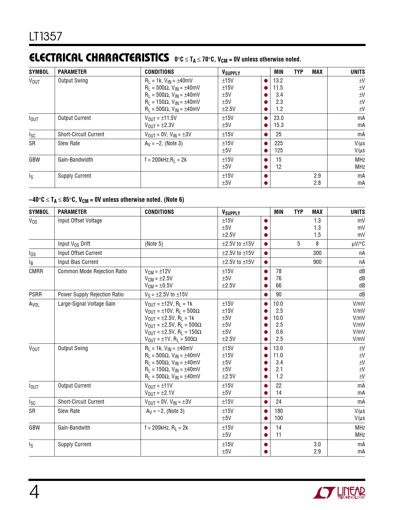

ELECTRICAL CHARACTERISTICS 0. C, VCM = 0V unless otherwise noted. SYMBOL. PARAMETER. CONDITIONS. VSUPPLY. MIN. TYP. MAX. UNITS. –40
ELECTRICAL CHARACTERISTICS 0 C, VCM = 0V unless otherwise noted SYMBOL PARAMETER CONDITIONS VSUPPLY MIN TYP MAX UNITS –40
LT1357
C
TA
70
C, VCM = 0V unless otherwise noted. SYMBOL PARAMETER CONDITIONS VSUPPLY MIN TYP MAX UNITS
VOUT Output Swing RL = 1k, VIN = ±40mV ±15V ● 13.2 ±V RL = 500Ω, VIN = ±40mV ±15V ● 11.5 ±V RL = 500Ω, VIN = ±40mV ±5V ● 3.4 ±V RL = 150Ω, VIN = ±40mV ±5V ● 2.3 ±V RL = 500Ω, VIN = ±40mV ±2.5V ● 1.2 ±V IOUT Output Current VOUT = ±11.5V ±15V ● 23.0 mA VOUT = ±2.3V ±5V ● 15.3 mA ISC Short-Circuit Current VOUT = 0V, VIN = ±3V ±15V ● 25 mA SR Slew Rate AV = –2, (Note 3) ±15V ● 225 V/µs ±5V ● 125 V/µs GBW Gain-Bandwidth f = 200kHz,RL = 2k ±15V ● 15 MHz ±5V ● 12 MHz IS Supply Current ±15V ● 2.9 mA ±5V ● 2.8 mA
–40
C
TA
85
C, VCM = 0V unless otherwise noted. (Note 6) SYMBOL PARAMETER CONDITIONS VSUPPLY MIN TYP MAX UNITS
VOS Input Offset Voltage ±15V ● 1.3 mV ±5V ● 1.3 mV ±2.5V ● 1.5 mV Input VOS Drift (Note 5) ±2.5V to ±15V ● 5 8 µV/°C IOS Input Offset Current ±2.5V to ±15V ● 300 nA IB Input Bias Current ±2.5V to ±15V ● 900 nA CMRR Common Mode Rejection Ratio VCM = ±12V ±15V ● 78 dB VCM = ±2.5V ±5V ● 76 dB VCM = ±0.5V ±2.5V ● 66 dB PSRR Power Supply Rejection Ratio VS = ±2.5V to ±15V ● 90 dB AVOL Large-Signal Voltage Gain VOUT = ±12V, RL = 1k ±15V ● 10.0 V/mV VOUT = ±10V, RL = 500Ω ±15V ● 2.5 V/mV VOUT = ±2.5V, RL = 1k ±5V ● 10.0 V/mV VOUT = ±2.5V, RL = 500Ω ±5V ● 2.5 V/mV VOUT = ±2.5V, RL = 150Ω ±5V ● 0.6 V/mV VOUT = ±1V, RL = 500Ω ±2.5V ● 2.5 V/mV VOUT Output Swing RL = 1k, VIN = ±40mV ±15V ● 13.0 ±V RL = 500Ω, VIN = ±40mV ±15V ● 11.0 ±V RL = 500Ω, VIN = ±40mV ±5V ● 3.4 ±V RL = 150Ω, VIN = ±40mV ±5V ● 2.1 ±V RL = 500Ω, VIN = ±40mV ±2.5V ● 1.2 ±V IOUT Output Current VOUT = ±11V ±15V ● 22 mA VOUT = ±2.1V ±5V ● 14 mA ISC Short-Circuit Current VOUT = 0V, VIN = ±3V ±15V ● 24 mA SR Slew Rate AV = –2, (Note 3) ±15V ● 180 V/µs ±5V ● 100 V/µs GBW Gain-Bandwith f = 200kHz, RL = 2k ±15V ● 14 MHz ±5V ● 11 MHz IS Supply Current ±15V ● 3.0 mA ±5V ● 2.9 mA 4
