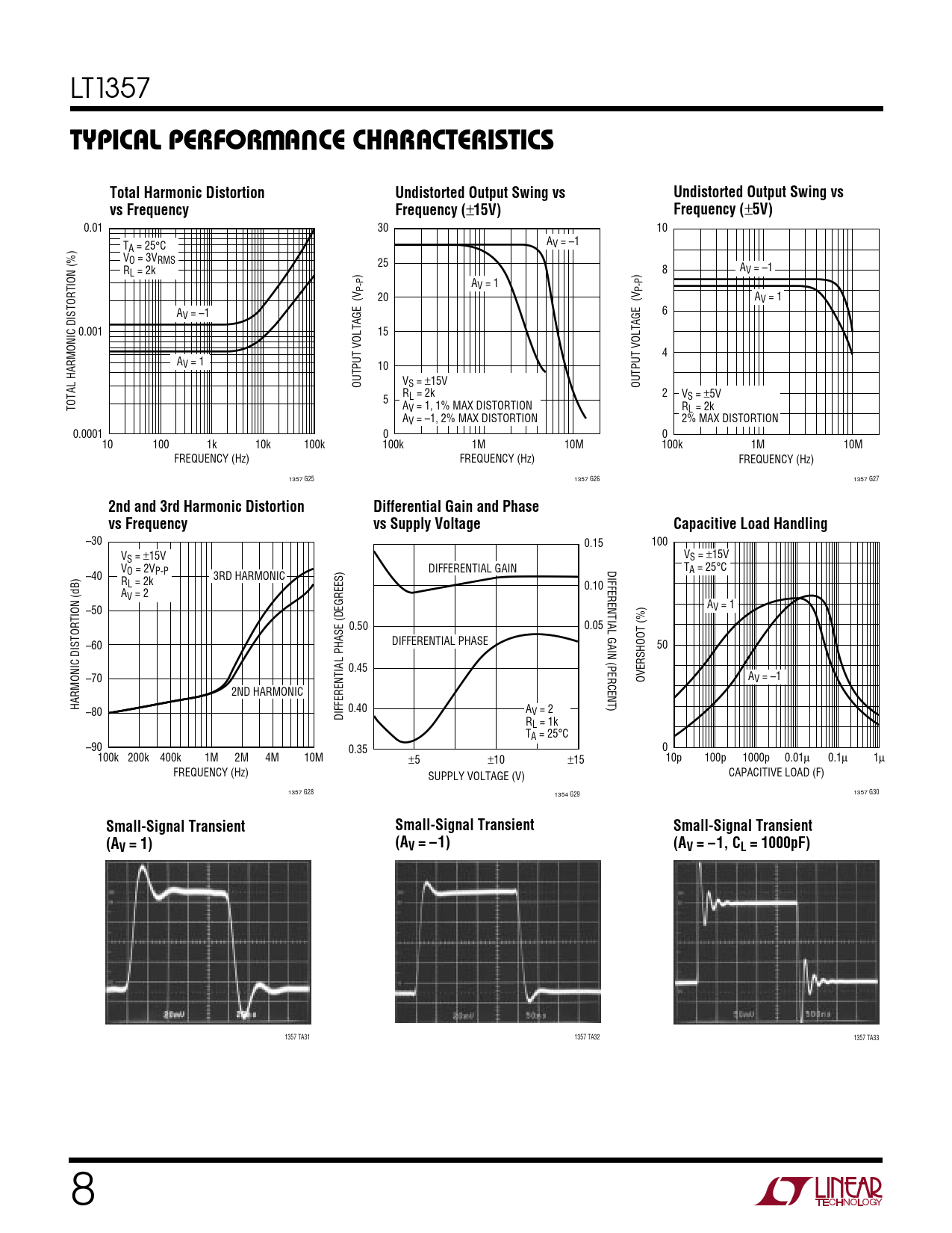

TYPICAL PERFORMANCE CHARACTERISTICS. Total Harmonic Distortion. Undistorted Output Swing vs. vs Frequency. Frequency (. 15V). 5V)
LT1357
W U TYPICAL PERFORMANCE CHARACTERISTICS Total Harmonic Distortion Undistorted Output Swing vs Undistorted Output Swing vs vs Frequency Frequency (
15V) Frequency (
5V)
0.01 30 10 AV = –1 TA = 25°C VO = 3VRMS 25 RL = 2k ) 8 AV = –1 A P-P V = 1 P-P 20 AV = 1 6 AV = –1 0.001 15 4 AV = 1 10 OUTPUT VOLTAGE (V VS = ±15V OUTPUT VOLTAGE (V R 2 V 5 L = 2k S = ±5V TOTAL HARMONIC DISTORTION (%) AV = 1, 1% MAX DISTORTION RL = 2k AV = –1, 2% MAX DISTORTION 2% MAX DISTORTION 0.0001 0 0 10 100 1k 10k 100k 100k 1M 10M 100k 1M 10M FREQUENCY (Hz) FREQUENCY (Hz) FREQUENCY (Hz) 1357 G25 1357 G26 1357 G27
2nd and 3rd Harmonic Distortion Differential Gain and Phase vs Frequency vs Supply Voltage Capacitive Load Handling
–30 0.15 100 V V S = ±15V S = ±15V V DIFFERENTIAL GAIN DIFFERENTIAL GAIN (PERCENT) T O = 2VP-P A = 25°C –40 3RD HARMONIC RL = 2k 0.10 AV = 2 AV = 1 –50 0.50 0.05 DIFFERENTIAL PHASE –60 50 0.45 –70 OVERSHOOT (%) AV = –1 2ND HARMONIC HARMONIC DISTORTION (dB) 0.40 A –80 DIFFERENTIAL PHASE (DEGREES) V = 2 RL = 1k TA = 25°C –90 0 0.35 100k 200k 400k 1M 2M 4M 10M 10p 100p 1000p 0.01 ±5 ±10 ±15 µ 0.1µ 1µ FREQUENCY (Hz) CAPACITIVE LOAD (F) SUPPLY VOLTAGE (V) 1357 G28 1357 G30 1354 G29
Small-Signal Transient Small-Signal Transient Small-Signal Transient (A (A V = 1) V = – 1) (AV = –1, CL = 1000pF)
1357 TA31 1357 TA32 1357 TA33 8
