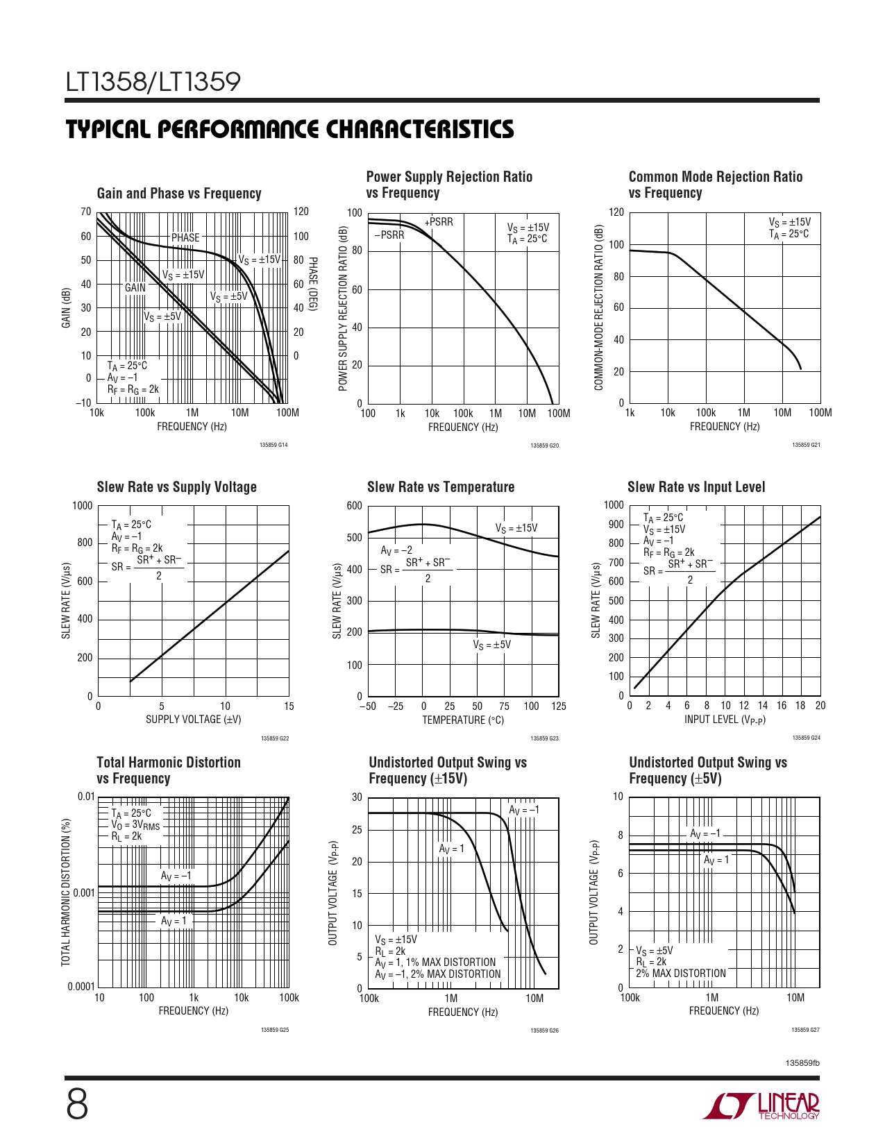

DescriptionDual and Quad 25MHz, 600V/µs Op Amps
Pages / Page16 / 8 — TYPICAL PERFOR A CE CHARACTERISTICS. Power Supply Rejection Ratio. Common …
File Format / SizePDF / 489 Kb
TYPICAL PERFOR A CE CHARACTERISTICS. Power Supply Rejection Ratio. Common Mode Rejection Ratio. Gain and Phase vs Frequency
TYPICAL PERFOR A CE CHARACTERISTICS Power Supply Rejection Ratio Common Mode Rejection Ratio Gain and Phase vs Frequency
LT1358/LT1359
W U TYPICAL PERFOR A CE CHARACTERISTICS Power Supply Rejection Ratio Common Mode Rejection Ratio Gain and Phase vs Frequency vs Frequency vs Frequency
70 120 100 120 +PSRR V V S = ±15V S = ±15V 60 PHASE 100 – PSRR T T A = 25°C A = 25°C 100 PHASE (DEG) 80 50 VS = ±15V 80 VS = ±15V 80 40 60 GAIN 60 VS = ±5V 30 40 60 VS = ±5V GAIN (dB) 20 20 40 40 10 0 TA = 25°C 20 20 0 AV = –1 R POWER SUPPLY REJECTION RATIO (dB) COMMON-MODE REJECTION RATIO (dB) F = RG = 2k –10 0 0 10k 100k 1M 10M 100M 100 1k 10k 100k 1M 10M 100M 1k 10k 100k 1M 10M 100M FREQUENCY (Hz) FREQUENCY (Hz) FREQUENCY (Hz) 135859 G14 135859 G20 135859 G21
Slew Rate vs Supply Voltage Slew Rate vs Temperature Slew Rate vs Input Level
1000 600 1000 T T A = 25°C A = 25°C V 900 S = ±15V V A S = ±15V 500 800 V = –1 A R 800 V = –1 F = RG = 2k AV = –2 RF = RG = 2k SR+ + SR– SR+ + SR– 700 SR+ + SR– µs) SR = ————— 400 SR = ————— SR = ————— 2 µs) µs) 600 2 600 2 300 500 400 400 SLEW RATE (V/ SLEW RATE (V/ 200 SLEW RATE (V/ 300 VS = ±5V 200 200 100 100 0 0 0 0 5 10 15 – 50 –25 0 25 50 75 100 125 0 2 4 6 8 10 12 14 16 18 20 SUPPLY VOLTAGE (±V) TEMPERATURE (°C) INPUT LEVEL (VP-P) 135859 G22 135859 G23 135859 G24
Total Harmonic Distortion Undistorted Output Swing vs Undistorted Output Swing vs vs Frequency Frequency (
15V) Frequency (
5V)
