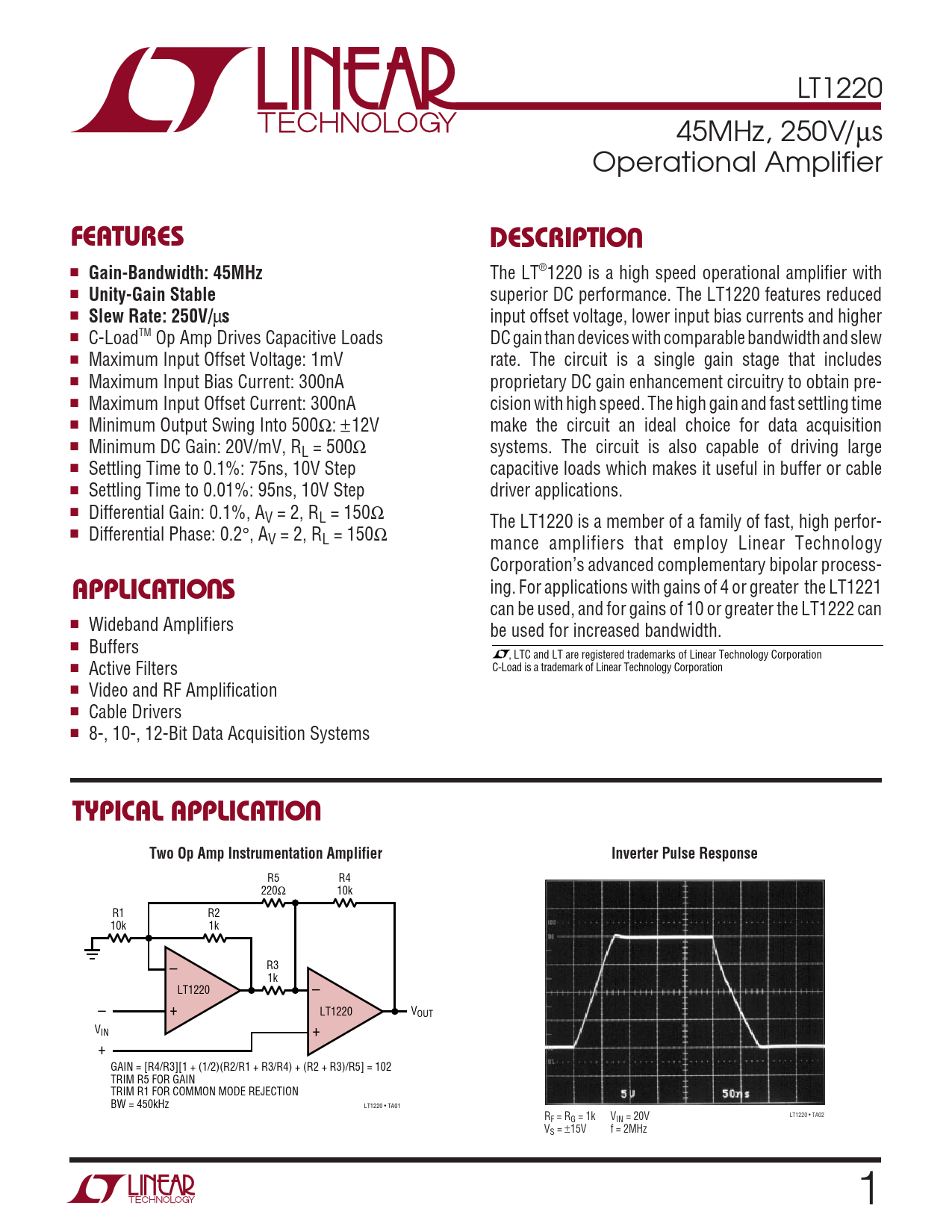

U TYPICAL APPLICATIO Two Op Amp Instrumentation Amplifier Inverter Pulse Response
R5 R4 220Ω 10k R1 R2 10k 1k – R3 1k – LT1220 + – LT1220 VOUT + VIN + GAIN = [R4/R3][1 + (1/2)(R2/R1 + R3/R4) + (R2 + R3)/R5] = 102 TRIM R5 FOR GAIN TRIM R1 FOR COMMON MODE REJECTION BW = 450kHz LT1220 • TA01 LT1220 • TA02 RF = RG = 1k VIN = 20V VS = ±15V f = 2MHz 1
