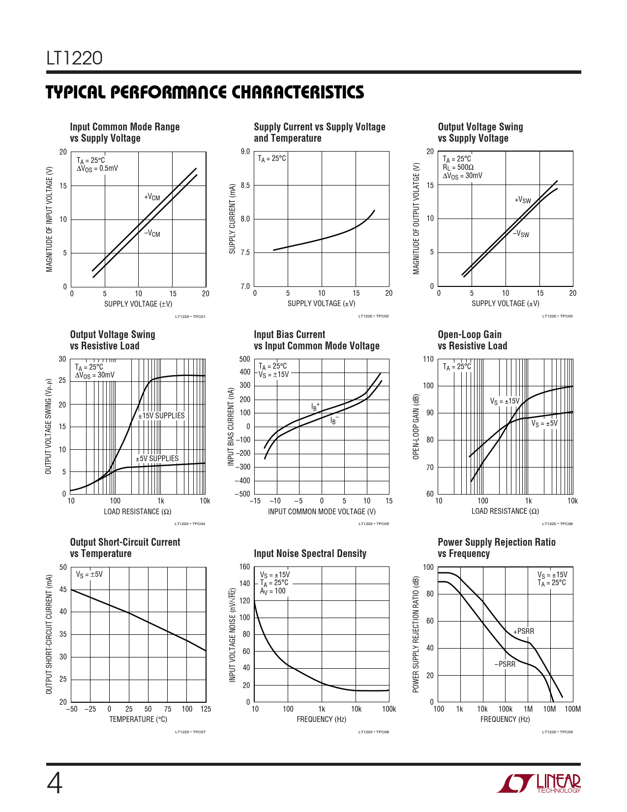

TYPICAL PERFORMANCE CHARACTERISTICS. Input Common Mode Range. Supply Current vs Supply Voltage. Output Voltage Swing
TYPICAL PERFORMANCE CHARACTERISTICS Input Common Mode Range Supply Current vs Supply Voltage Output Voltage Swing
LT1220
W U TYPICAL PERFORMANCE CHARACTERISTICS Input Common Mode Range Supply Current vs Supply Voltage Output Voltage Swing vs Supply Voltage and Temperature vs Supply Voltage
20 9.0 20 T TA = 25°C T A = 25°C A = 25°C ∆V R OS = 0.5mV L = 500Ω ∆VOS = 30mV 15 8.5 15 +VCM +VSW 10 8.0 10 –VCM –VSW 5 SUPPLY CURRENT (mA) 7.5 5 MAGNITUDE OF INPUT VOLTAGE (V) MAGNITUDE OF OUTPUT VOLATGE (V) 0 7.0 0 0 5 10 15 20 0 5 10 15 20 0 5 10 15 20 SUPPLY VOLTAGE (±V) SUPPLY VOLTAGE (±V) SUPPLY VOLTAGE (±V) LT1220 • TPC01 LT1220 • TPC02 LT1220 • TPC03
Output Voltage Swing Input Bias Current Open-Loop Gain vs Resistive Load vs Input Common Mode Voltage vs Resistive Load
30 500 110 TA = 25°C TA = 25°C TA = 25°C ∆V 400 V ) OS = 30mV S = ±15V 25 P-P 300 100 200 V 20 + S = ±15V IB ±15V SUPPLIES 100 90 I – B V 15 S = ±5V 0 –100 80 10 –200 ±5V SUPPLIES OPEN-LOOP GAIN (dB) INPUT BIAS CURRENT (nA) –300 70 OUTPUT VOLTAGE SWING (V 5 – 400 0 – 500 60 10 100 1k 10k –15 –10 – 5 0 5 10 15 10 100 1k 10k LOAD RESISTANCE (Ω) INPUT COMMON MODE VOLTAGE (V) LOAD RESISTANCE (Ω) LT1220 • TPC04 LT1220 • TPC05 LT1220 • TPC06
Output Short-Circuit Current Power Supply Rejection Ratio vs Temperature Input Noise Spectral Density vs Frequency
50 160 100 VS = ±5V VS = ±15V VS = ±15V 140 T T A = 25°C A = 25°C 45 AV = 100 80 √ 120 40 100 60 35 +PSRR 80 40 60 30 –PSRR 40 20 25 INPUT VOLTAGE NOISE (nV/ Hz) 20 OUTPUT SHORT-CIRCUIT CURRENT (mA) POWER SUPPLY REJECTION RATIO (dB) 20 0 0 –50 –25 0 25 50 75 100 125 10 100 1k 10k 100k 100 1k 10k 100k 1M 10M 100M TEMPERATURE (°C) FREQUENCY (Hz) FREQUENCY (Hz) LT1220 • TPC07 LT1220 • TPC08 LT1220 • TPC09 4
