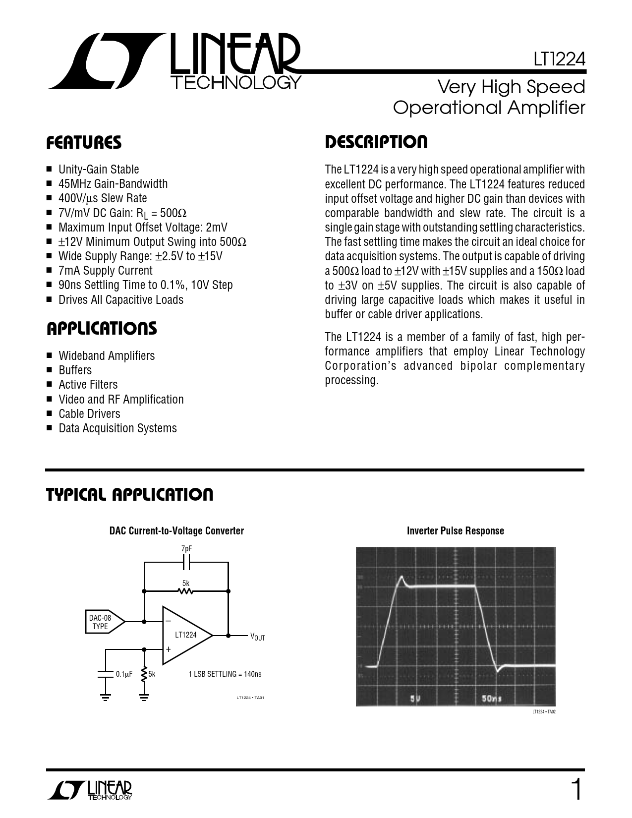

LT1224 Very High Speed Operational Amplifier
U FEATU S RE DESCRIPTIO
■ Unity-Gain Stable The LT1224 is a very high speed operational amplifier with ■ 45MHz Gain-Bandwidth excellent DC performance. The LT1224 features reduced ■ 400V/µs Slew Rate input offset voltage and higher DC gain than devices with ■ 7V/mV DC Gain: RL = 500Ω comparable bandwidth and slew rate. The circuit is a ■ Maximum Input Offset Voltage: 2mV single gain stage with outstanding settling characteristics. ■ ±12V Minimum Output Swing into 500Ω The fast settling time makes the circuit an ideal choice for ■ Wide Supply Range: ±2.5V to ±15V data acquisition systems. The output is capable of driving ■ 7mA Supply Current a 500Ω load to ±12V with ±15V supplies and a 150Ω load ■ 90ns Settling Time to 0.1%, 10V Step to ±3V on ±5V supplies. The circuit is also capable of ■ Drives All Capacitive Loads driving large capacitive loads which makes it useful in buffer or cable driver applications.
O U APPLICATI S
The LT1224 is a member of a family of fast, high per- ■ formance amplifiers that employ Linear Technology Wideband Amplifiers ■ Corporation’s advanced bipolar complementary Buffers ■ processing. Active Filters ■ Video and RF Amplification ■ Cable Drivers ■ Data Acquisition Systems
O U TYPICAL APPLICATI DAC Current-to-Voltage Converter Inverter Pulse Response
7pF 5k DAC-08 – TYPE LT1224 VOUT + 0.1µF 5k 1 LSB SETTLING = 140ns LT1224 • TA01 LT1224 • TA02 1
