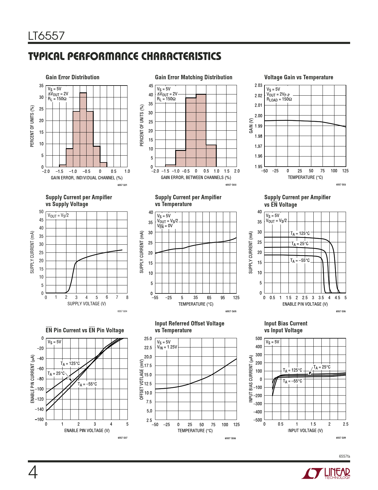

TYPICAL PERFORMANCE CHARACTERISTICS. Gain Error Distribution. Gain Error Matching Distribution. Voltage Gain vs Temperature
TYPICAL PERFORMANCE CHARACTERISTICS Gain Error Distribution Gain Error Matching Distribution Voltage Gain vs Temperature
LT6557
TYPICAL PERFORMANCE CHARACTERISTICS Gain Error Distribution Gain Error Matching Distribution Voltage Gain vs Temperature Supply Current per Ampifi er Supply Current per Ampifi er Supply Current per Ampifi er vs Supply Voltage vs Temperature vs EN Voltage
50 VOUT = VS/2 45 40 35 30 25 20 15 SUPPLY CURRENT (mA) 10 5 0 0 1 2 3 4 5 6 7 8 SUPPLY VOLTAGE (V) 6557 G04
Input Referred Offset Voltage Input Bias Current EN Pin Current vs EN Pin Voltage vs Temperature vs Input Voltage
