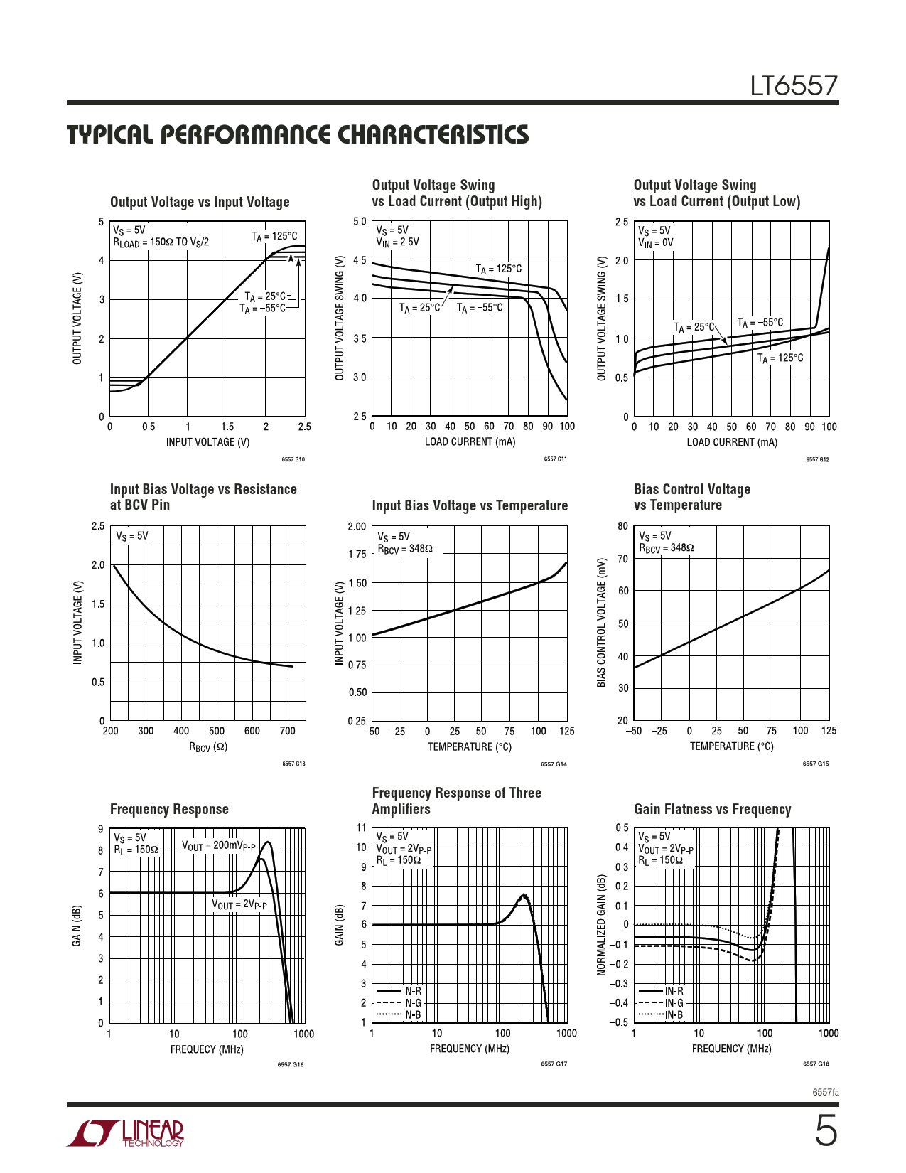

TYPICAL PERFORMANCE CHARACTERISTICS. Output Voltage Swing. Output Voltage vs Input Voltage. vs Load Current (Output High)
TYPICAL PERFORMANCE CHARACTERISTICS Output Voltage Swing Output Voltage vs Input Voltage vs Load Current (Output High)
LT6557
TYPICAL PERFORMANCE CHARACTERISTICS Output Voltage Swing Output Voltage Swing Output Voltage vs Input Voltage vs Load Current (Output High) vs Load Current (Output Low) Input Bias Voltage vs Resistance Bias Control Voltage at BCV Pin Input Bias Voltage vs Temperature vs Temperature Frequency Response of Three Frequency Response Amplifi ers Gain Flatness vs Frequency
