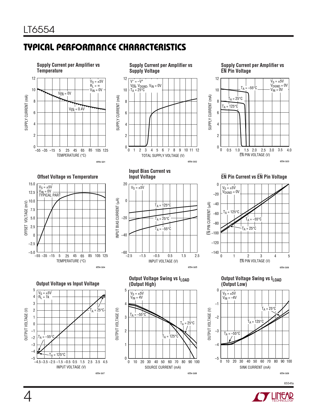

TYPICAL PERFOR A CE CHARACTERISTICS. Supply Current per Amplifier vs. Temperature. Supply Voltage. EN Pin Voltage
TYPICAL PERFOR A CE CHARACTERISTICS Supply Current per Amplifier vs Temperature Supply Voltage EN Pin Voltage
LT6554
W U TYPICAL PERFOR A CE CHARACTERISTICS Supply Current per Amplifier vs Supply Current per Amplifier vs Supply Current per Amplifier vs Temperature Supply Voltage EN Pin Voltage
12 12 12 VS = ±5V V– = –V+ VS = ±5V RL = ∞ V V EN, VDGND, VIN = 0V DGND = 0V T 10 V A = –55°C IN = 0V 10 TA = 25°C 10 VIN = 0V VEN = 0V TA = 25°C 8 8 8 TA = 125°C VEN = 0.4V 6 6 6 4 4 4 SUPPLY CURRENT (mA) SUPPLY CURRENT (mA) SUPPLY CURRENT (mA) 2 2 2 0 0 0 –55 –35 –15 5 25 45 65 85 105 125 0 1 2 3 4 5 6 7 8 9 10 11 12 0 0.5 1.0 1.5 2.0 2.5 3.0 3.5 4.0 TEMPERATURE (°C) TOTAL SUPPLY VOLTAGE (V) EN PIN VOLTAGE (V) 6554 G01 6554 G02 6554 G03
Input Bias Current vs Offset Voltage vs Temperature Input Voltage EN Pin Current vs EN Pin Voltage
15.0 20 0 VS = ±5V VS = ±5V VS = ±5V VIN = 0V V 12.5 –20 DGND = 0V TYPICAL PART A) 10.0 µ 0 T A) –40 A = 125°C µ 7.5 –60 TA = 125°C 5.0 –20 TA = 25°C TA = –55°C –80 2.5 TA = –55°C TA = 25°C EN PIN CURRENT ( –100 OFFSET VOLTAGE (mV) 0 INPUT BIAS CURRENT ( –40 –120 –2.5 –5.0 –60 –140 –55 –35 –15 5 25 45 65 85 105 125 –2.5 –1.5 –0.5 0.5 1.5 2.5 0 1 2 3 4 5 TEMPERATURE (°C) INPUT VOLTAGE (V) EN PIN VOLTAGE (V) 6554 G04 6554 G05 6554 G06
Output Voltage Swing vs ILOAD Output Voltage Swing vs ILOAD Output Voltage vs Input Voltage (Output High) (Output Low)
5 5 0 VS = ±5V VS = ±5V VS = ±5V 4 RL = 1k VIN = 4V VIN = –4V 3 4 –1 TA = 25°C 2 TA = 25°C TA = –55°C 1 3 –2 T TA = 125°C 0 A = 25°C –1 2 –3 TA = –55°C T T A = –55°C A = 125°C OUTPUT VOLTAGE (V) –2 OUTPUT VOLTAGE (V) OUTPUT VOLTAGE (V) –3 1 –4 –4 TA = 125°C –5 0 –5 –4.5 –3.5 –2.5 –1.5 –0.5 0.5 1.5 2.5 3.5 4.5 0 10 20 30 40 50 60 70 80 90 100 0 10 20 30 40 50 60 70 80 90 100 INPUT VOLTAGE (V) SOURCE CURRENT (mA) SINK CURRENT (mA) 6554 G07 6554 G08 6554 G09 6554fa 4
