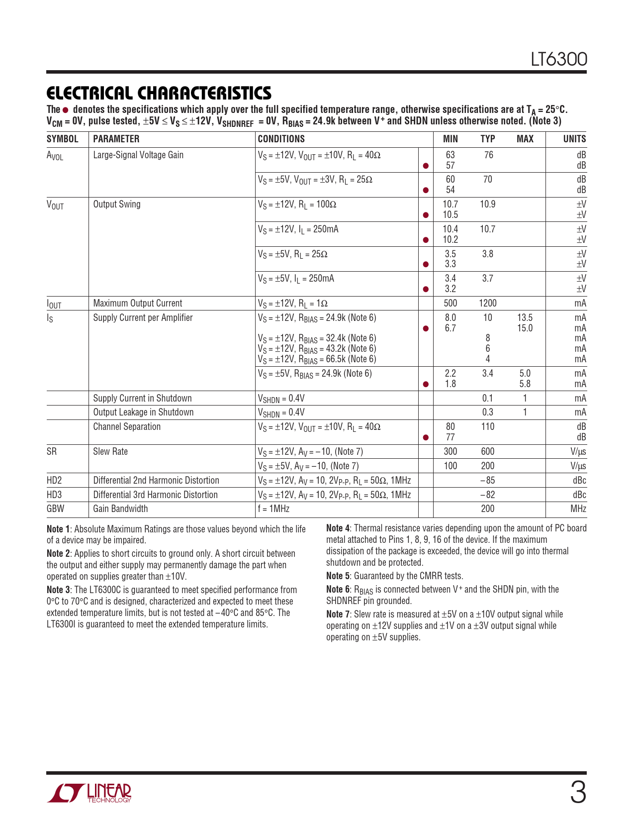

ELECTRICAL CHARACTERISTICS. The
LT6300
denotes the specifications which apply over the full specified temperature range, otherwise specifications are at TA = 25
C. VCM = 0V, pulse tested,
5V
VS
12V, VSHDNREF = 0V, RBIAS = 24.9k between V+ and SHDN unless otherwise noted. (Note 3) SYMBOL PARAMETER CONDITIONS MIN TYP MAX UNITS
AVOL Large-Signal Voltage Gain VS = ±12V, VOUT = ±10V, RL = 40Ω 63 76 dB ● 57 dB VS = ±5V, VOUT = ±3V, RL = 25Ω 60 70 dB ● 54 dB VOUT Output Swing VS = ±12V, RL = 100Ω 10.7 10.9 ±V ● 10.5 ±V VS = ±12V, IL = 250mA 10.4 10.7 ±V ● 10.2 ±V VS = ±5V, RL = 25Ω 3.5 3.8 ±V ● 3.3 ±V VS = ±5V, IL = 250mA 3.4 3.7 ±V ● 3.2 ±V IOUT Maximum Output Current VS = ±12V, RL = 1Ω 500 1200 mA IS Supply Current per Amplifier VS = ±12V, RBIAS = 24.9k (Note 6) 8.0 10 13.5 mA ● 6.7 15.0 mA VS = ±12V, RBIAS = 32.4k (Note 6) 8 mA VS = ±12V, RBIAS = 43.2k (Note 6) 6 mA VS = ±12V, RBIAS = 66.5k (Note 6) 4 mA VS = ±5V, RBIAS = 24.9k (Note 6) 2.2 3.4 5.0 mA ● 1.8 5.8 mA Supply Current in Shutdown VSHDN = 0.4V 0.1 1 mA Output Leakage in Shutdown VSHDN = 0.4V 0.3 1 mA Channel Separation VS = ±12V, VOUT = ±10V, RL = 40Ω 80 110 dB ● 77 dB SR Slew Rate VS = ±12V, AV = – 10, (Note 7) 300 600 V/µs VS = ±5V, AV = –10, (Note 7) 100 200 V/µs HD2 Differential 2nd Harmonic Distortion VS = ±12V, AV = 10, 2VP-P, RL = 50Ω, 1MHz – 85 dBc HD3 Differential 3rd Harmonic Distortion VS = ±12V, AV = 10, 2VP-P, RL = 50Ω, 1MHz – 82 dBc GBW Gain Bandwidth f = 1MHz 200 MHz
Note 1
: Absolute Maximum Ratings are those values beyond which the life
Note 4
: Thermal resistance varies depending upon the amount of PC board of a device may be impaired. metal attached to Pins 1, 8, 9, 16 of the device. If the maximum
Note 2
: Applies to short circuits to ground only. A short circuit between dissipation of the package is exceeded, the device will go into thermal the output and either supply may permanently damage the part when shutdown and be protected. operated on supplies greater than ±10V.
Note 5
: Guaranteed by the CMRR tests.
Note 3
: The LT6300C is guaranteed to meet specified performance from
Note 6
: RBIAS is connected between V + and the SHDN pin, with the 0°C to 70°C and is designed, characterized and expected to meet these SHDNREF pin grounded. extended temperature limits, but is not tested at – 40°C and 85°C. The
Note 7
: Slew rate is measured at ±5V on a ±10V output signal while LT6300I is guaranteed to meet the extended temperature limits. operating on ±12V supplies and ±1V on a ±3V output signal while operating on ±5V supplies. 3
